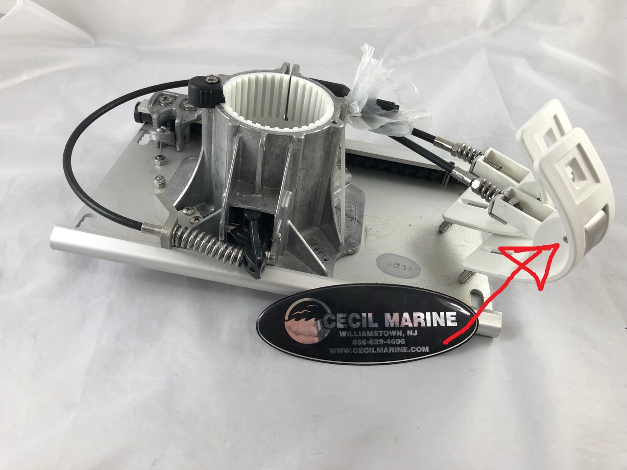

My swivel seat cable broke ('09 Chaparral 236 SSX at the handle (little T piece)
Can't find a replacement cable. Anyone have a workaround
I only need one cable, not a complete replacement for the chairstructure

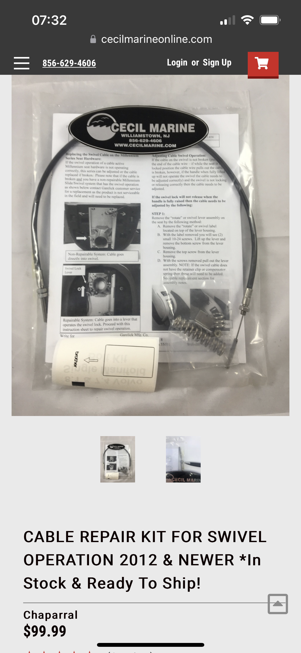

Is that the cable you need in the picture from Cecil's?

I only need the cable for the swivel operation.

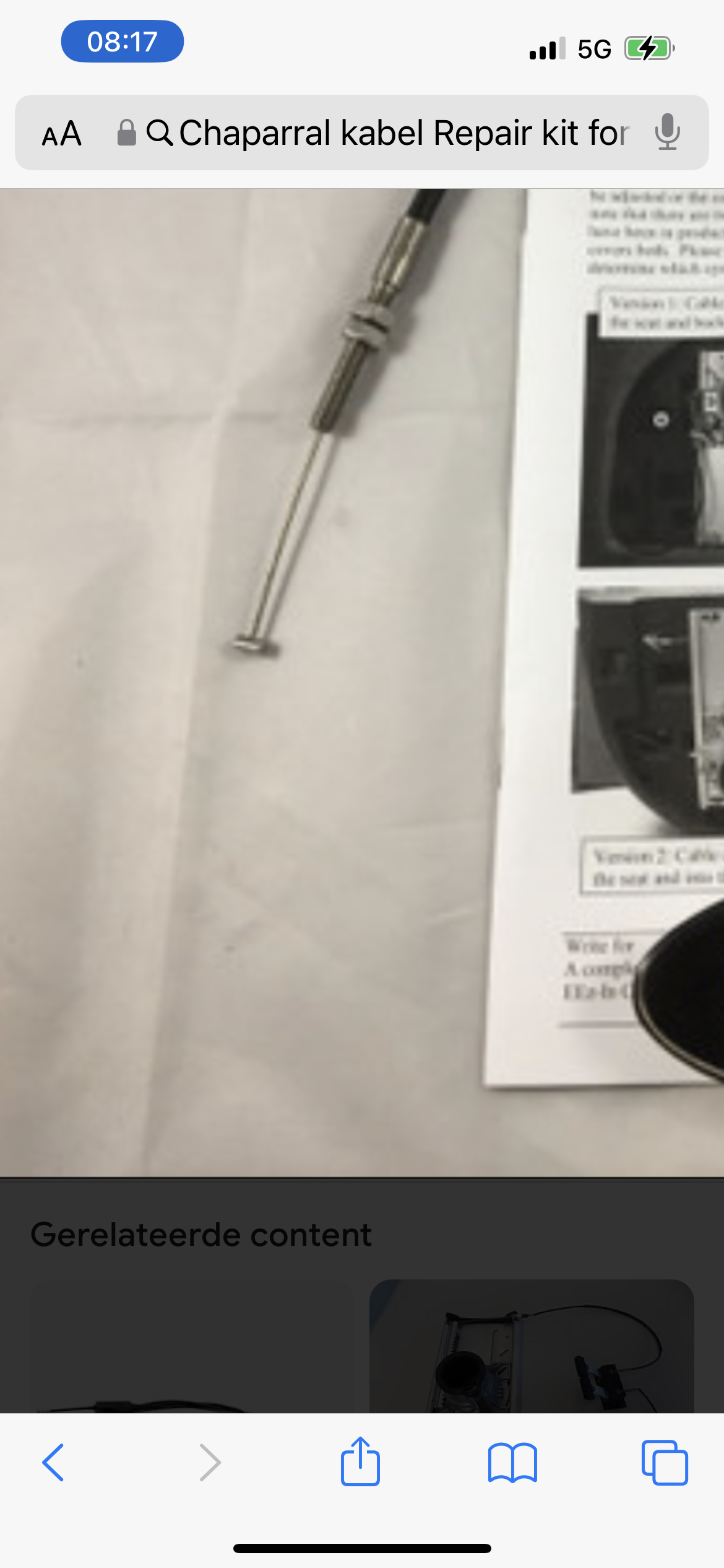

The little t bar feom the cable broke at the handle
Do you have a picture of the broken piece? A picture would really help.
Is the broken piece part of the cable, and is it serviced with the cable?
I have been looking at some different angels of the unit, and the photos look like the cable is all metal. Is it broken where the cable attaches to the plastic handle?
The cable looks like it is adjustable.

I love to tinker, I have more time than money, so my first choice is to repair it, if possible.
Judging from what I see in the photo, it looks like an easy fix, good luck.
