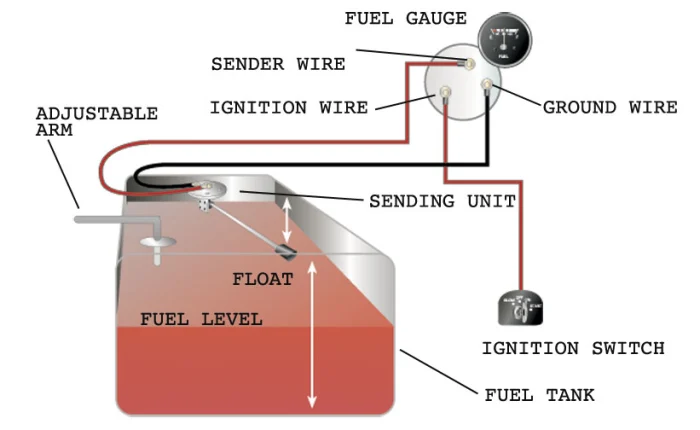

This is not yours, but this is how it works. There has to be an access hole over the tank to allow you to pull it out. Are there any wirers in the access hole that you can see into? Have you called Chap? Maybe Cecil Marine can help. You might try reaching out to Wlngnut.

Every gas tank that I have ever seen, both auto and marine, the sending unit is mounted on the top of the tank, so it can read the level, unless yours is mounted somewhere on the side, which does not seem practical.
Talked with a guy today that I have do business over the years, that owns a boat recycling yard, and does marine repairs.
He agreed that the sending unit goes somewhere on the top of the tank, and that not all boats have an access hole.
He said that he has already cut the hole in the deck to install the round inspection plate.
Also he said, sometimes there may be a board that is screwed down to the deck that can be removed to gain access.

Another way to do it, is start at the gauge and trace the wires backwards.
They more than likely run down the starboard side.

Found it!
Click on owners manual on right side
scroll down to1997 all chaparral boats on left side
scroll down to sport boats
then scroll down to page 3-8 SB
it is the wiring diagram for your girl
it will show the location of the sending and how it is wired
the only thing left is to physically pin point it, and to figure out what is needed to be done to access it
