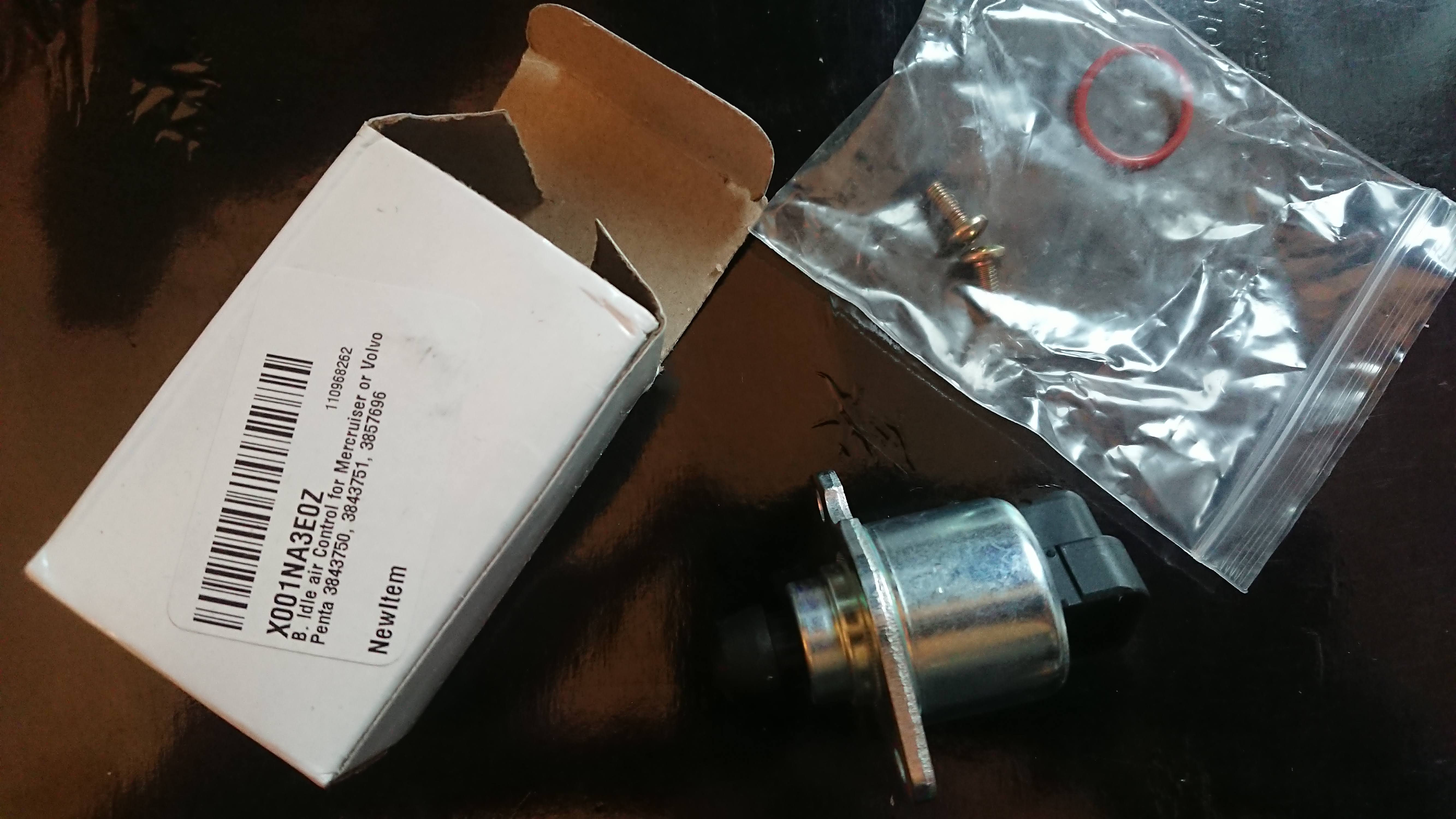

Decided to do a little research... I'm fairly confident I found the Volvo Penta part for my 5.0 GXi and it's about $280. I also found a Sierra equivalent for $70. Then I found a no-name brand on Amazon for $35! Crazy. I'll gamble for $35
A friend bought the Amazon one and fixed his boat two years ago. I had a different issue but we thought it might fix mine also. Seemed worth the gamble of a few bucks. Bought a two pack on Amazon for 47 bucks. did not fix my issue but I have a spare now if / when I need one. :D

I would say it also depends on the ease of replacement at sea. I got the $35 IAC valve and will try it, but I will most certainly keep the old one in the toolbox. I would not do the same 'gamble' with something like a raw water impeller. Though I would trust a known aftermarket brand like Sierra.

Thanks for the warning. Well, at a minimum, the $35 is probably the cheapest one can ever pay for a quick diagnosis. If it resolves my issue of stall coming off throttle, then I know that part was root cause. If not, look elsewhere. But I will think twice about leaving it in if it does solve the problem.

Finally a follow up. Works like a charm. Had it out about 15 times so far this season. I will say, the motor still dips down in idle as soon as I get in neutral after slowing down, but it doesn't stall like it used to.
