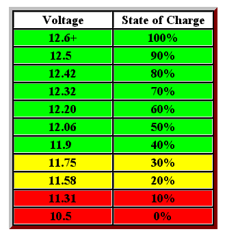

!st off, how old is your battery?
Do not charge your battery before going out, instead take a volt meter reading of the battery.
If good battery should be at least 12.4. When running what does your volt gauge read?

Forgive me!! A good battery should read around 13.4 to 13.6

Ummm, no. A sitting 12V will not be above 12.7V. If you are getting 13.4V then it is either running or plugged into shore power.
Yes! Your right for flooded, AGM and Gel. I was thinking of my own batteries. I have lithium for my house bank. Sorry about that......
My batteries are flooded, I went by what I have.
Growing up, all we had were flooded batteries.
I am not educated on the other types of batteries.
As you get older life tends to go on without you. :)
