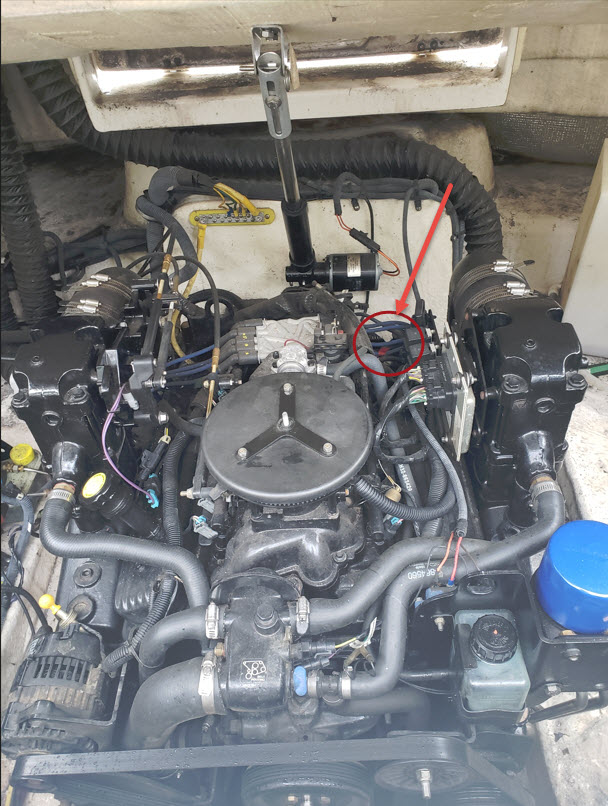

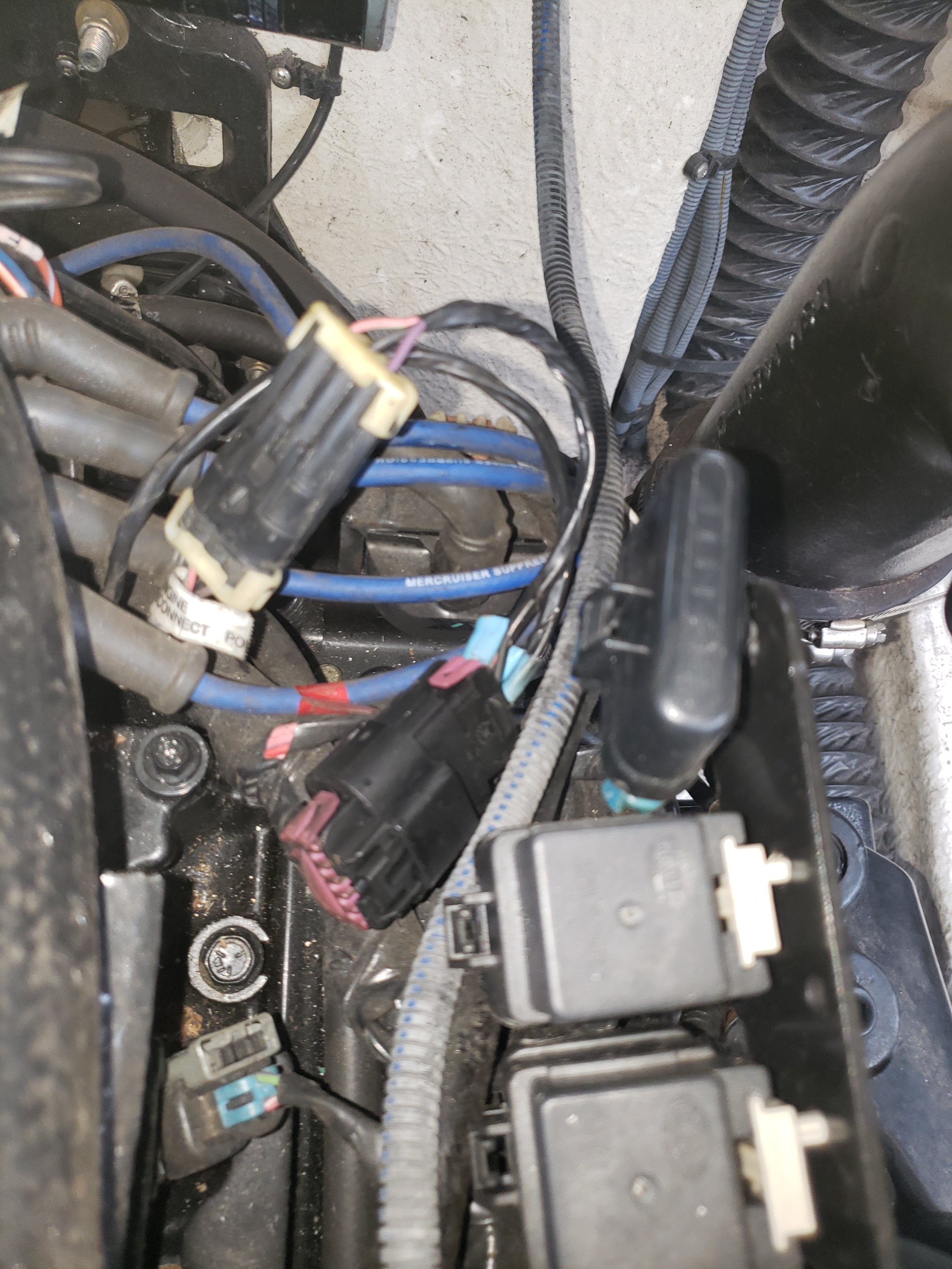

I found the plug in the port rear corner. And it had a weather cap on it, not a terminator. I installed a yellow terminator on the VV pigtail and everything worked! And my tach stopped bouncing too!. Gauge reads higher than VV and I will trust VV
