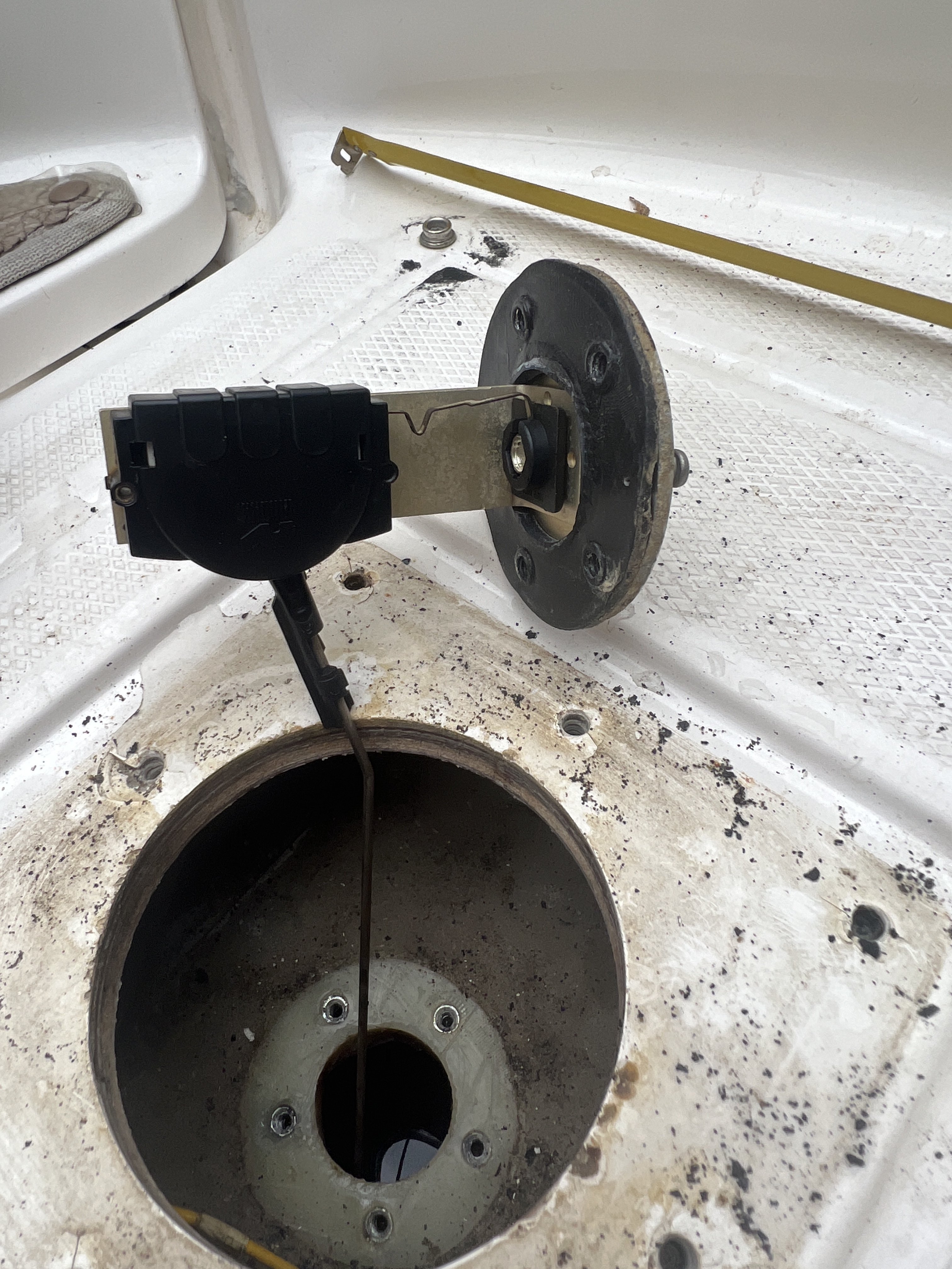

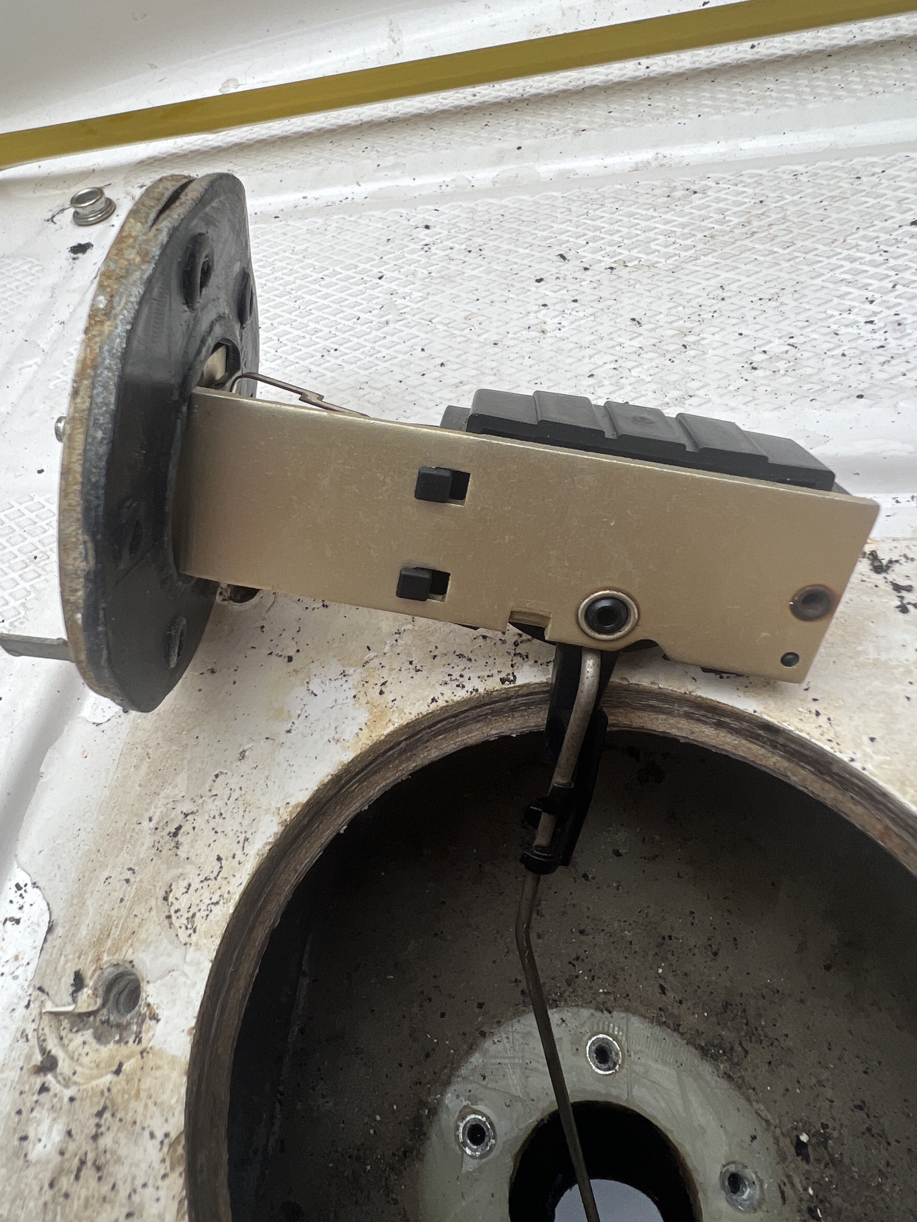

I was told by the local Chaparral dealer that many different types were used by Chaparral, so they could not give me a definite answer about the manufacturer of the sending unit.
I have pics of the unit:
-a very close look reveals a letter 'R' on the side of the unit.

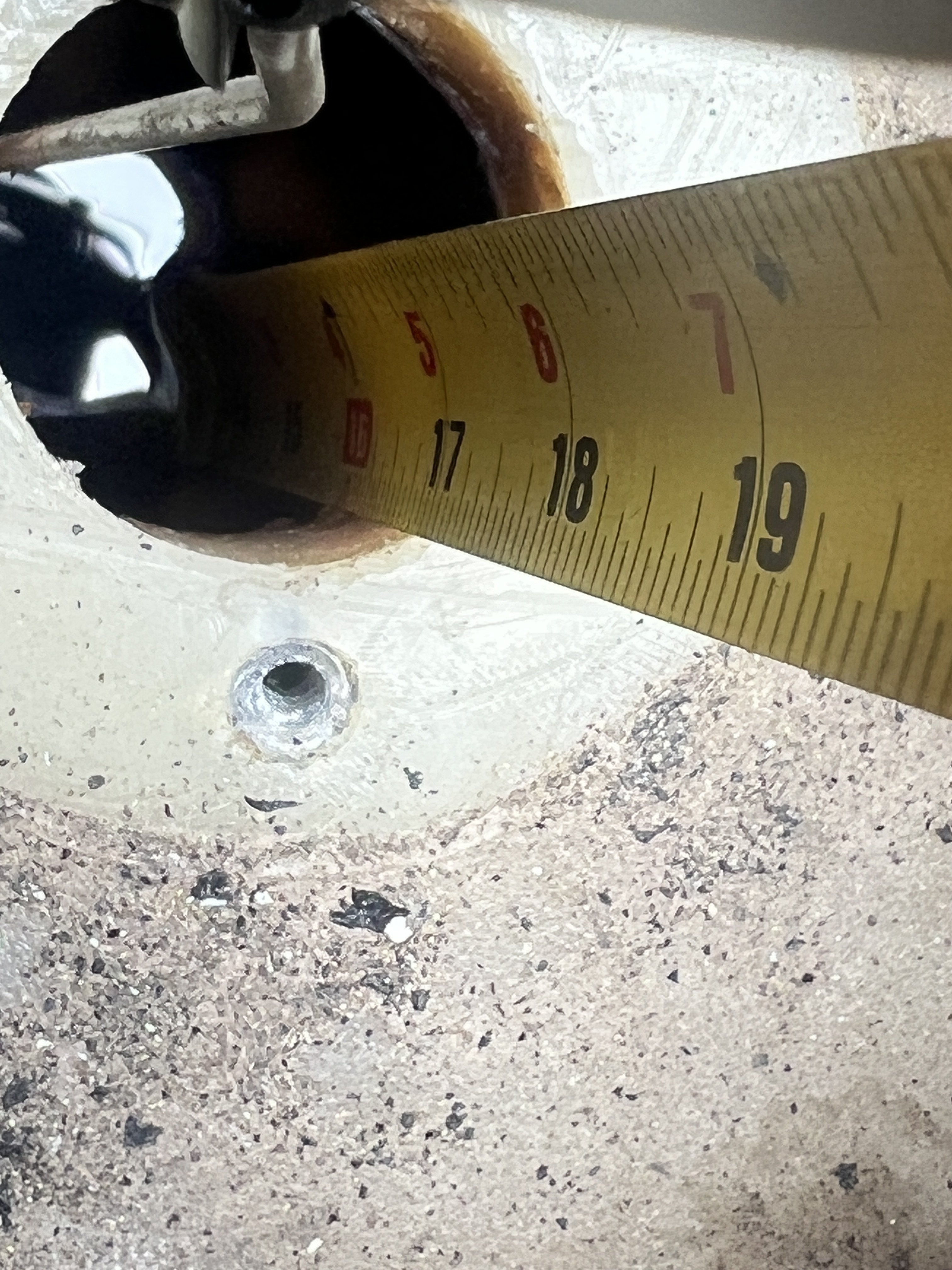

-the depth of the tank, from the bottom to the inside top/ceiling, is about 16".
-the lever arm, which suspends the float, is about 14"
Does this look familiar to anyone???
Thanks in advance!

LAKETIME
I talked to a rep at Moeller, asked him about the big 'R' logo, and he thought the sender might be a Rochester unit.

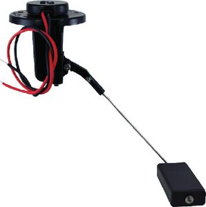

I looked up a Rochester 9371 (adjustable Reed-type), and their image is this:
I Iooked up the Moeller
(Moeller 035791-10 Fuel Sender-Reed 4in To 24in)​
adjustable unit on iBoats.com, and their image is this:
Same Manufacturer???
You can use any sender as long as you can adjust the length of the arm to match the depth of the tank. And as long as the ohm's on the gauge and sender match. As things get older for one reason or another it may be difficult or impossible to find the original. My girl is in her late 30's, a number of years ago I replaced the sending unit, and this season I replaced the gauge. As long as the ohm's match you are good to go.
My only advice is to do your research, and don't shop price. I always like to talk with the people that are selling what I am looking to buy.
And in your case, you only want to change it once.:)

I ended up ordering the Moeller unit that I displayed, as it is adjustable. I purchased from iBoats; I've done business with them before.
