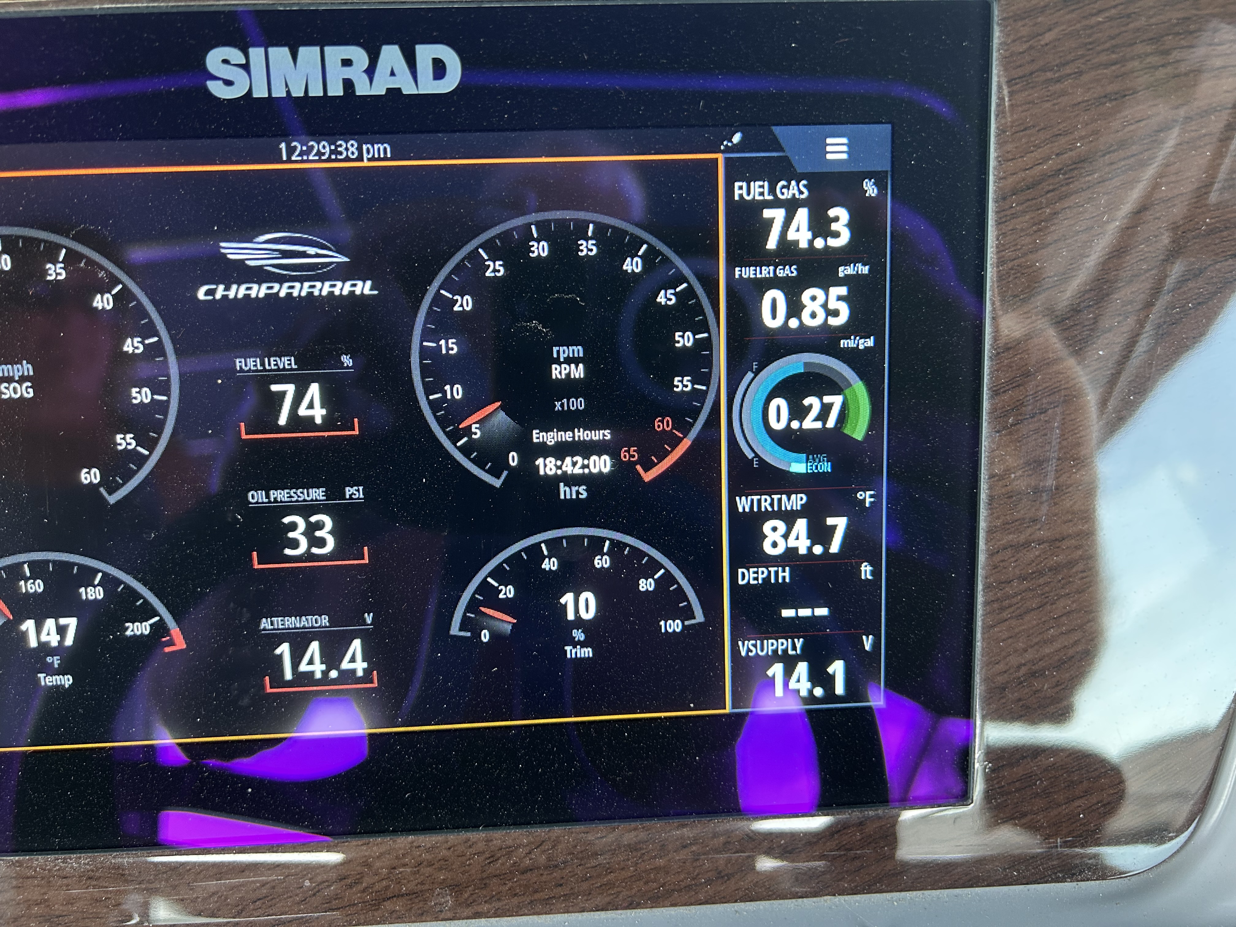

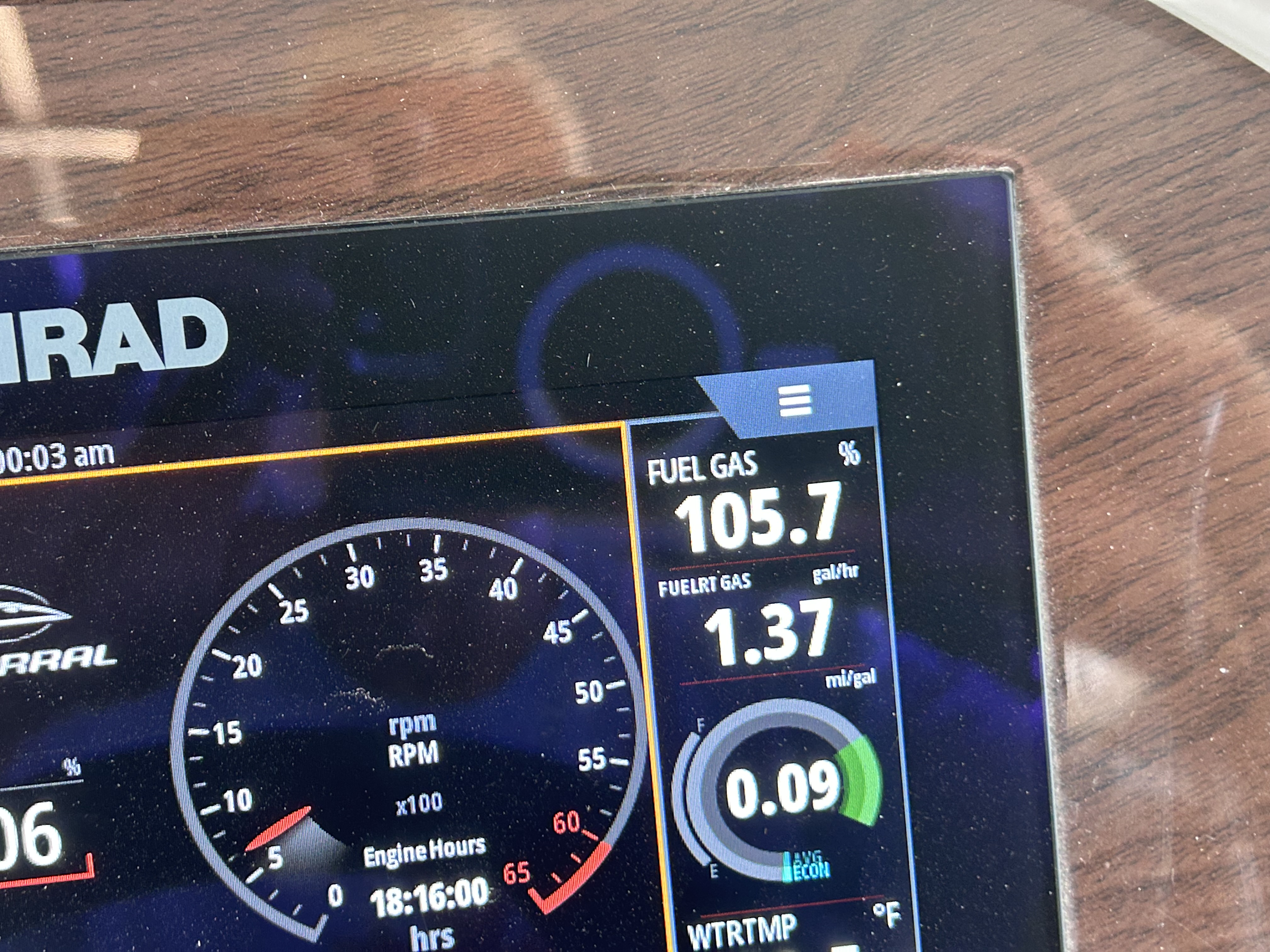

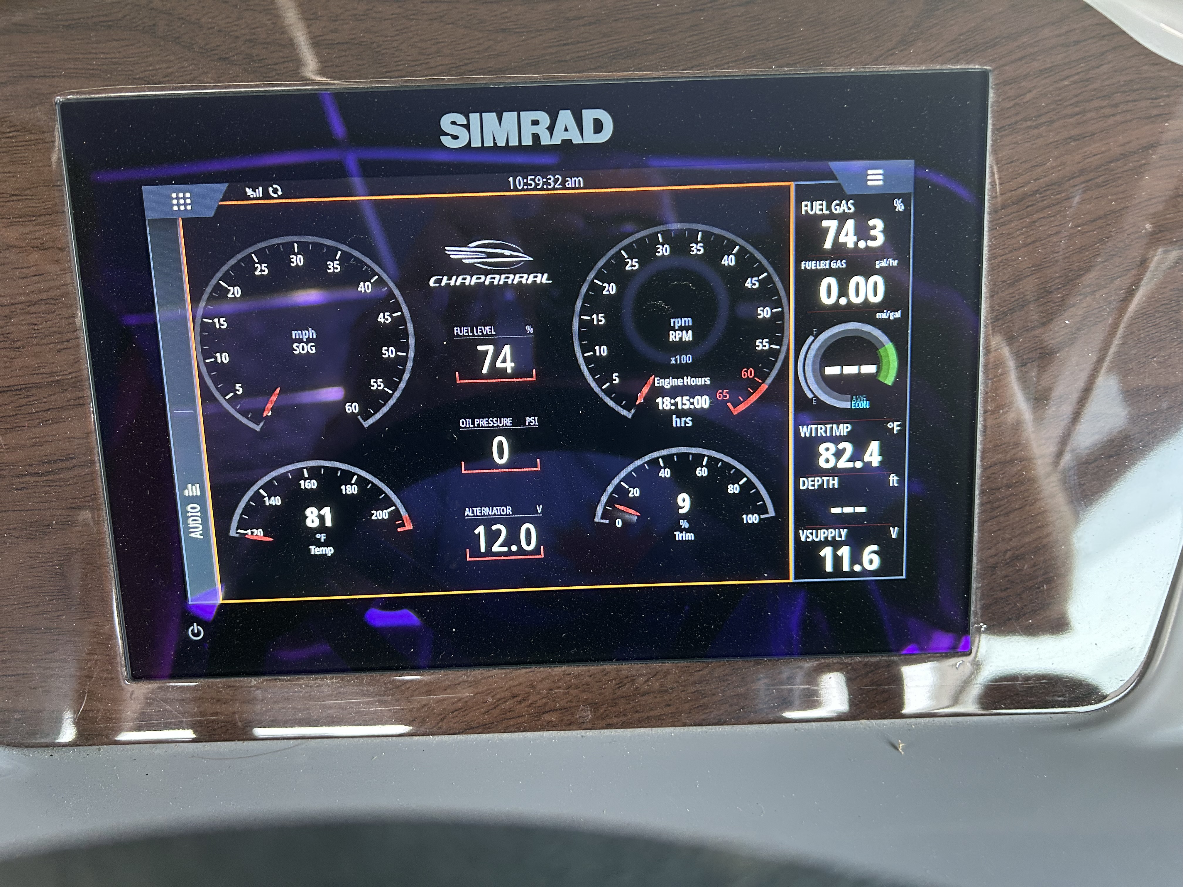

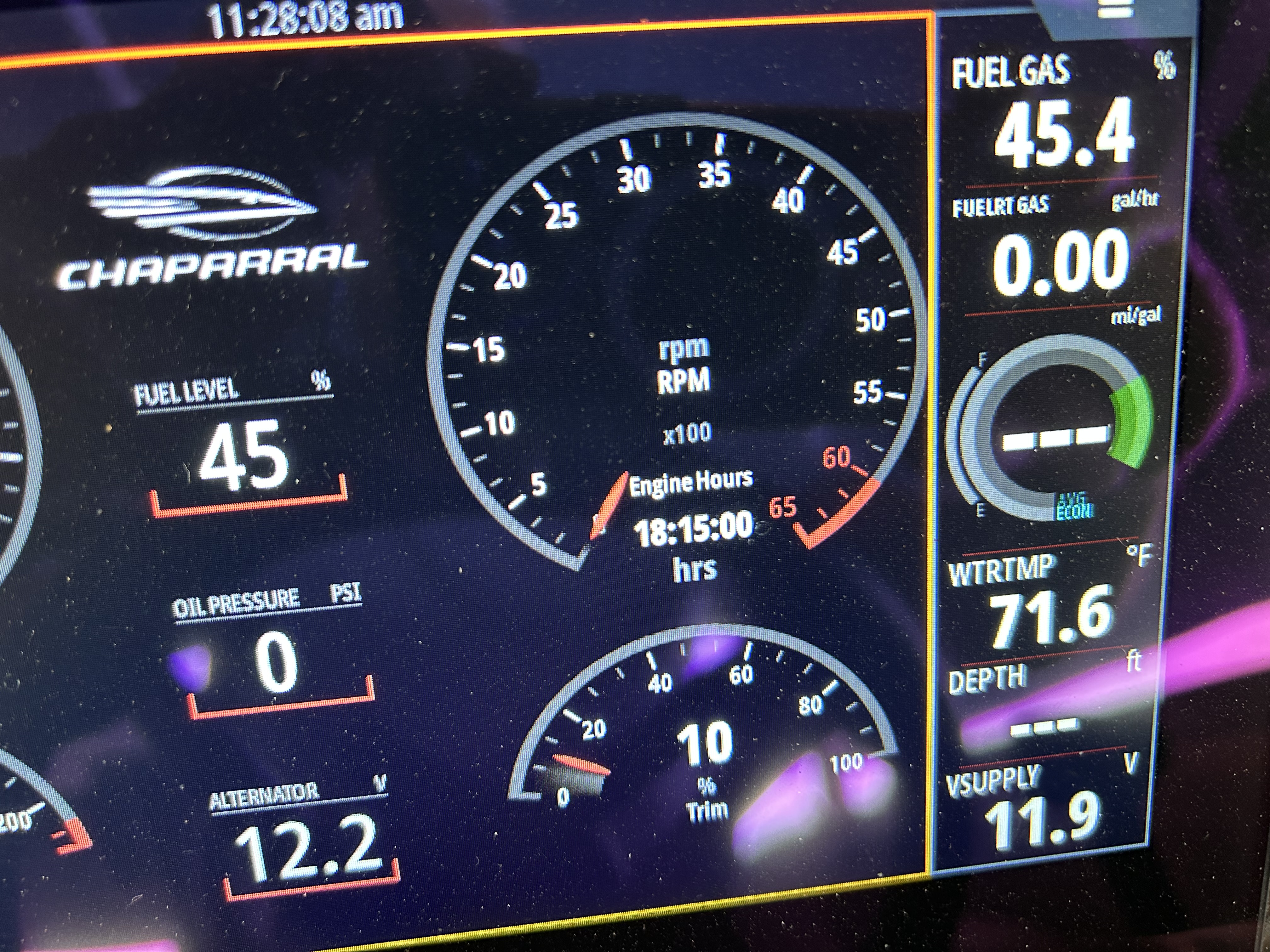

I have a 2024 Chaparral 21’ SSI with I/O. The fuel gauge has never worked correctly on the Simrad display. I took it back to the dealer at the end of last season and they claimed to fix it but it’s not clear they really did anything. They pulled the tank sensor and found the tank almost empty but it wasn’t reading that low. This year I was sitting on my boat lift with a very slight rocking from some very small waves and the tank reading was going from 46% to 54 & 54.3% to 63% and occasionally up to 74%. It was always those numbers with nothing in between. I added approximately 6 gallons of gas to the 40 gallon tank and the readings would then bounce back and forth to the readings of 74.3% and 105.7%. Once underway it would display a constant 105.7%. If I raise the boat completely out of the water so that it is very still I can get a constant reading. 6 gallons is only 15% of a 40 gallon tank and should have only made that much difference in the reading instead of jumping tp 105.7% so I have no idea how much gas is in the boat. I’ve had very little support from the dealer this year. They did switch out the fuel sensor with no change in symptoms. They did at last contact Chaparral and Chaparral told them to change the fuel display to a bar graph. As expected that did nothing to help with the problem. The bar graph is just a graphical display of the percent reading and it jumped around just like the percent display. Any suggestions on where to look for the problem? Thanks

Thanks for your reply’s. I don’t see adding baffles as a practical solution and while I can certainly keep track of hours that would not be preferred. Plus I don’t trust the baseline of a still boat since I can add say 10 gallons of gas or 25% of the capacity and the gauge will then show 35 to 40% more gas in the tank. Do I believe before or after?
I also understand that a boat underway will push the gas towards the back of the tank and change the reading. I’ve had 4 small boats before and never had this kind of problem before. However they were all analog gauges and this is a digital Simrad display.
Certainly there is enough smarts in the Simrad to make a much more accurate reading by tracking fuel usage and reading the sensor without it bouncing all over the place. I would have expected Chaparral to setup the Simrad to give fairly accurate readings and not expect us all to keep track of hours and mentally calculate how much gas is in the boat every time we go out? The dealer agrees the boat is not reading correctly but they seem to have no clue and Chaparral doesn’t seem to be helping. I paid a lot of money for this boat and would like a gas gauge that is reasonably accurate.
