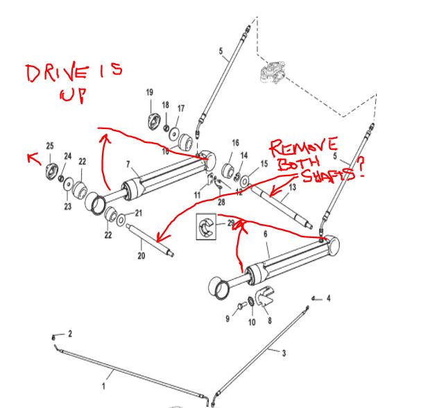

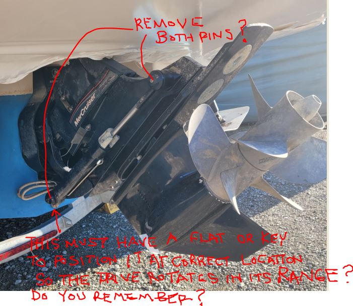

So is it ok to remove the 2 trim cylinder assembly pins with the drive in the up position without messing up anything? I understand the thing is a beast and very heavy, so i would get a guy to help hold it up.
I am worried it may not go back together correctly and the tilt will be out of whack....
It looks like both pins have to come off to allow me to lower the drive down by hand.
Another thought is moving the bellows while they are ice cold would probably do damage.
I may wait for a warm December day, LOL , and either remove the pins & lower the drive or cut the shrink wrap and power the drive down with battery hookup...UGH...

I know when they take the drive off for service, they remover the 2 cylinder pins, but they have the drive down on a block of wood. When the reinstall them they seem to go back together in place. Just wondering if taking them off in the up position would be a problem?

I am not understanding what the battery has to do with taking the rods off or shrink wrapped? With the rods off, the drive might be too low and flex the bellows the other way. Not sure on that, but it comes to mind.
