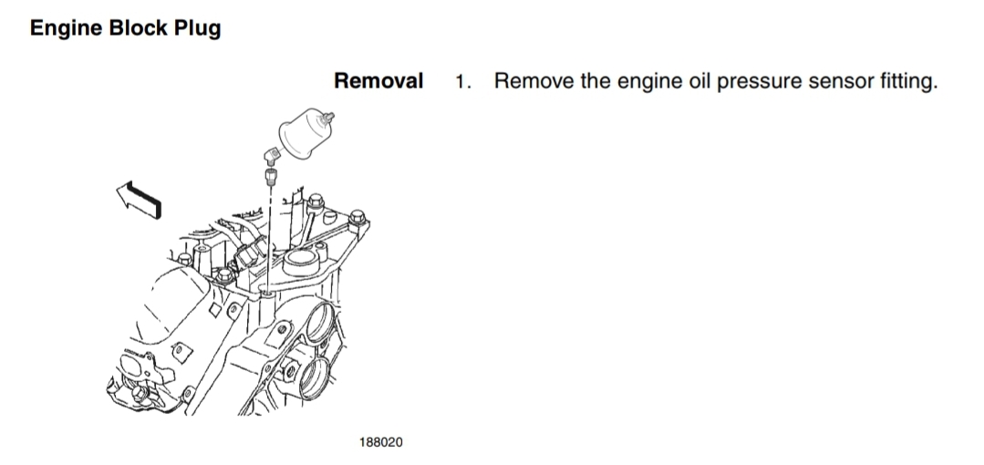

We made it home slowly just in case at around 7kts. Started to investigate and got the service/shop manuals out for the engine which covers many versions of the 4.3 from GX to OSi etc... In the manuals it shows a pressure sender that is around 2inches in diameter with a single ring terminal connector at one end and a 1/8in NPT thread at the engine end. It shows the sender connects to a 45 adapter at the rear of the engine, near where the distributer goes I think. I ordered a Sierra version of this sender for $50.

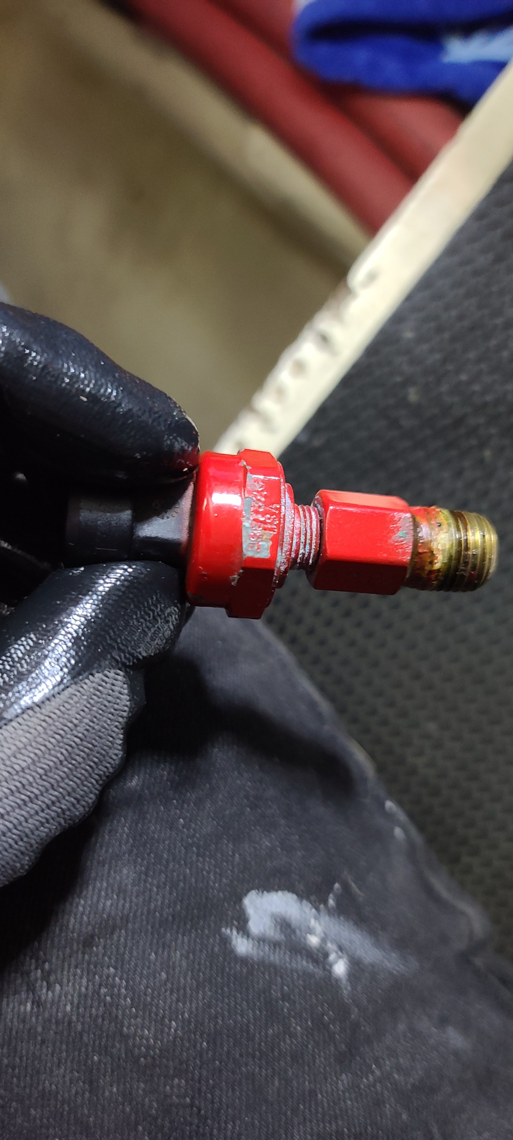

Looking around the rest of the engine, I found a couple of other senders. Both on the port side of the engine, just past the most rearward exhaust port of the manifold. One is coolant temp as its attached to coolant lines. The other is right above the oil lines that connect to the remote oil filter housing. It was actually barely hand tight, and I pulled it out and some oil escaped, maybe 100ml.
Once I was able to see the part number on it, determined that its the sender/sensor/switch. It has 3 terminals and is smaller than the sender I bought. Once disconnected my boat reads 0 oil pressure and the alarm is sounding every 2 seconds. This part is 3887328 which isn't referenced anywhere in the shop manual. Also luckily, it's much easier to reach and access. Should have the part next week and hopefully all is sorted.
