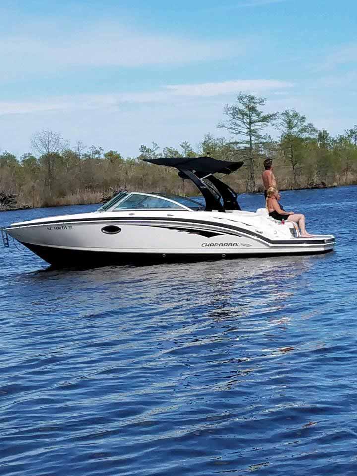

I have 2013 244 Sunesta and wondering if anyone has replaced a dock light light bulb....
Not sure if you have to replace whole unit by removing from front of boat or can you remove just the bulb from the back.

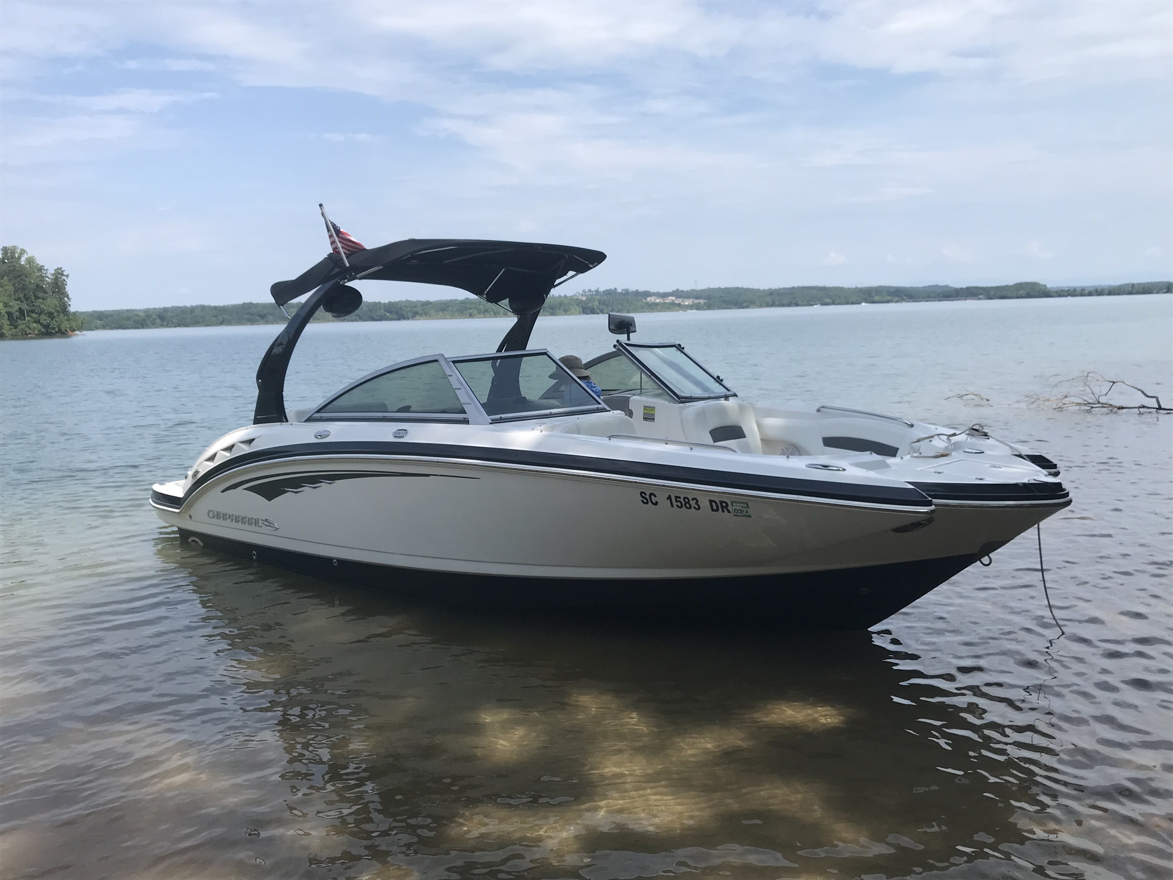

I have the exact same boat, year, model and colors!
You open the dock light housing with the three screws on the front. There is a spring-loader retainer ring that is a little tricky to manipulate, holding the bulb. I used MR-16 50w LED bulbs found on Amazon.
