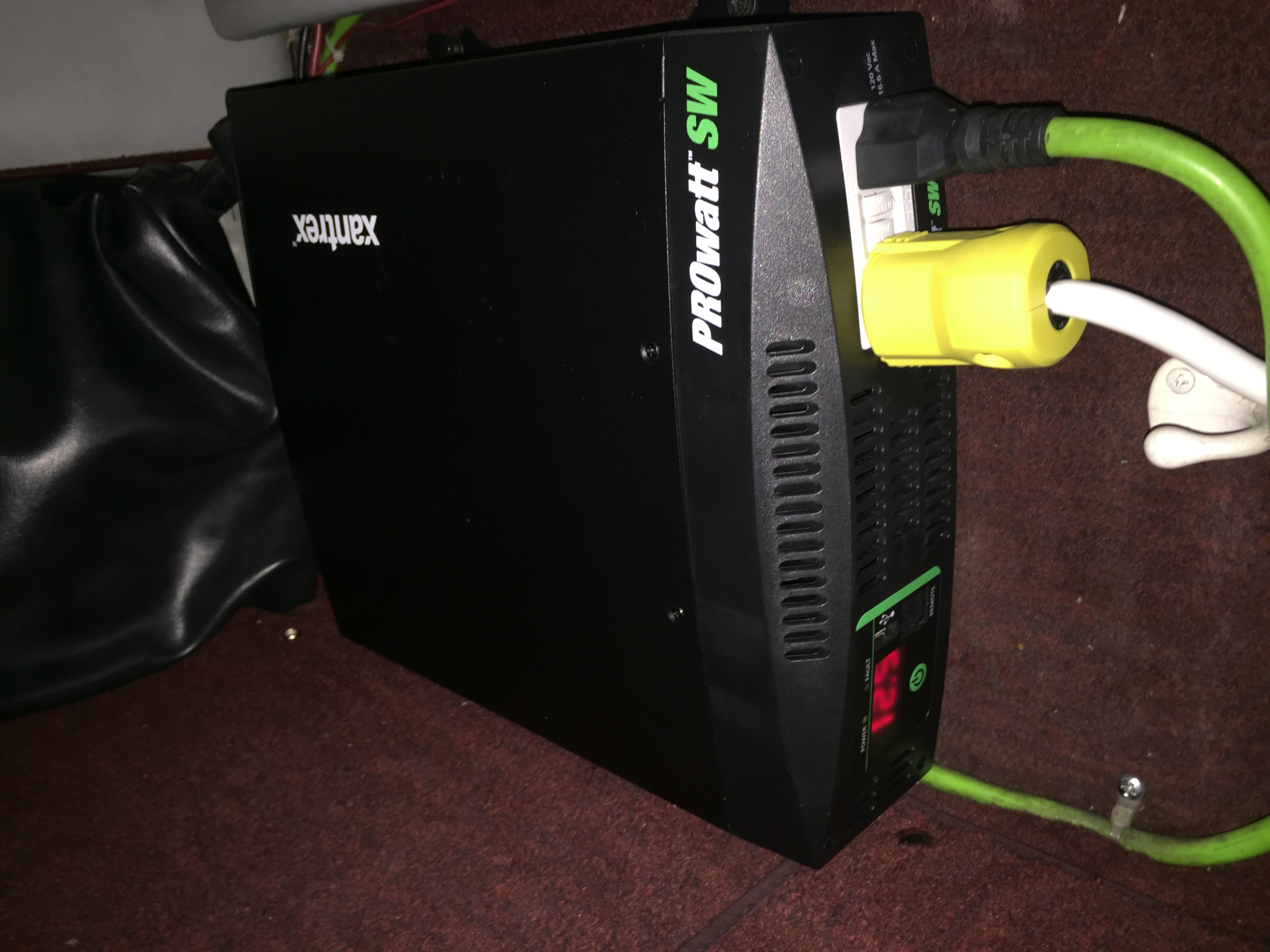

They make a great inverter, Xantrex. In my basement I have a 2000 watt one from them. I had it on an older boat that I pulled out when I sold it. The biggest problem I had that there not ignition protected. So when I bought my Sig 290 the cables would need to be very heavy and long that I didn't use it. In other words, I could not install it in the engine compartment and their not water proof.

My 1st inverter also was an Xantrex. My records show that I bought it in 2003 from West Marine for $479.00, which included the inverter, 3ft of blk and red #2 wire, and ends, and finally a 250amp fuse and holder.

18 years later, and thanks to the internet, I bought the new and improved inverter direct from Xandrex for $417.00
