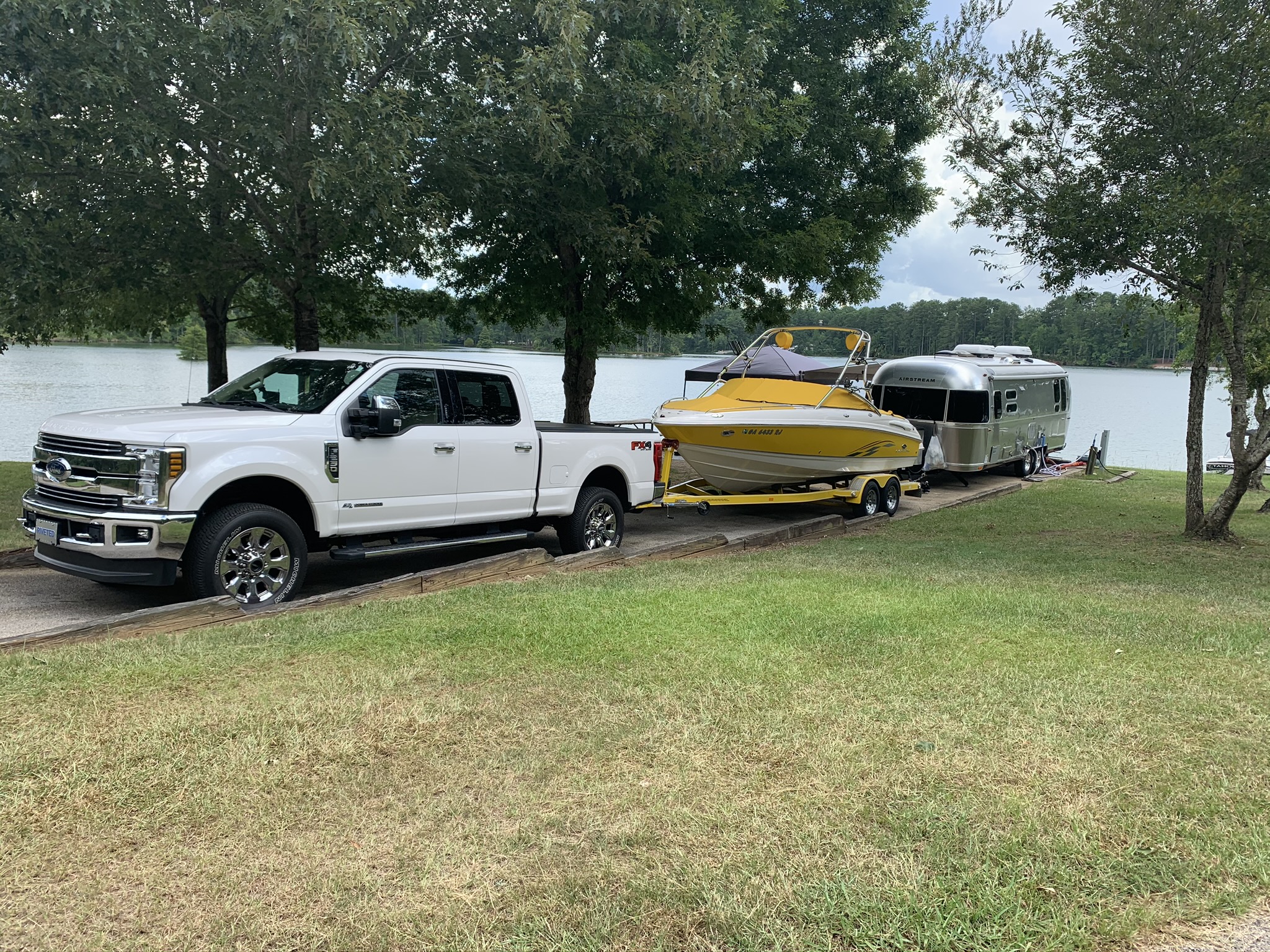

I am towing a 22ft Chaparral with a 2018 F250 diesel crew cab. My boat weighs right at 6000 lbs loaded with full fuel and stuff for a day at the lake. Tows like it’s not back there. Prior TV was a 2016 Expedition SWB ecoboost. Towed the boat fine, lots of downshifts, but it struggled towing my new hobby (28 ft Airstream TT). This is my first diesel, and I will never go back to a gasser.
Had one way-to-close-for-comfort situation with the new truck coming back from the lake this summer while towing the boat. Idiot in a logging truck decided to swerve into my lane as I was passing him. I had to take the shoulder, right up against a guardrail to keep from getting smacked. Don’t know how I did not wreck - I am convinced that having a heavy TV made the difference.
Nice tow vehicle. :thumb:
Sounds like your quick action kept you from a major accident with the tow truck. Good job!!!!!
:lmao: I totally would have missed that had you not pointed it out.
Very nice location you have there. Where bouts are you located. Love the view.
West Point Lake, on the Georgia/Alabama line. About 1 hour, driveway to launch ramp, and is our primary lake. It’s about 15 miles long, and does not have the heavy weekend boat traffic that other lakes in the Atlanta area endure. You can always find a quiet cove or smooth bay for water sports.
The campground is R Schaefer Heard, and is an Army Corp location. Great waterfront sites, super people and only $14/day with my senior pass.

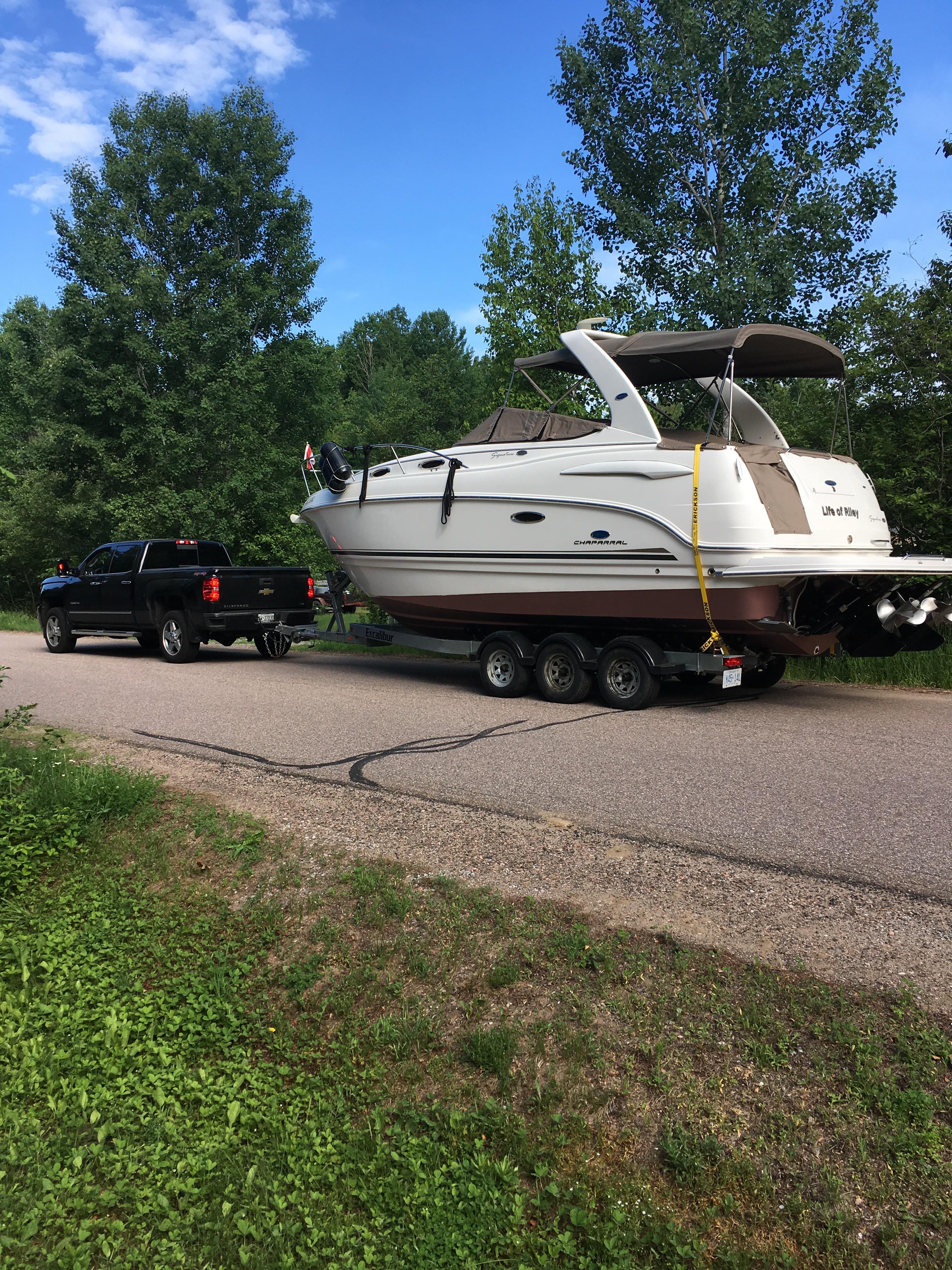

You never want to max out the capacity of any tow vehicle. My boat comes in around 8400 lbs dry weight but if you add in the weight of the trailer and say a 1/2 tank of fuel, I’d easily exceed the standard pickup truck capacity of 8700 lbs. It’s why I upgraded to a Silverado HD 2500 series that had a HD transmission, suspension and brakes. The stiffer suspension makes all the difference in handling/confidence. That’s what I would recommend.
I didn’t want to give an insurance company any excuse to not cover me by using something that is marginal safety wise! Plus if I buy a 5th wheel down the road I won’t have any issues there either ?
Only 3 years old ... had to upgrade to a Chevy Silverado LTZ 2500 HD to move this unit around safely.
:wow: nice set up you have there. Your boat looks huge. surprised it is under 9k.
I agree with not maxing out your tow capabilities. Many times the vehicle might be able to tow the load, but more important, can it stop the load efficiently? I've found that stopping is very important. :D
Thanks! Stopping and control were the key factors for me. The boat definitely dwarfs the truck at 29 feet overall length lol! And while it is under 9k (barely), when you add the weight of a tri-axle, galvanized trailer, it’s probably closer to 12k. But with the proper heavy-duty brakes, transmission and stiffer suspension, it actually handles in a surprisingly predictable manner...which is exactly what I wanted. The biggest issue for towing is the height of the arch. Got to make sure I’m not taking down people’s hydro/telephone lines on the way to and from the dock ? Plus the beam is wider than the road allowance so a “wide load” trailering permit is required (technically)...

One thing many folks don't do when towing is to add extra straps for added security. I've seen videos where someone had to brake suddenly and the boat just climbs the bow roller (after breaking the strap and safety chain) and end up on top of the rear of the tow vehicle. I didn't do it in this picture because it was my first attempt at towing the boat and I hadn't yet seen those videos.
Ever since I saw those, I never rely just on the strap and safety chain! Now I slip a 3,000lb ratchet strap through the bow eye (after the the main strap and safety chain are in place) and hook it to the trailer eye loops. I also thread one of those straps through the rear cleats and secure them to the eye loops at the rear of the trailer for added security. I can tell you that it makes towing the boat feel much more secure. No wobbling on the trailer when you hit a bridge expansion joint or a bump in the road!
Remember, you might be able to stop the tow vehicle safely but if something fails, you're not stopping 9,000 pounds of inertia behind you once it gets moving!! The laws of physics will ensure that!!
Between the truck and the boat, there's just way too much money invested for me to risk a "holy f@#ck" when it could easily (and for about $30.00), be avoided.
