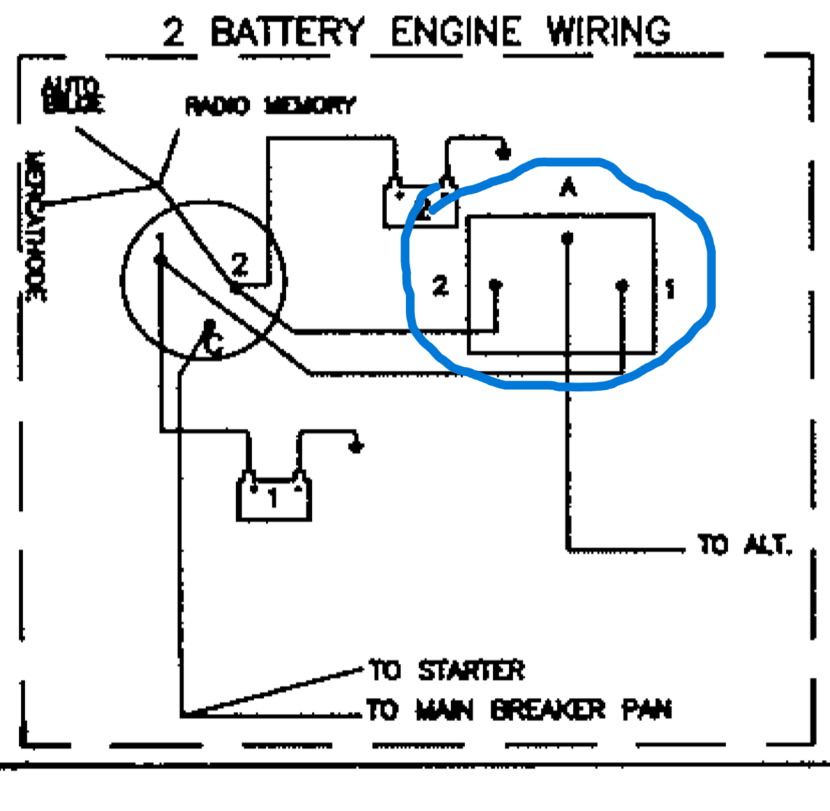

I purchased a Chaparral 1930 SS Sport 5.0L last year and while getting it ready for spring I found out that the number 2 battery doesn't power anything when selected. The batteries are fully charged, I replaced the Perko dual battery switch even the old one tests good, the cables are correctly installed and getting continuity and I'm stumped. Battery select 1 and both works just fine but in the number 2 position I get crickets at the ignition switch and no power to anything. I also have a question about something on the wiring diagram that I cannot identify and it's a box labeled "A" with a 1 & 2 in it and then a single wire goes to the alternator. See image below and any help would be greatly appreciated.

"A" its a battery isolator ,allows both battteries to charge no matter what battery is selected.
As far as #2 battery, check to make sure the negatives are connected together

Thanks for the info on "A". Yes, the negative is connected between #2 and #1 and both batteries are being charged when engine is running. I have switched the batteries and get the same result and all dash switches and gauges work on battery #1 and both but not battery #2. I thought maybe that "A" box had a fuse in it that may be blown on the #2 side but since both batteries take a charge I have no idea. I think I broke my brain going around in circles with this because this is pretty simple and it makes no sense why it's not working.

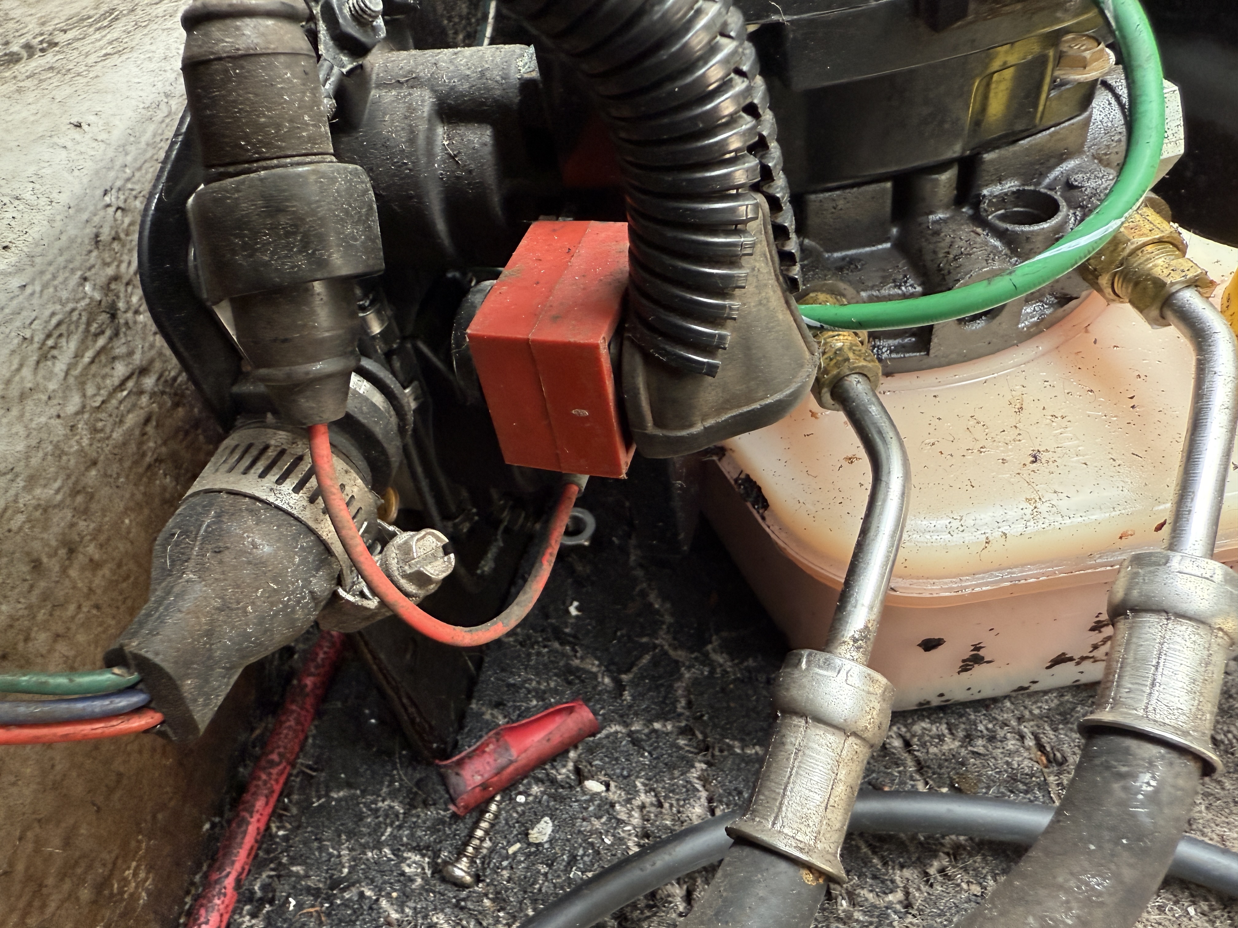

Ok, so I’m an idiot for connecting the cables like the previous owner. They had the bat 1 cable on the common and vise versa. Now that I’ve got that squared away is the red box the isolator and can I put a bat 2 cable on it over the bat 1 cable? Right now there is only a bat 1 cable attached and I’m assuming that bat 2 will only charge if the selector is set to both since bat 2 has no cable attached like shown in the wiring diagram?

So I answered my own question about the isolator but what I don’t know is why they would have ran the bat 1 cable on the common post? Was it just a mistake or another reason because bat 2 was just along for the ride and not used for anything.
I had an isolator that went bad. The company that I had purchased it from warranted it. So through talking with them and my battery people I got an education. The purpose of an isolator is to segregate batteries. Mine has 3+terminals. There is 1 input terminal which is power coming in from either my alternator or my A/C tender /charger, and 2 output terminals that are labeled battery #1 and battery #2. For me battery #1 is my start battery, battery #2 is my house battery. I took off all my wires and one by one I touched them to my house battery and labeled it and then put it on the battery that I wanted to be on. Then I added a switch on my +wire that I could throw and join my 2 batteries together if one was low and needed a boost.
Also I learned that your alternator and A/C charger when hooked through an isolator will only charge the battery they are hooked to. If I want to charge both batteries, I have to throw my switch. My alternator is hooked up to my battery #1. If I have been draining my house battery, I have to throw the switch to charge it using my alternator. My batteries are hooked up in parallel. You said that you have an isolator, check the voltage coming out of each terminal. Find out where each wire goes and label it. Old School : If you have an issue first look where someone has worked on it. Hope this helps.

Thanks for the in-depth response and I wish I had the time to do all of that right now but my HOA doesn’t like the boat in the driveway. I wired the batteries as shown in the diagram and will only use bat 2 as a house battery as you suggest.
