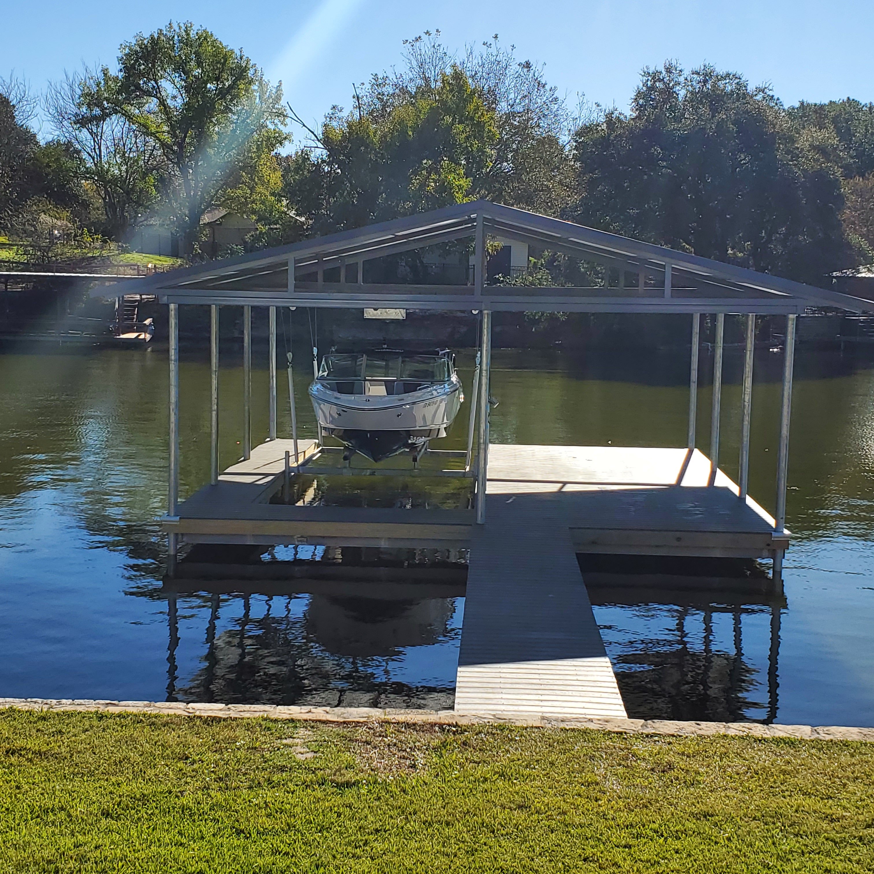

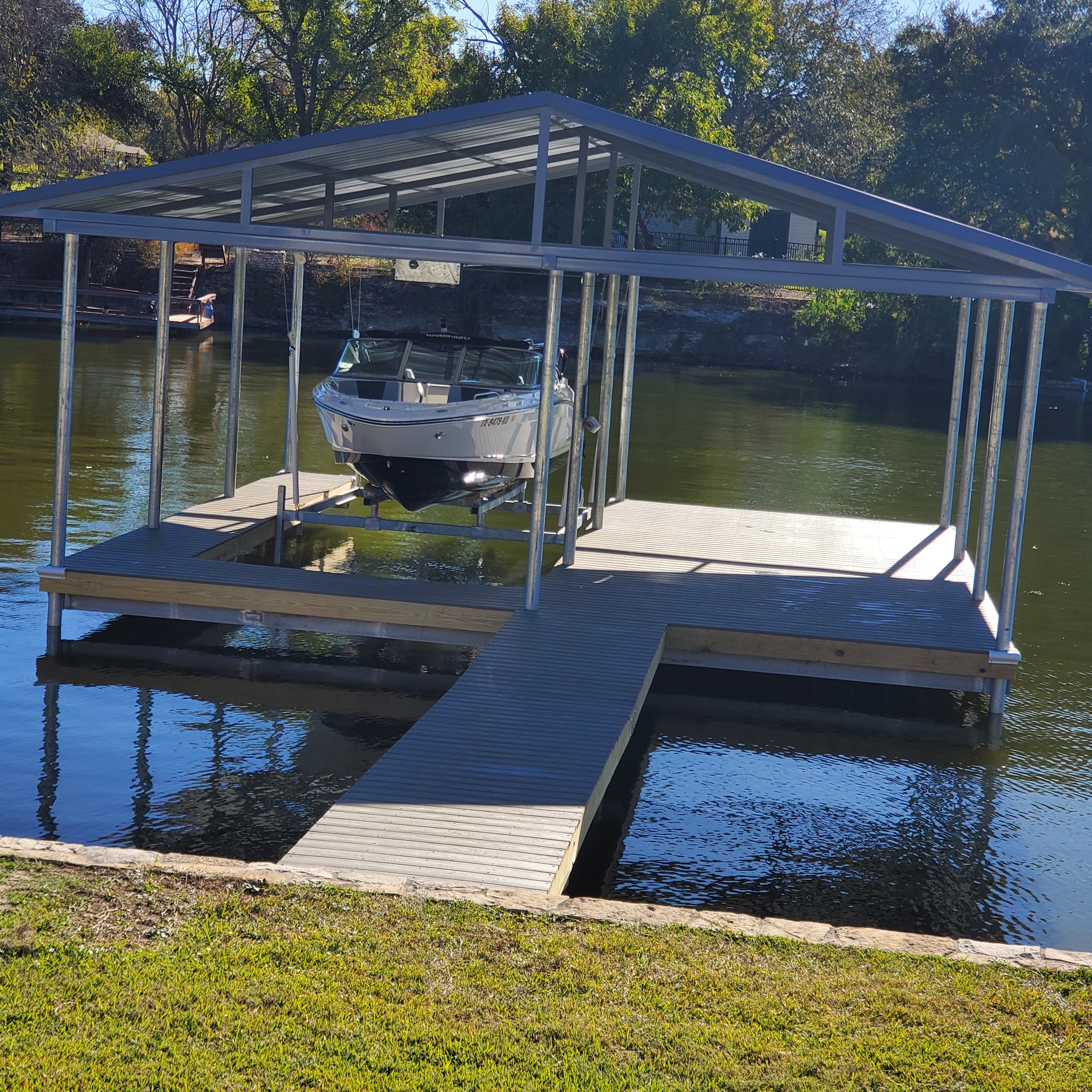

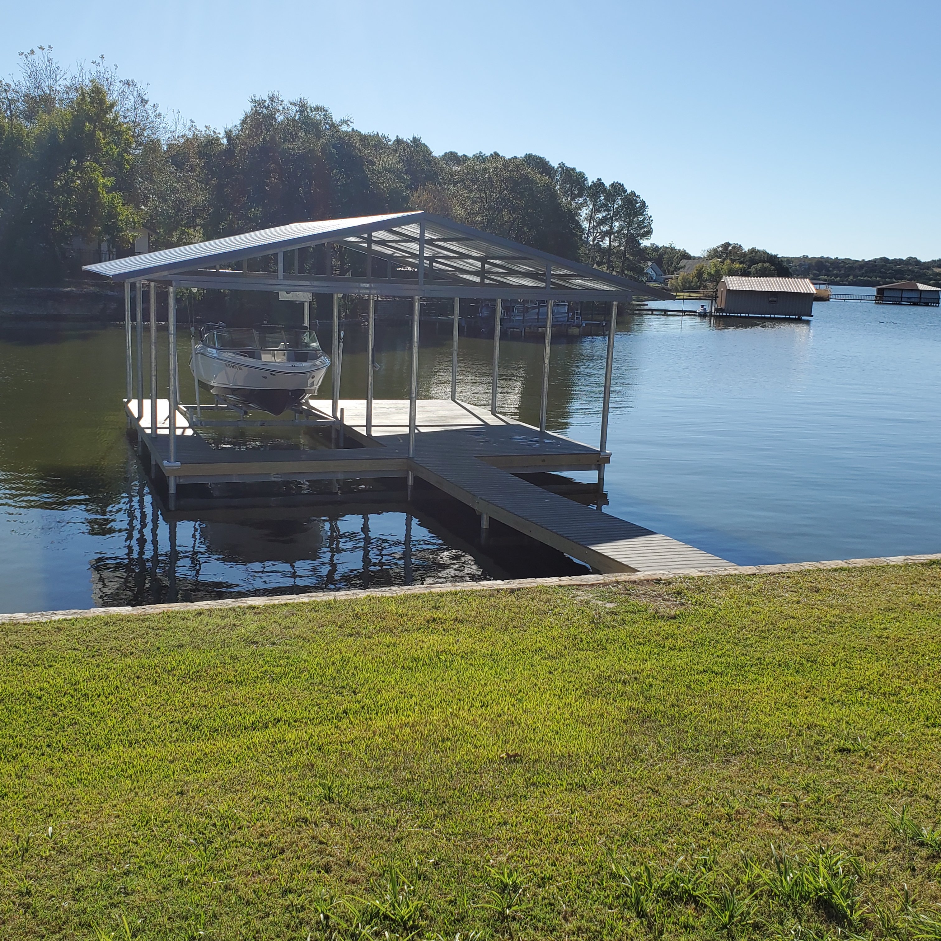

I have attached some pictures of the new boat dock that was finished a few weeks back.

Welcome to the forum, and nice dock, you will get a lot of good use out of it.
