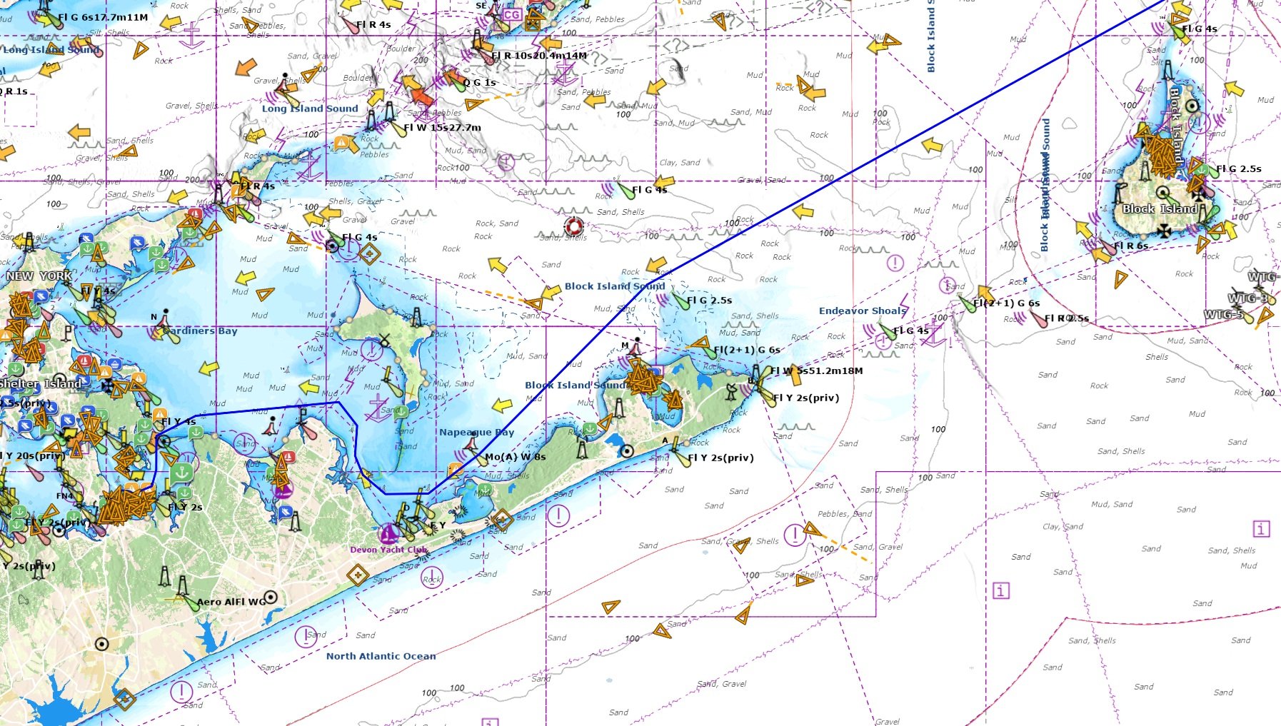

North is up in the Pic. The blue line is my route. Block Island is to the N.E.

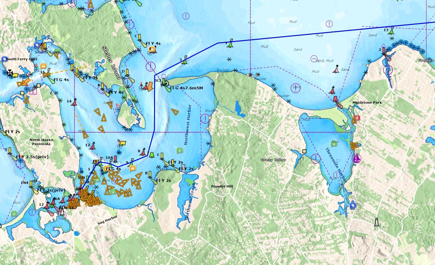

My route stops at Sag Harbor, the triangles are the boats with AIS with is clouding the chart up. 3 Mile Harbor is to the right of Sag Harbor.
It was about a 150 mile run from Boston. We did stop at Cuttyhunk for 2 days.
