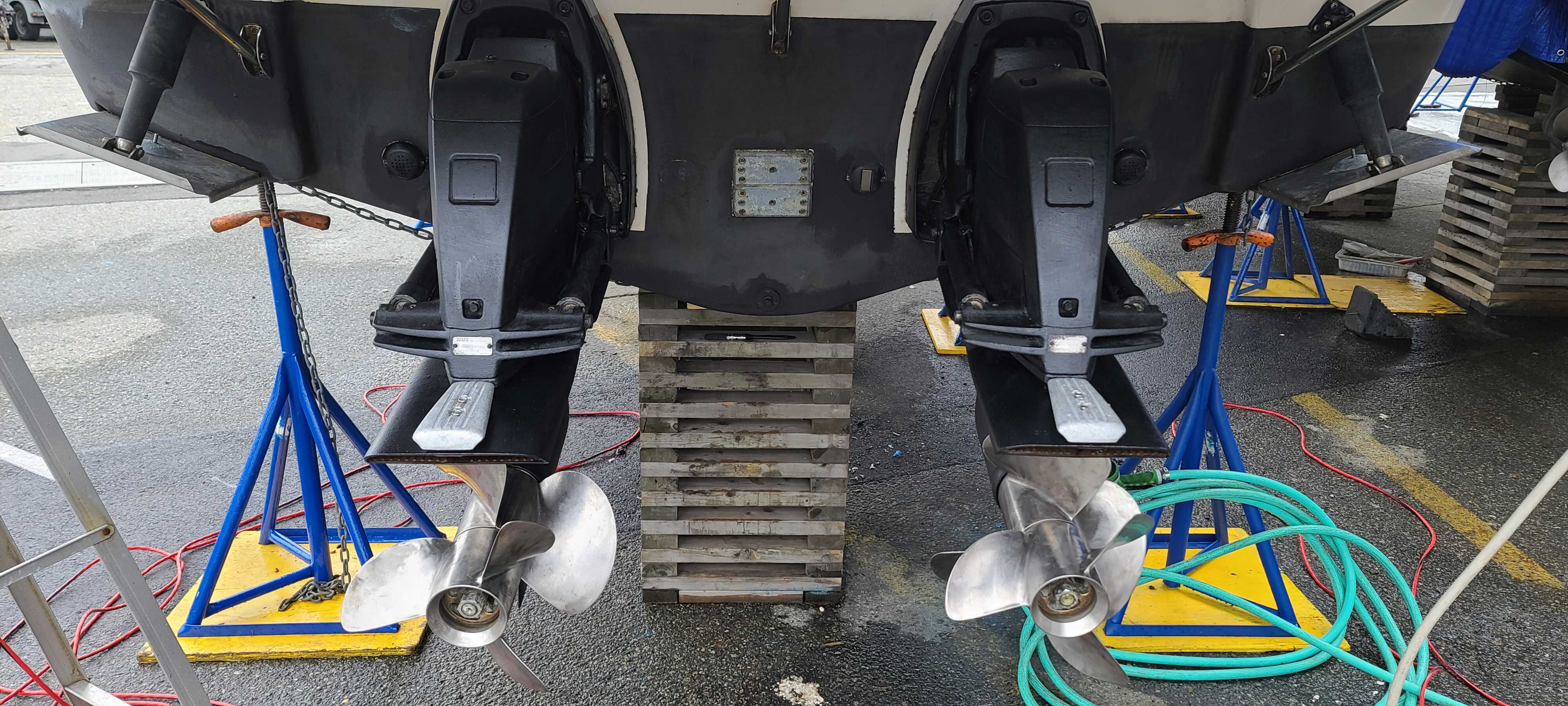

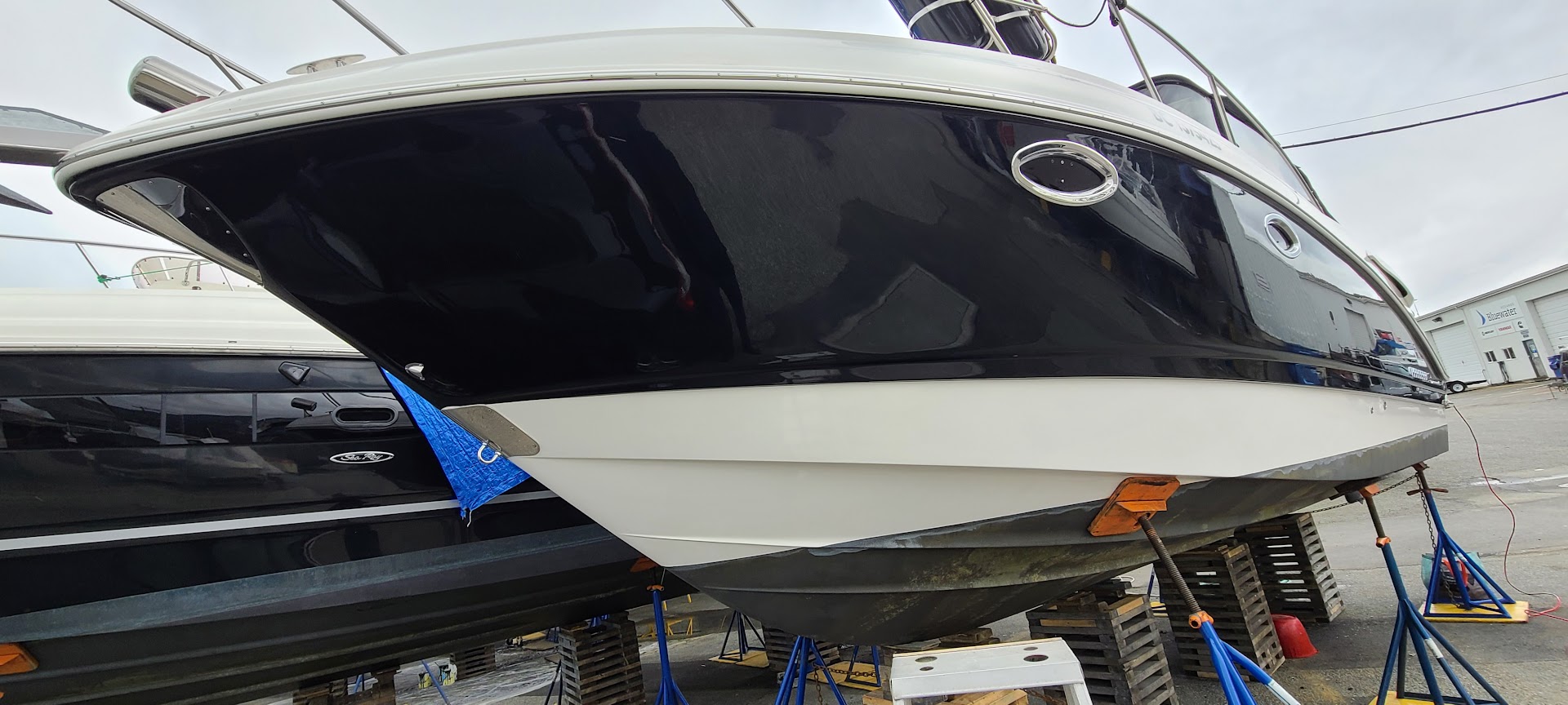

Just pulled the boat out over the weekend for a full hull polish and seal, new anodes, new bellows on the drives, new seacocks from Groco and thru-hulls, new belts & impellers, fuel filters, and a general cleanup.

Looks like you added the zincs to the trim tabs or did it come that way? On mine, I added them.

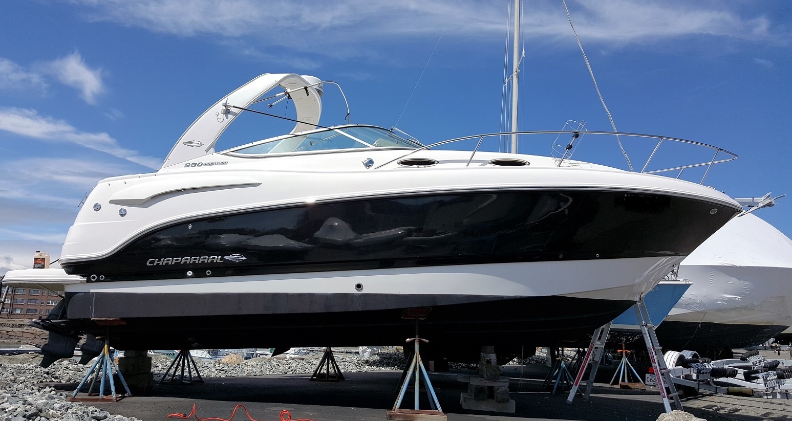

Here is a pic of my old boat. Its now in Pennsylvania.

The zincs on the trim tabs were on the boat when I bought it, but get to about 50% or less the last 2 years I've replaced them, cheap enough so I don't mind.
Interesting how different and how similar our boats were. I prefer that more modern badging on the side there, will probably do that on my boat. Fuel/water fills are in different spots, and the windows into the cabin are different too!
