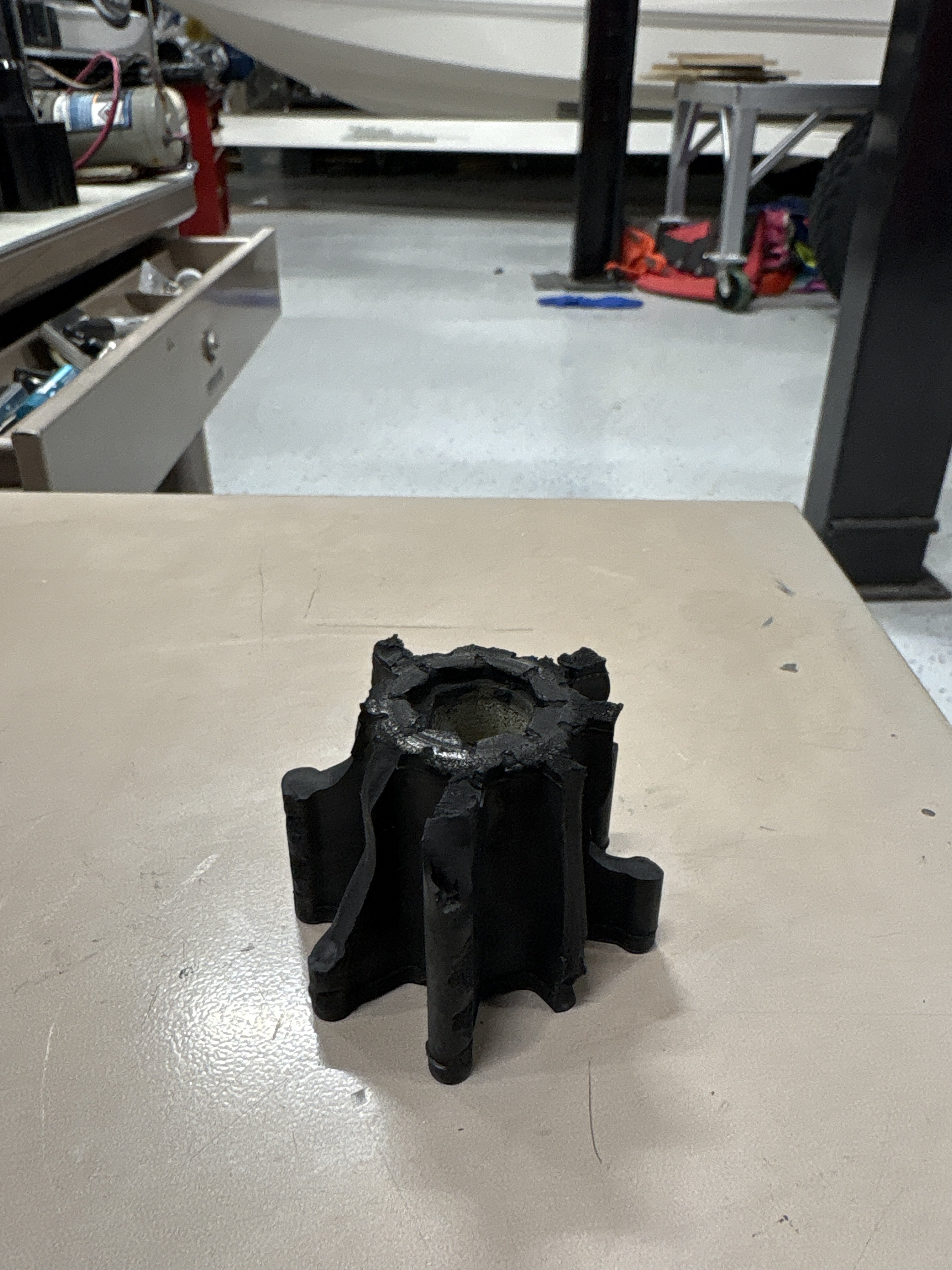

I attached a pic of the new impeller. I did order the stainless housing and kit. I’m cleaning all the water lines out now.

I see what you mean. Really tore up. Hoping one of the other members will pop in with an idea or two.
