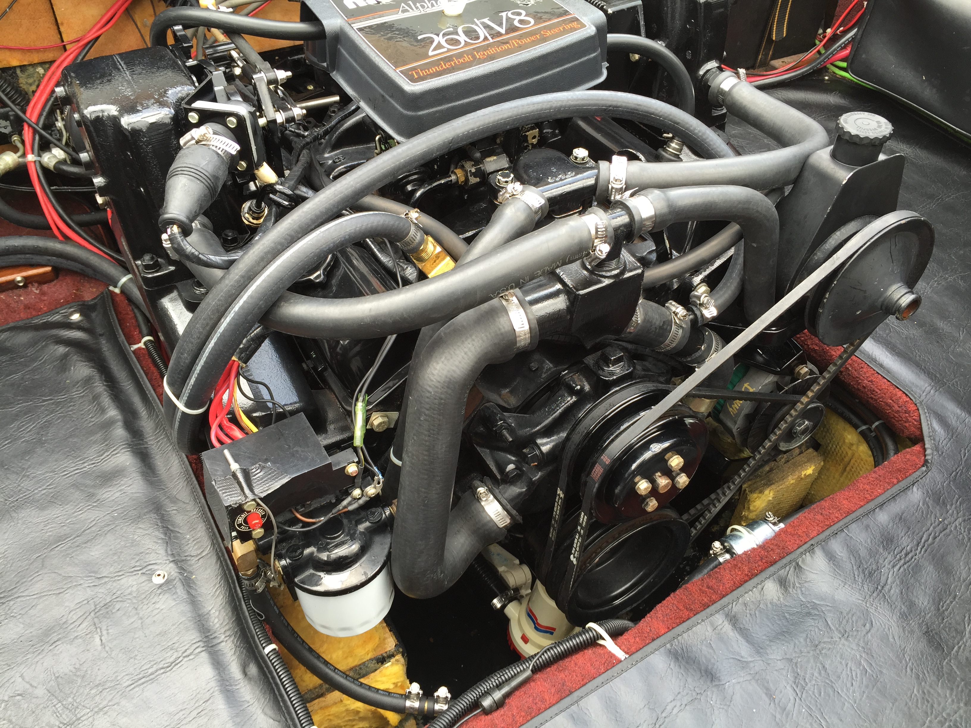

Getting to my engine oil drain plug in my 215ss seems impossible. I pumped all the oil
Out of the dipstick till nothing was left. I dumped a gallon of oil in but seems overfull after I ran it Is it possible that you can’t get all the oil out pumping out of the dipstick tube ?? My others boat you could get to the drain easily.

My engine holds 5 quarts. But I never seem to pump out more than 4. Reaching for the drain plug is too difficult with a hot engine.

How your engine sets to level, may or may not have any effect on how much oil you get out thru the tube.

SST and I can't do that our engines are down in a hole.

I can’t even get close enough to touch the drain plug. I’ve got long arms but can’t reach it.
