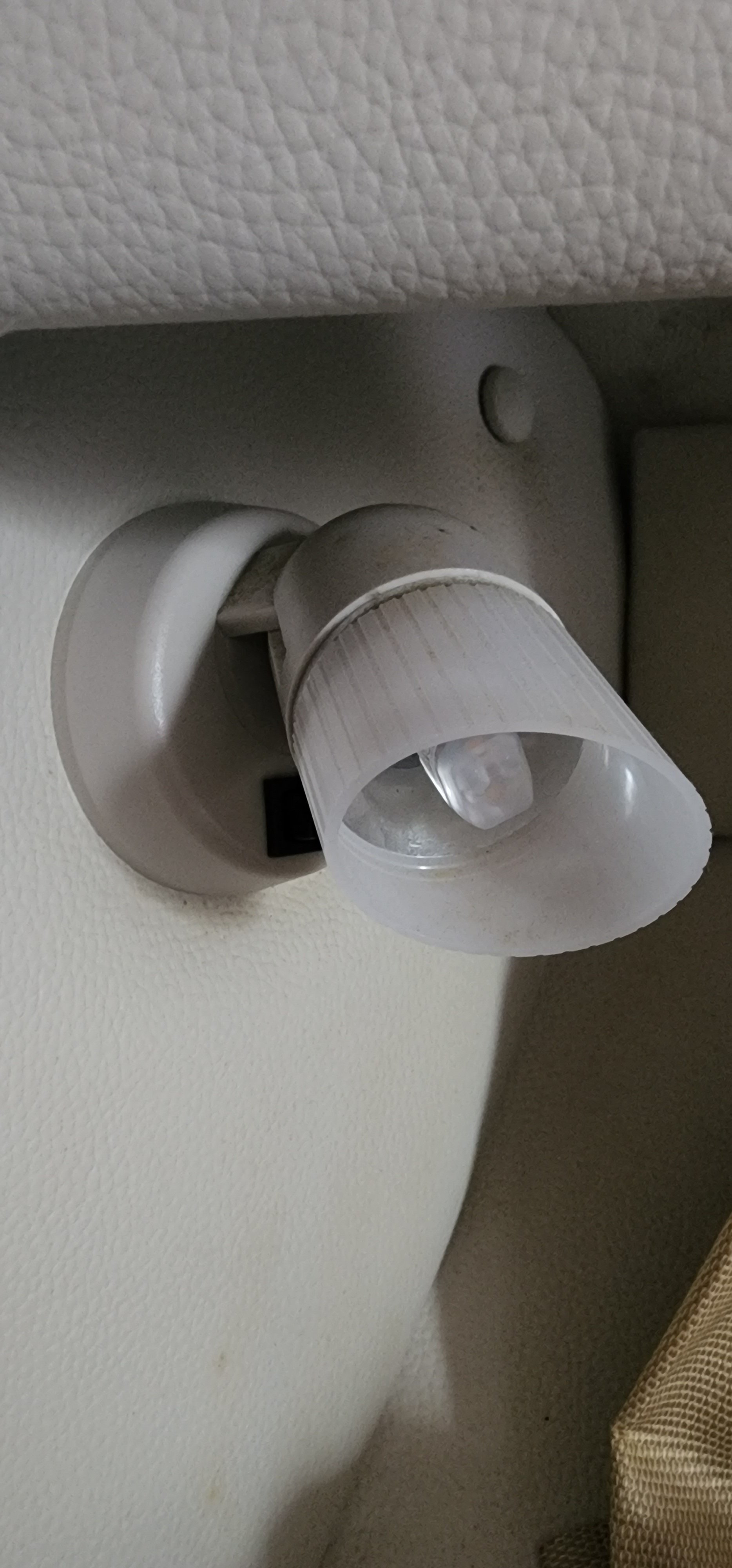

I want to tap into the 12 volt power supply, does anyone know how to remove these lights? No screws exposed are they twist and lock perhaps?

Looking at your photo, it looks like the panel it is mounted on is held on with screws. If so, you may have to remove that panel so you can unbolt the light from it. If there is no access behind it, it is my guess, judging from past experience, that is how it is held on. Let us know.

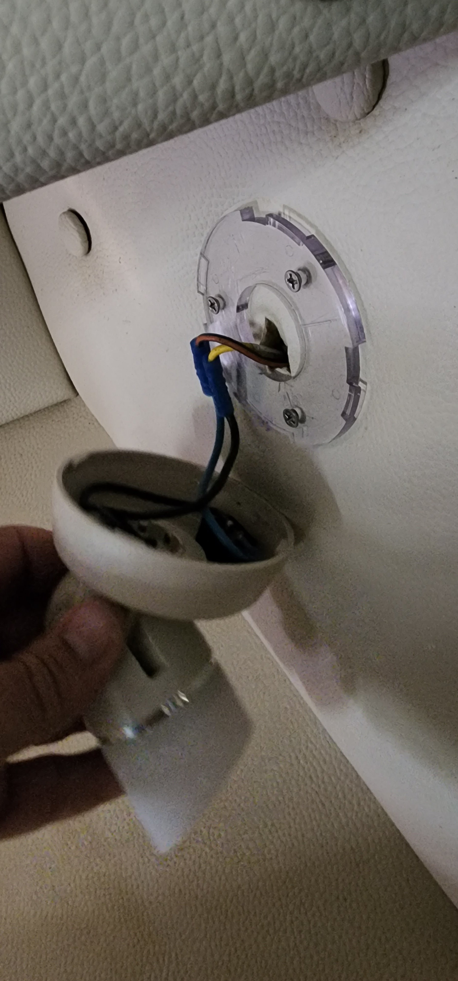

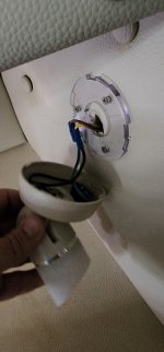

I just changed mine an Sig 28. The swivel part of light snaps off. Then rotate the base counter clockwise, about 1/2" and it comes off. Screws are under there.
