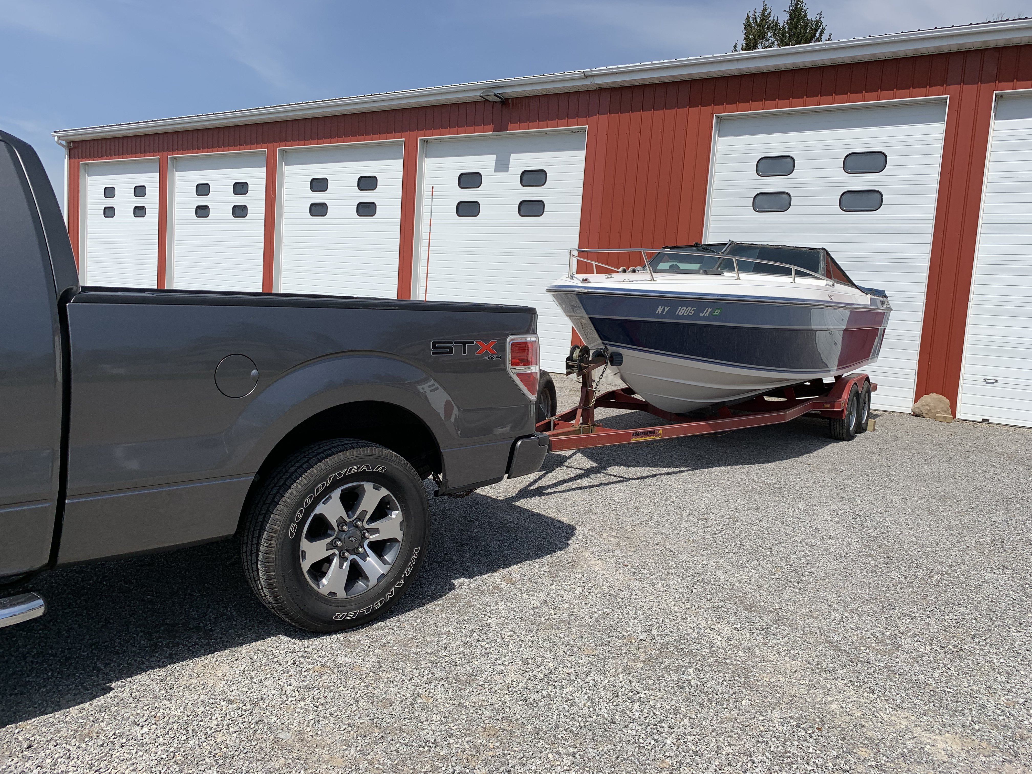

Retrieving:

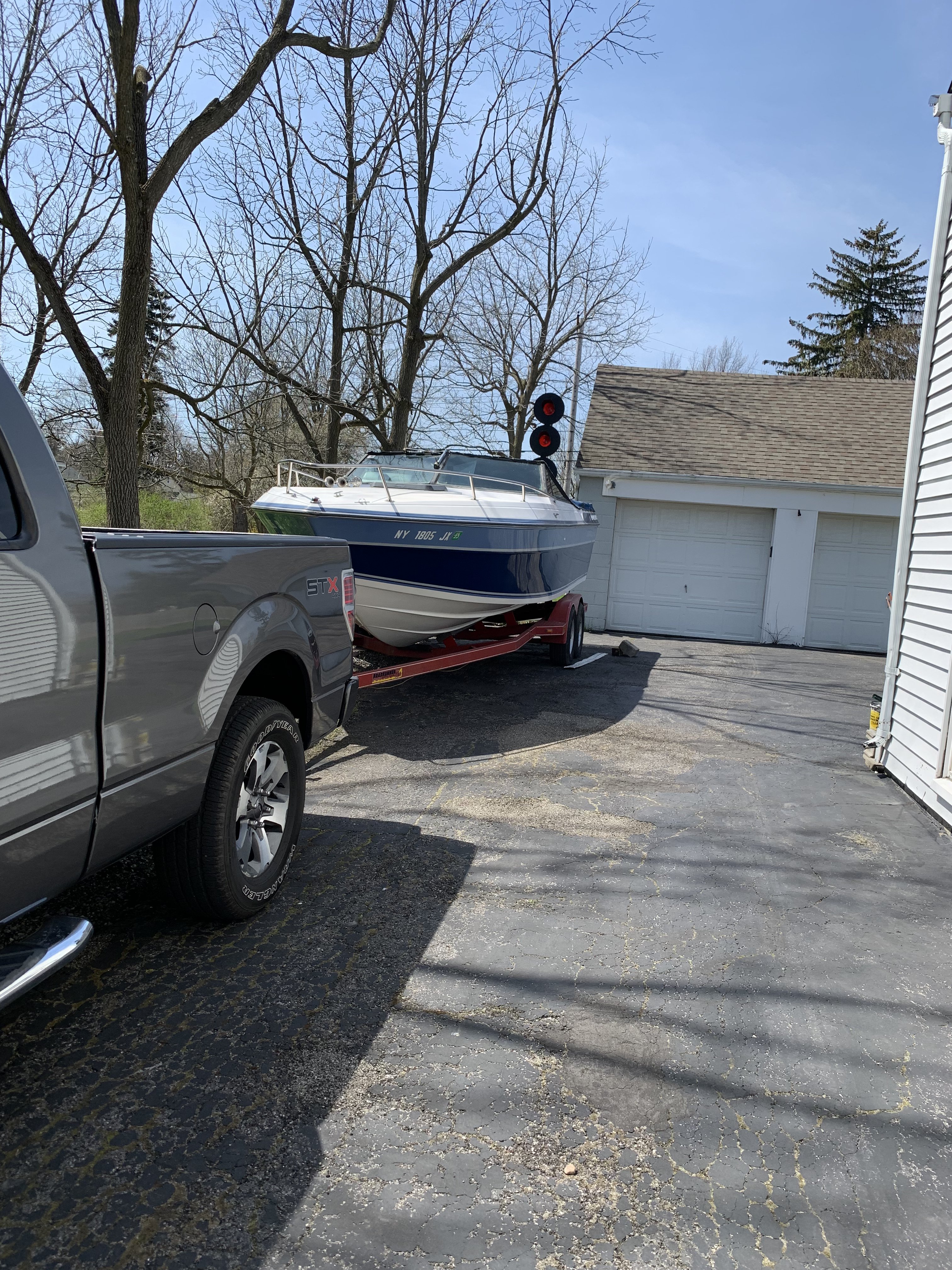

Home:

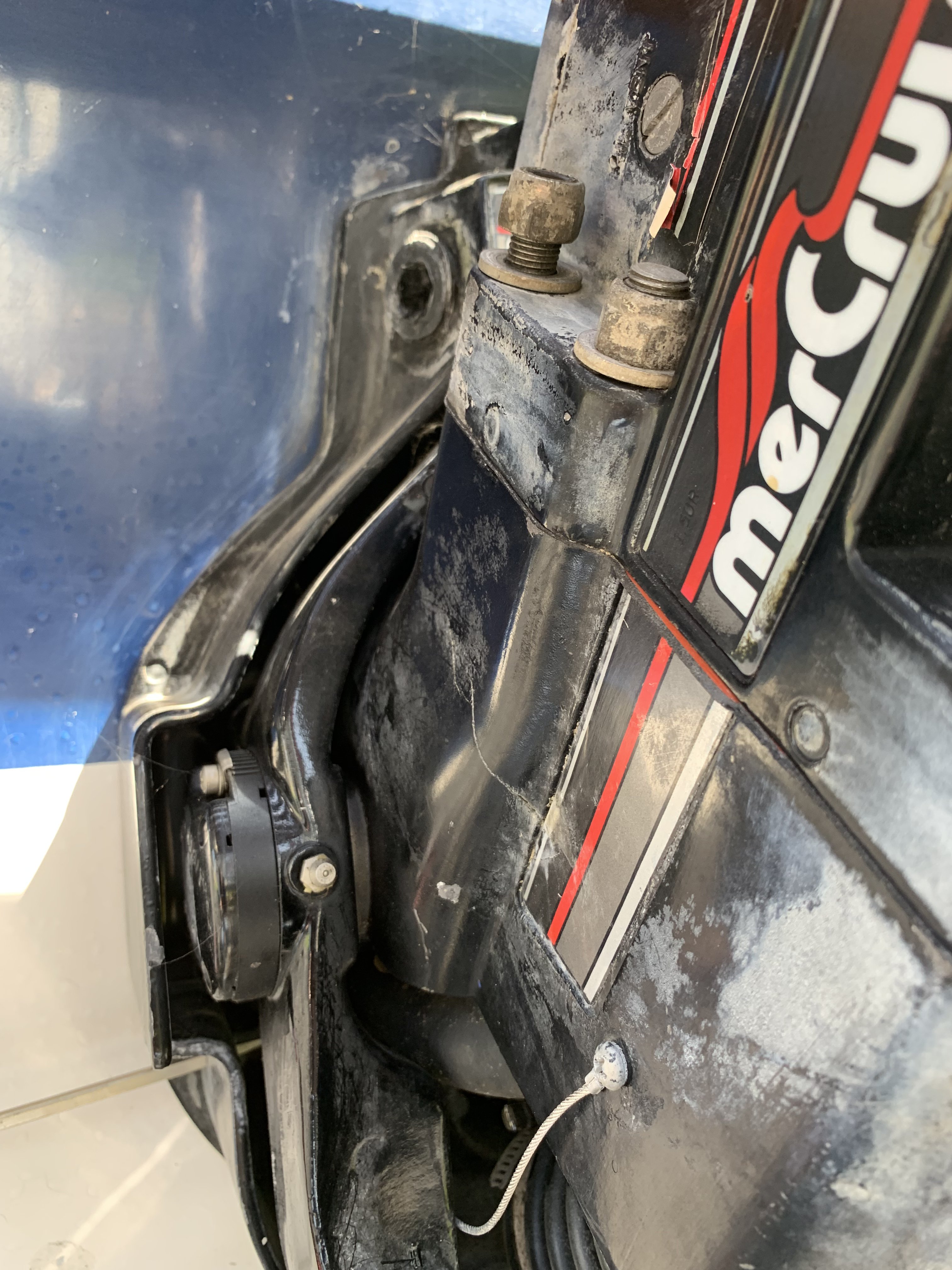

Well, as I put the drain plug back in I see the exhaust bellow has fallen off. As I’m trying to re-attach it I see one of the upper drive bolts is coming loose. I wonder what else I’m going to find.
What is the amount of torque to tighten this nut?
Also couldn’t get the bellow back on. Turns out screw on the clamp is worn and I couldn’t tighten it. Screwdriver kept slipping off. Not even sure the whole bellow had slid all the way forward with the drive full down.

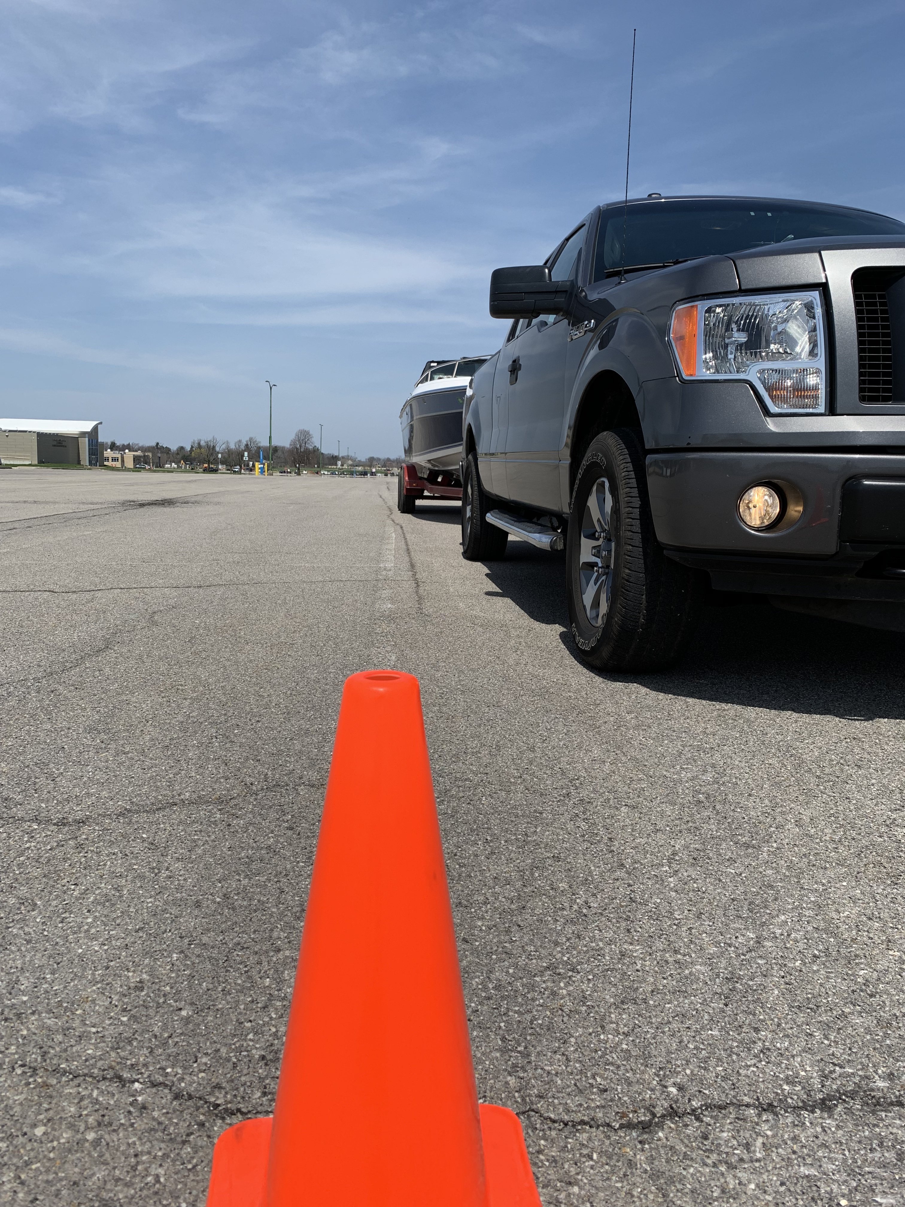

I too am going to do some backing up practice, the older I get the less accurate I get.

Judging from what you say, and what the photo shows, I would take a serious look at that outdrove.
She still is looking good:), better then most her age.
Thanks. I text my mechanic and waiting for a reply. This really bugs me because I simply cannot understand how I missed this. At the end of 2020 I scrubbed the haul and outdrive before storage. Taking a sponge to clean the drive…..and not see the loose nut? It never ran last year and sat in my driveway. Even then I was always looking at it.

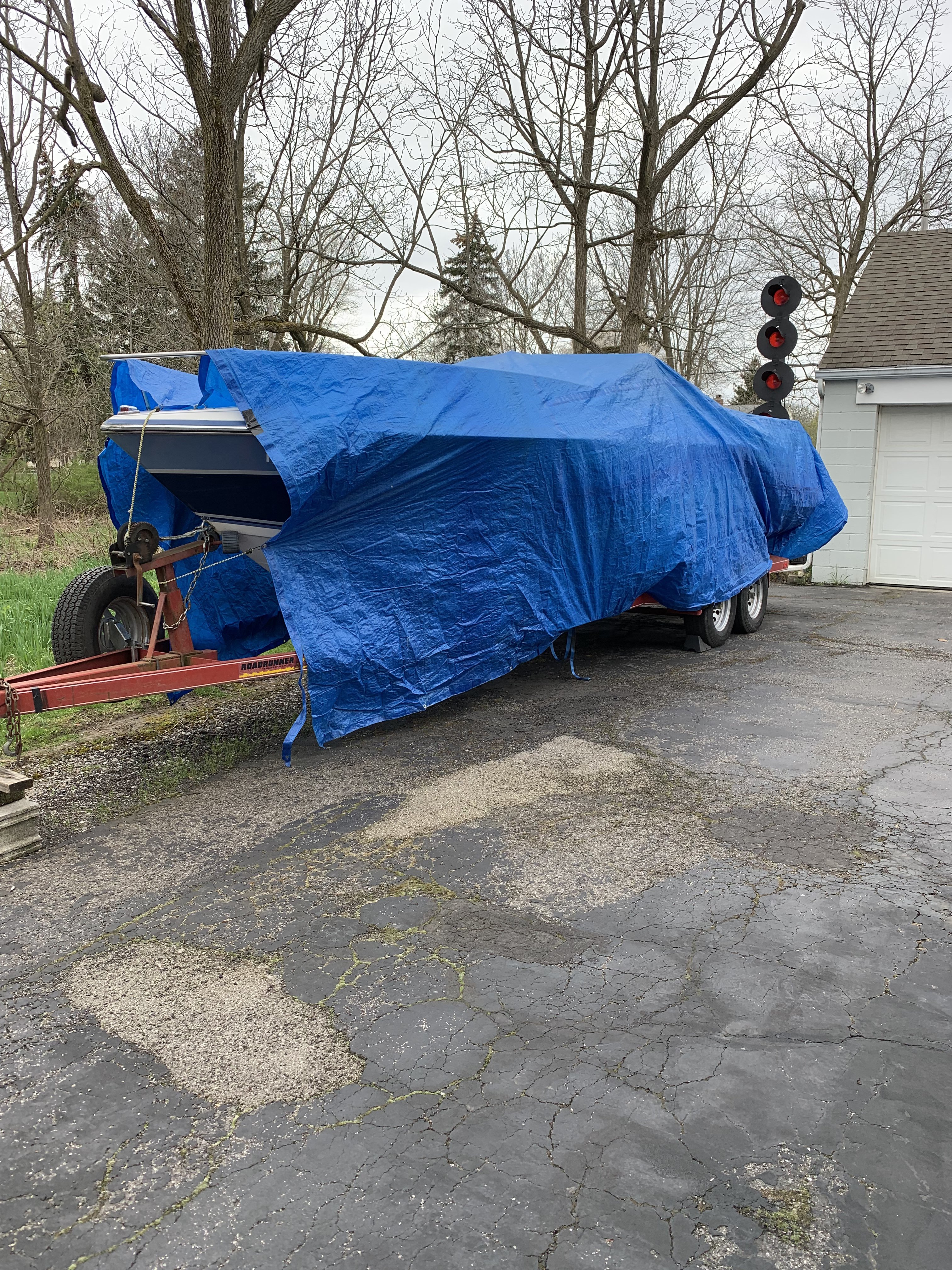

But, he told me not to bother bringing the boat to the shop for at least a couple of weeks. He is backlogged with repairs from last year. Reason being, shortage of parts. But not because of China. he says many of the parts needed are made in the US but due to lack of people wanting to work, it has created a shortage. So me and many other will face delays. But at least I’m on the wait list. Seeing as how it’s not going anywhere, I put the tarp on even tho the Fab303 still repelled tons of rain last night.
A lot of people don't go in the water until Memorial Day, so you should be ok. Putting the tarp on her, will slow down the fading action.

These days I am a left mirror backerupper period. Have a very hard time judging the space between the dock and my girl using the right mirror, I can do it, but I'm just not comfortable with it, and it takes somewhat longer.
I am the same way with tight right mirror movement. That’s why I bought the cone to practice in a large forgiving parking lot. It helps.
