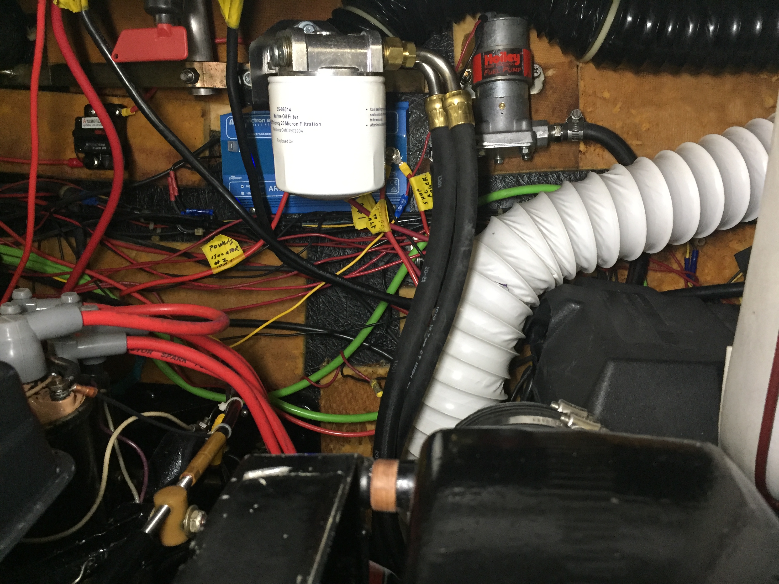

My girl is setting on her trailer in her room, with her out drive off. At the beginning of this year's layup, I added a remote oil filter, and rewired a new isolator.
I would like to test both. Test the remote oil filter for any leaks, and to make sure that the amp gauge is working and reading properly.

Open, I am only going to run it for about 1 minute, enough to get the oil pressure up. I figure if I shut her down before the thermostat opens up, I will not loose that much antifreeze.

Well, Iggy must not have found the answer we were looking for, so I thought the worst that could happen would be to get pink antifreeze al over my floor.
I lit her up, got her up to about 120 degrees, no antifreeze coming out. Oil pressure went up, and no leaks, and the amp gauge is working properly.
Then I thought about past experiences when my car thermostat was stuck open, (no heat) and when it was stuck closed, (would boil over).
So being that the stat had not reached it's opening temp, it was considered (stuck shut).
It was a win-win, no mess, and the testing was all positive.
Now it is on to finishing up putting in the new impeller.
I am kind-of looking forward to next fall when I will be able to change the oil filter on it's remote. ( Nah) lots of good weather and boating 1st.

Ya, that was a Mercruiser remote, besides being a dumb design with the filer up side down, it is very expensive too.
I found this one, high quality, and it is made right here in America. ( great customer service)
And unless I drop the plastic bag, there should be no mess to clean up. lol
