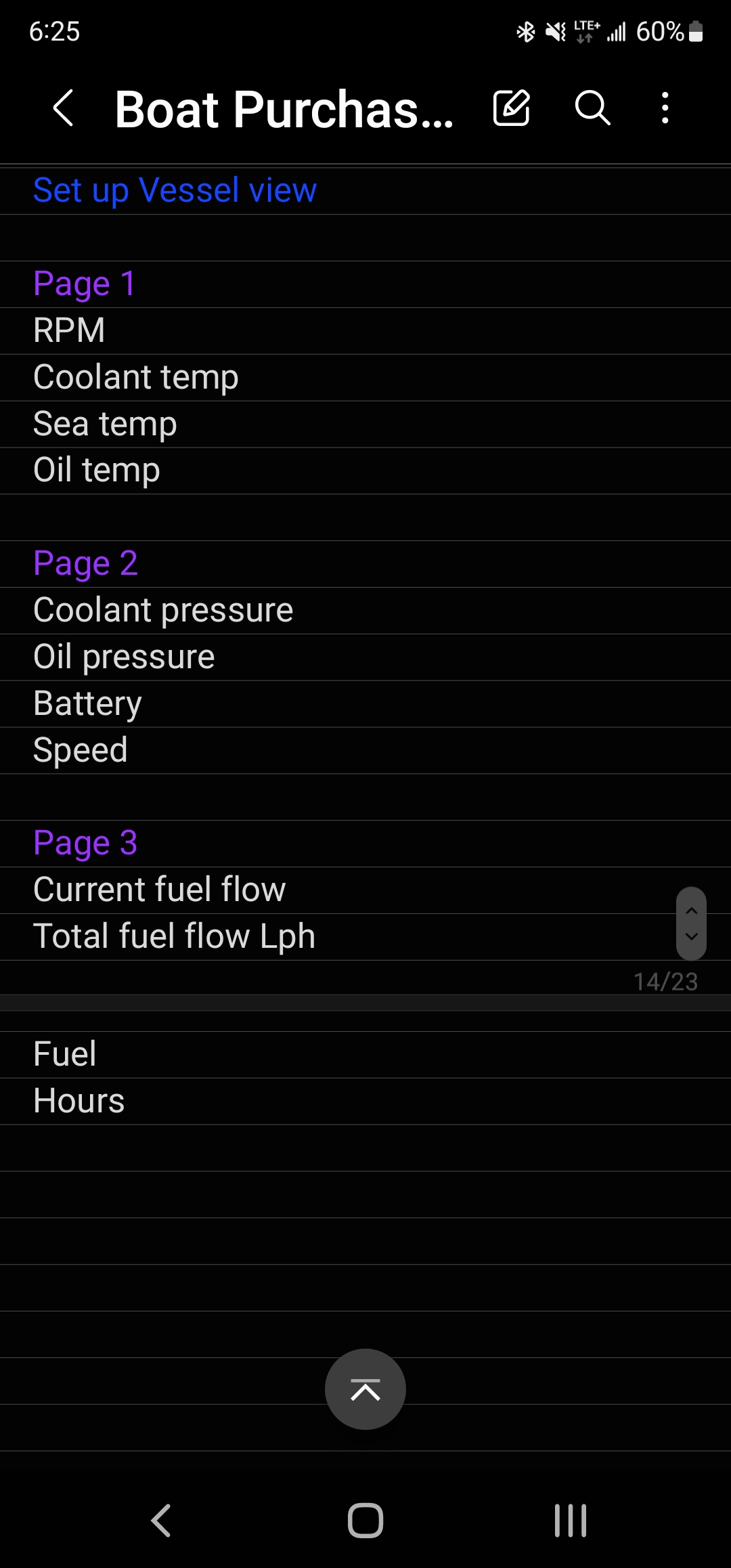

This is how I setup my pages

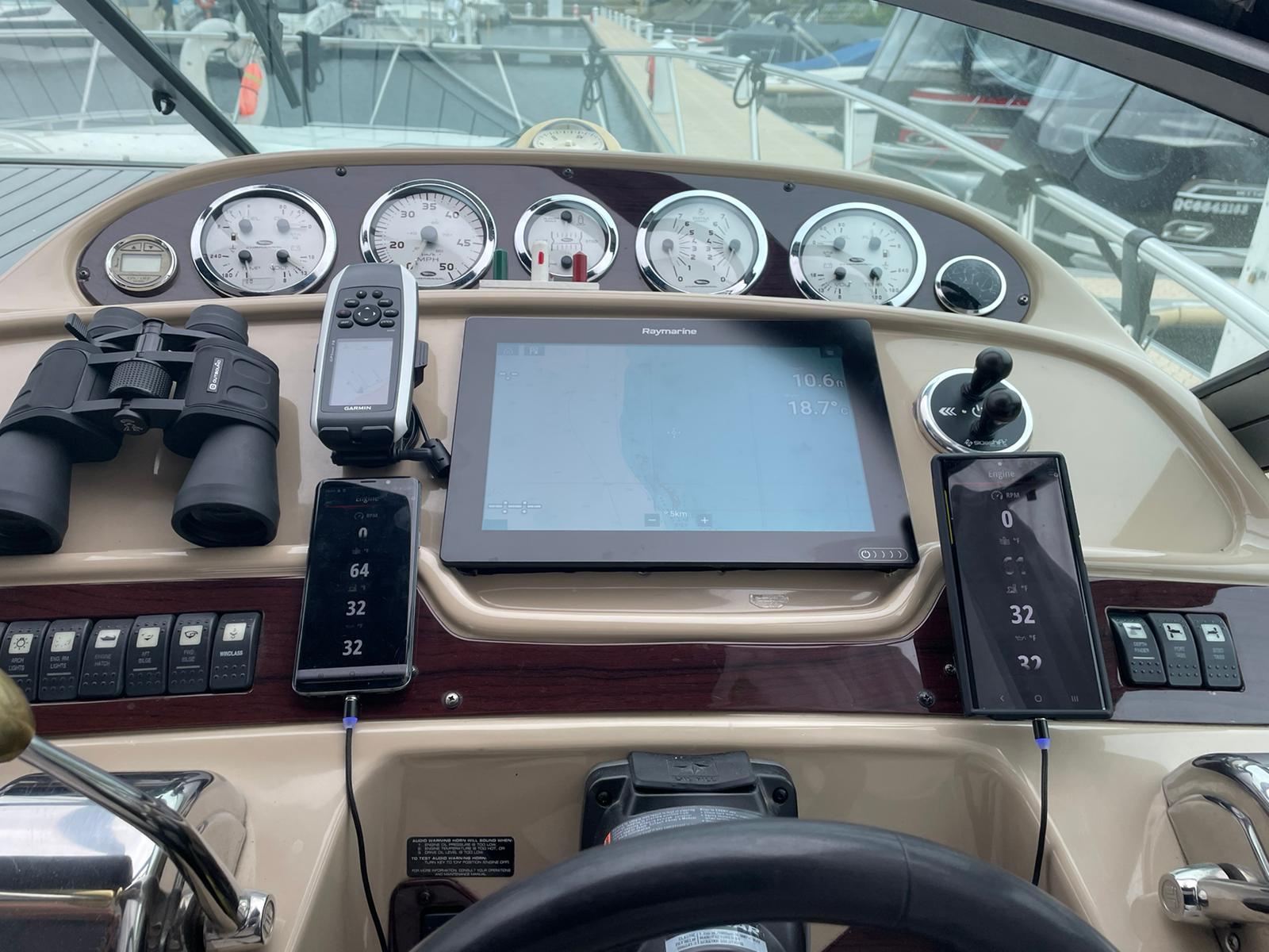

My set up, two units, one on each engine. Displayed on two Samsung phones.
Love it, works great
