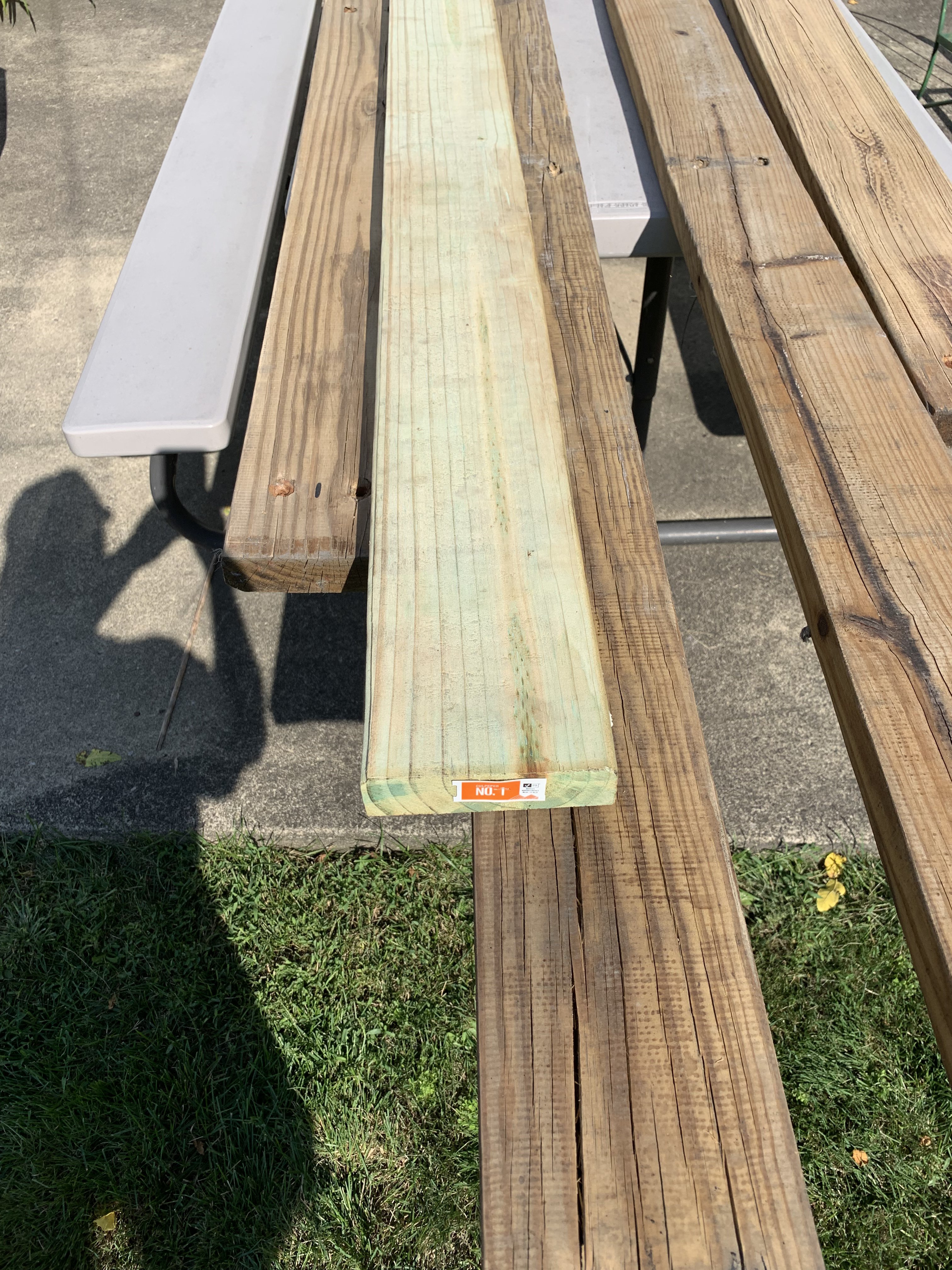

New vs old:
If it were me I would go for new. Are you going to cover all the wood, or just where the boat rests?

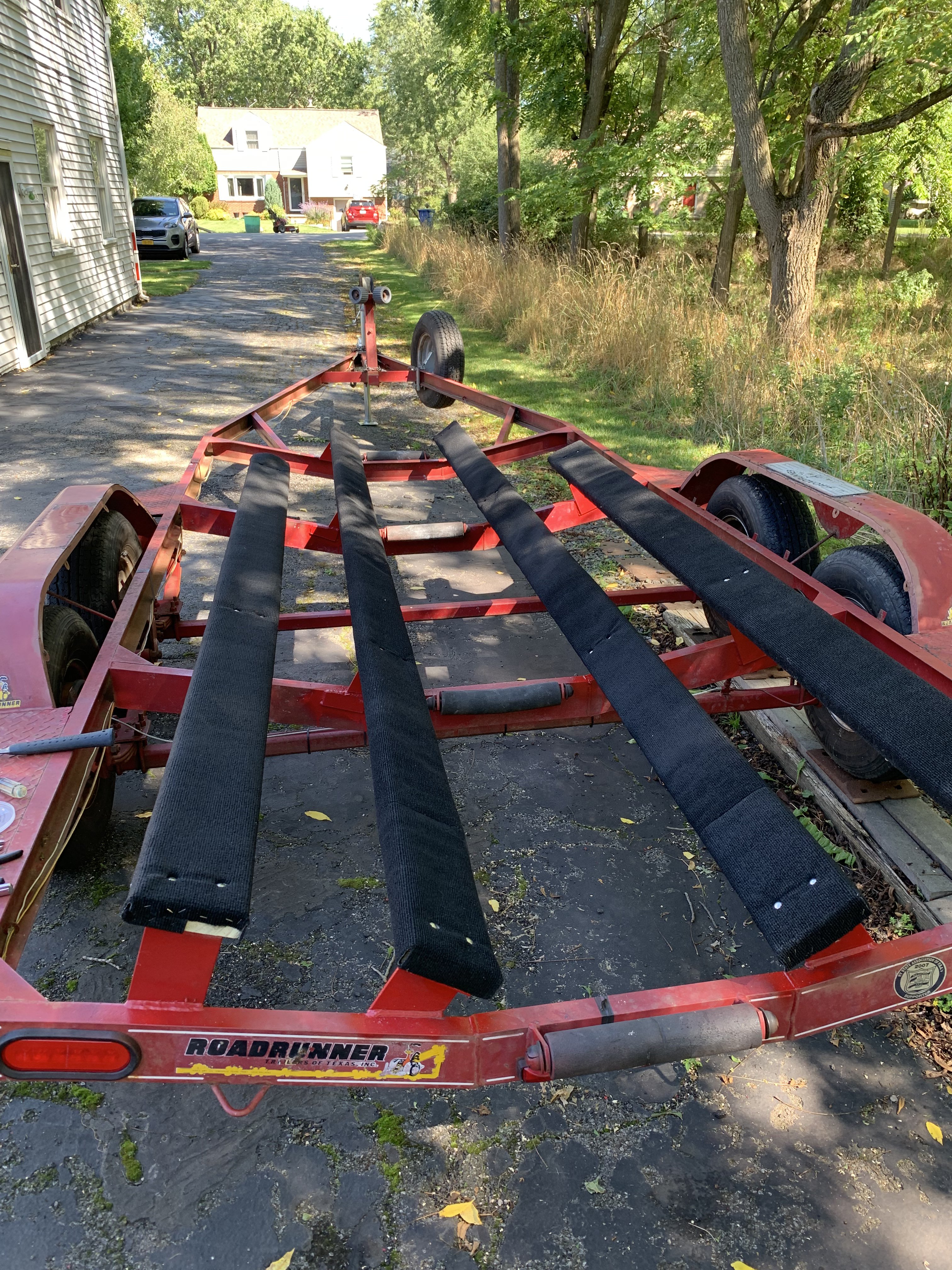

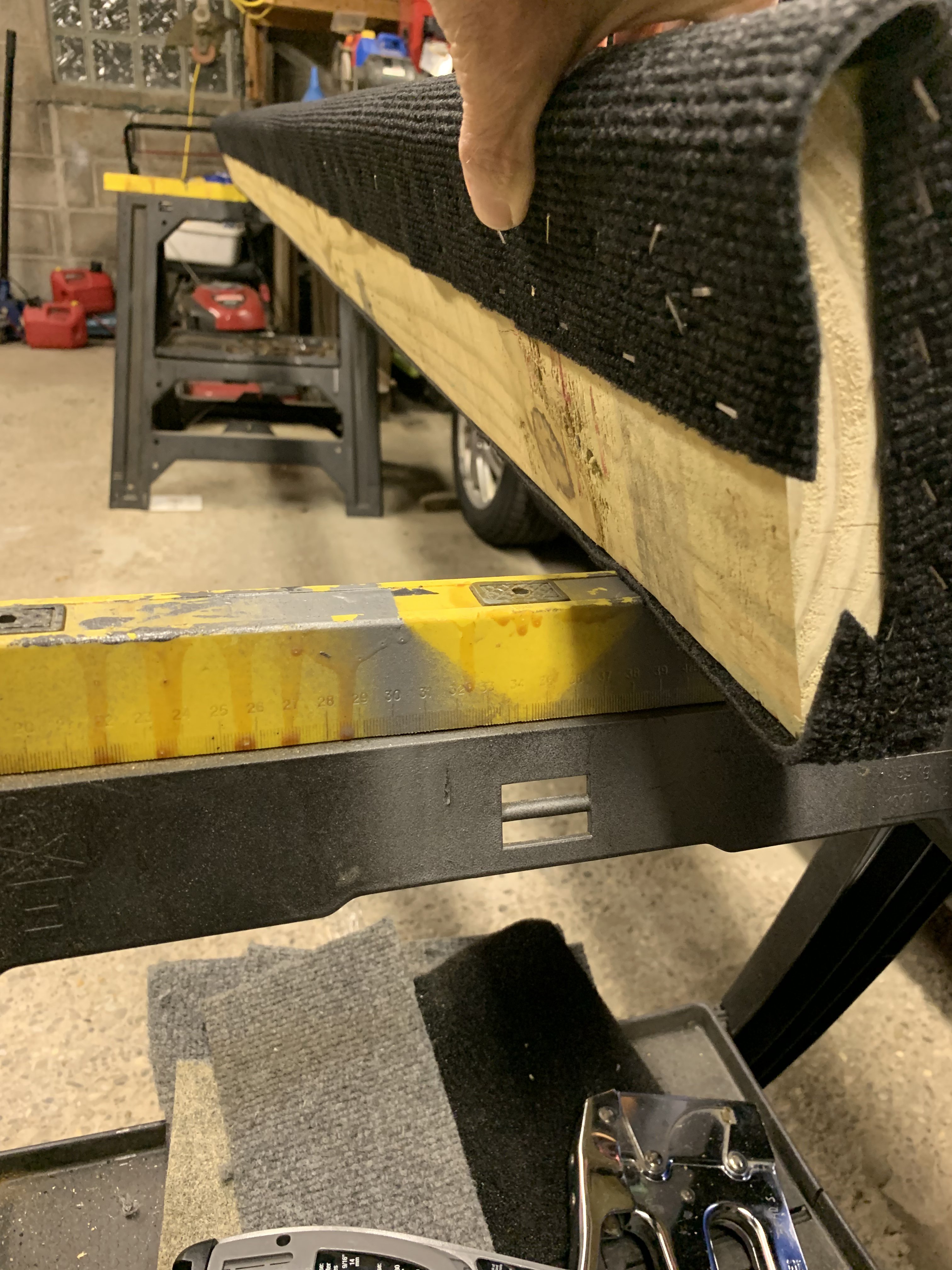

Finished. Last night I stabled the carpet with stainless steel staples. You can see how I placed the carpet on the board so as any moisture will be pulled down by gravity and easily drain off.
The bottom of the exposed area
is the lowest point.
Today I mounted them back onto the frame. Most of the bolts lined up fairly well only needing a random tap of the hammer. 14 more years.
