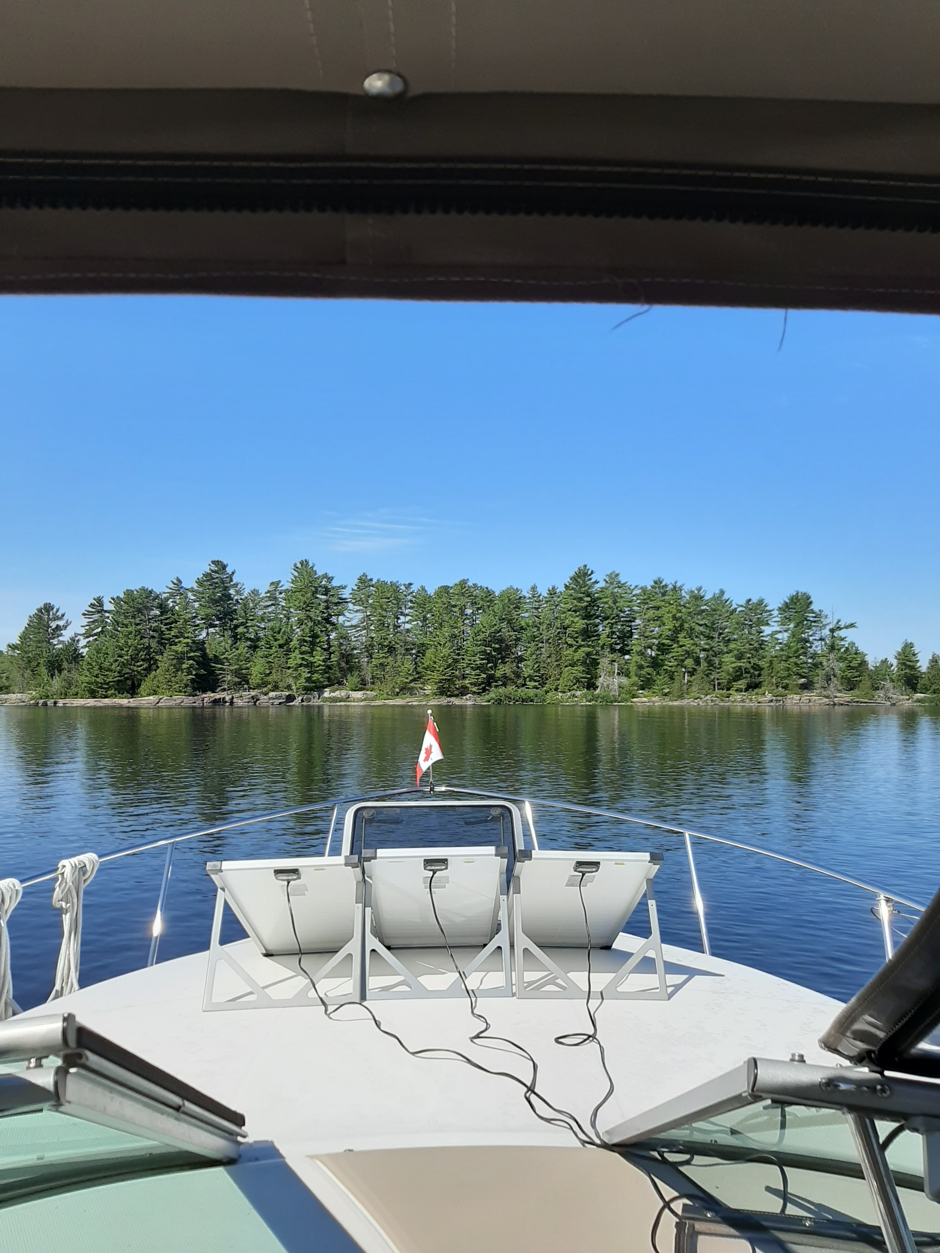

Since our docks don't have shore power, this is how we keep the 2 starting and 1 deep cycle house battery charged. Each panel is a 40w unit that sits on the bow and charges them all week when we're not at the boat. I string a rope through the feet and tie them off against the railing to prevent them from falling into the water if the weather picks up when we are not there. This image was taken at anchor when we were out for the weekend.
By using them while at anchor I find that it doesn't charge the batteries up but it does prevent them from draining too much while we use them. I bought 25' extension cords from Amazon that let me reach all the way back to the "trunk" where I installed the battery connections and charge controllers. They are also small enough to store nicely in the trunk.

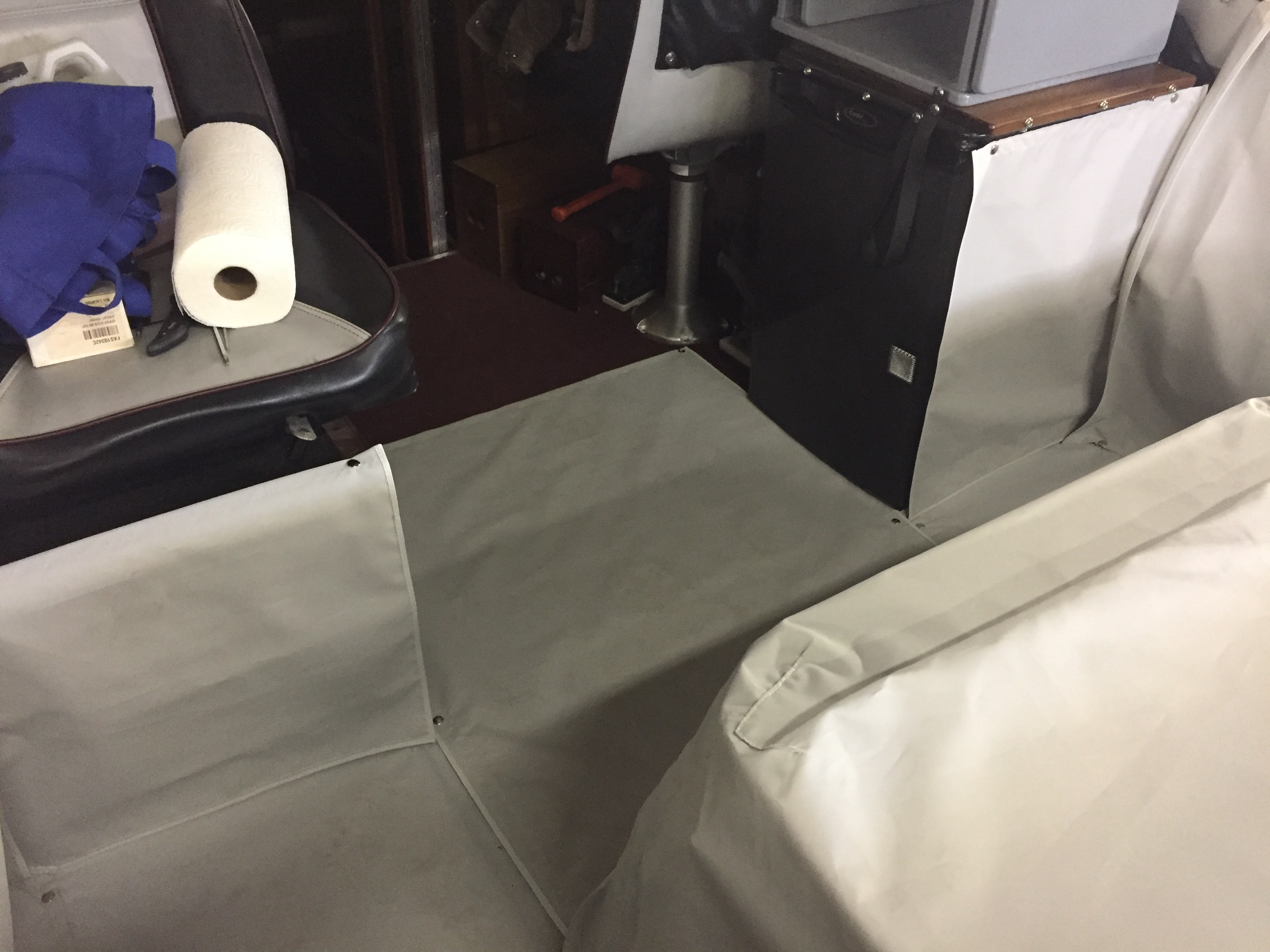

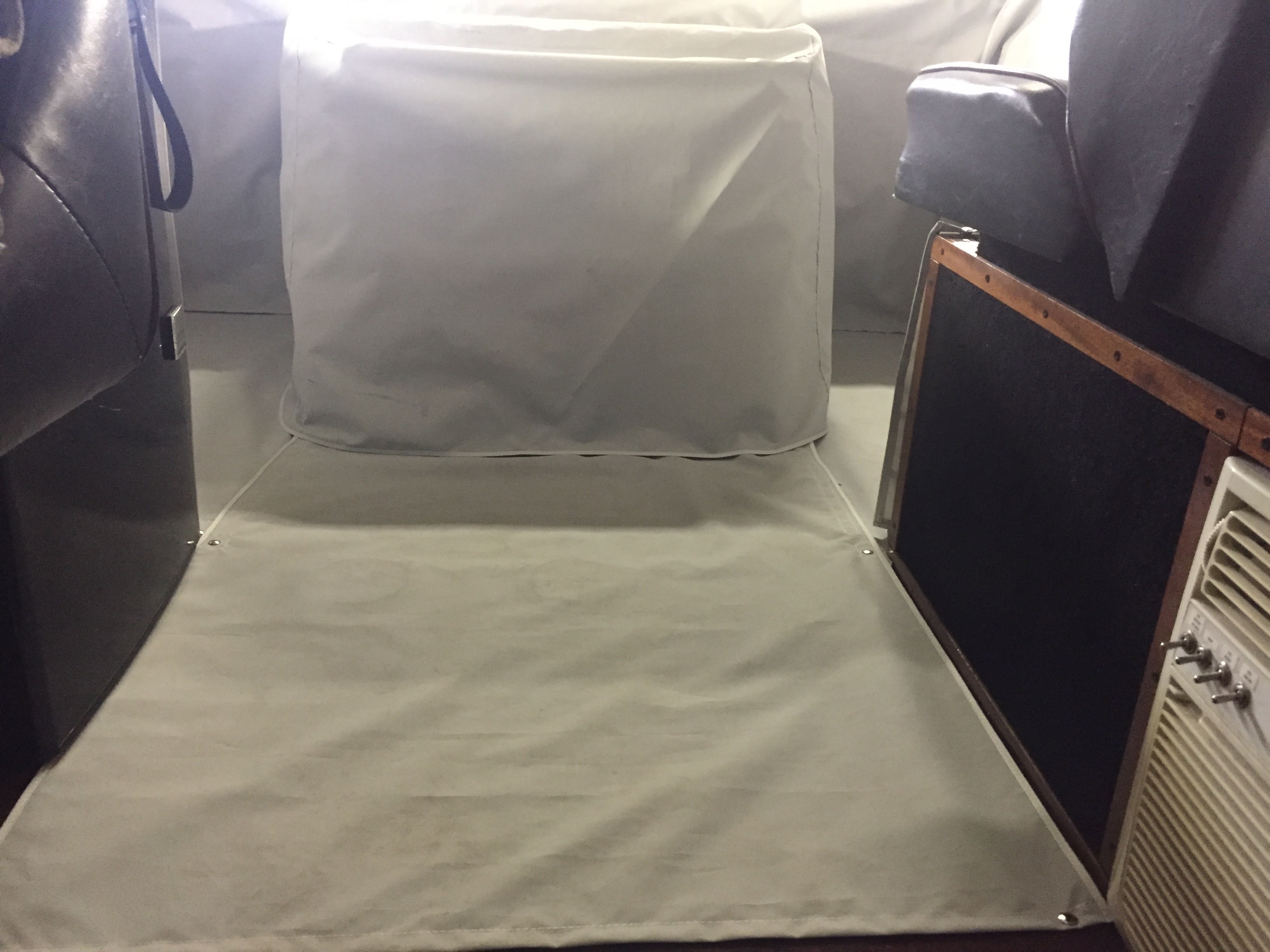

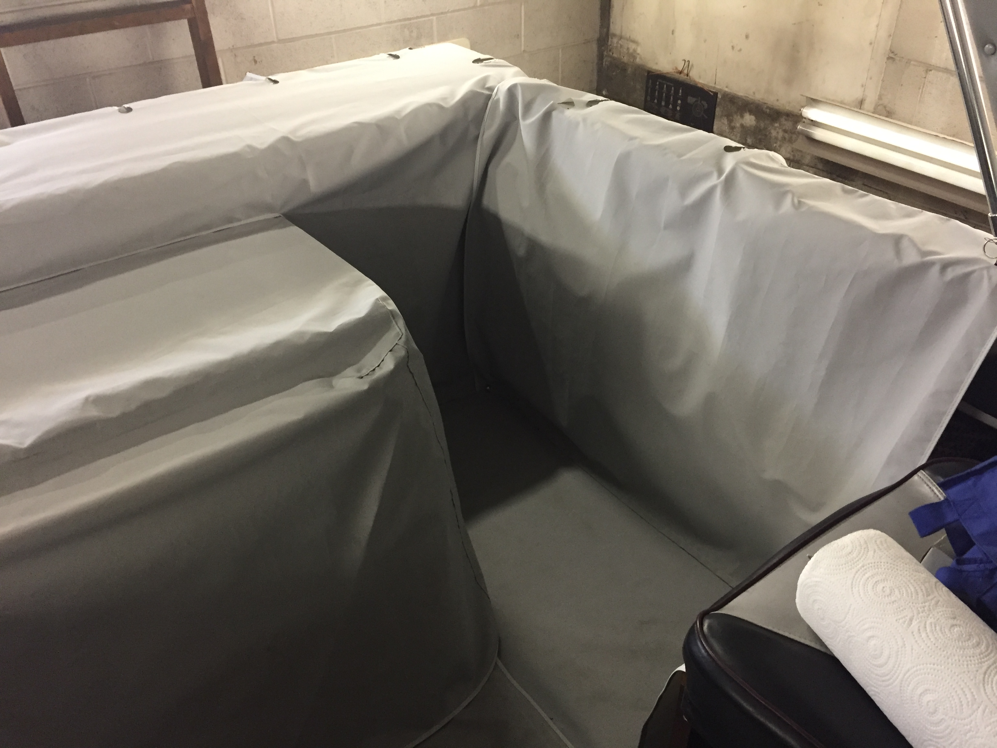

Newest addition to keep my girl clean. When we go fishing, there is always a mess to clean up, and there is nothing harder to remove then fish scales. So I designed and installed panels that snap in. I can take them out, lay them on the ground and hose them off. And now my girl doesn't smell like fish.

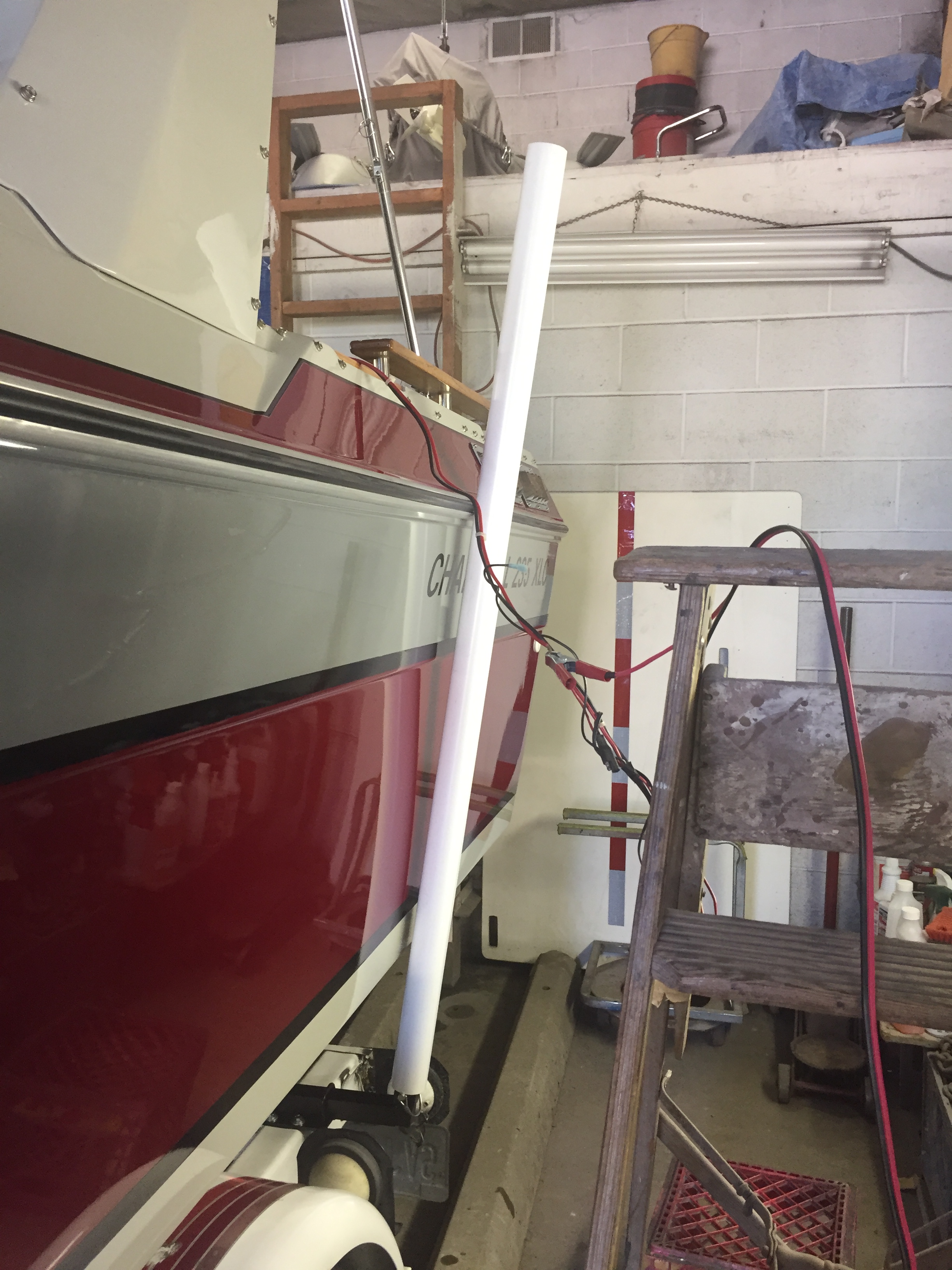

While talking with Doc, It reminded me of an other addition, to make it easier to retrieve my girl.

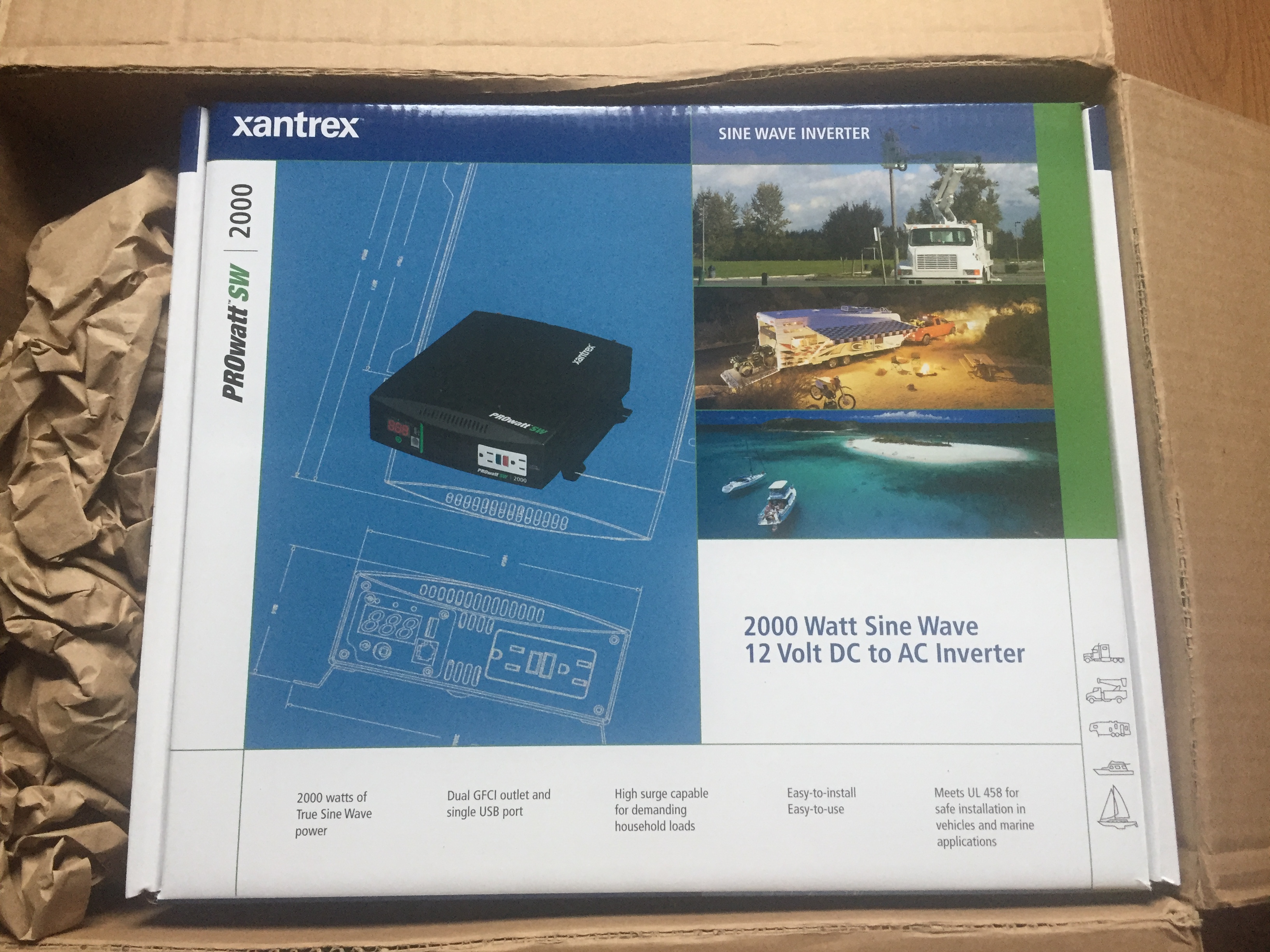

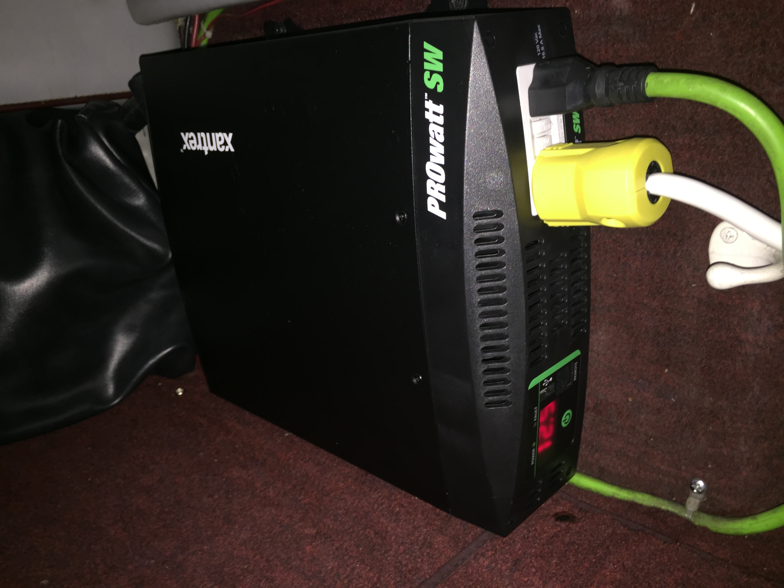

Well, after 30 yrs of service , my girl's power inverter finally bit the dust, so I got her another one.
Looks like a good replacement.
I'm curious what you use the power inverter for? I have a very small one but have never had reason to use it.
I use it to run my microwave, and small George Forman grille, (one at a time) also sometimes my refrigerator when needed. And a couple of other small 110V items once in a while. No more ice and cooler, and grille and propane.
The one I had before was an Xantrex, they make a good product. I like it for cooking something hot when out on the hook. Especially when out fishing in the fall.
How big is yours, and why did you get it?
I bought a small one off of one of those daily deal sites. We were getting ready for an extended trip out west with the possiblity of sleeping in the SUV and I thought I might find a need for it. As it turned out we never stayed in the SUV overnight and I never needed to run anything on it. I was afraid of how much pull it would do on the battery. If you can run a grill and microwave long enough to cook with one and still have enough to start your engine that is awesome. Good to know.
