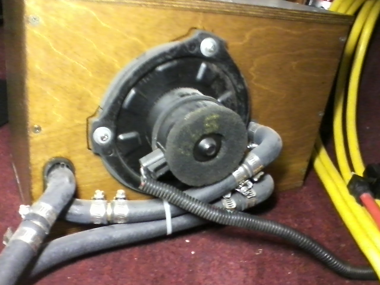

In the past I have boated on some very uncomfortable cool late nights. I ran across an article that advertised a heater for wake board boaters (etc) that ran off of the engine hot water. So I checked into it. I liked the idea; however the heater box they offered would not disperse the air in the way that would be efficient for my needs. They sold me the hardware without the box, and I designed my own. I put 2 car heater cores in it, which gave my more volume then theirs, and an automotive squirrel cage type circulating fan. One vent is aimed up at the helm seat, and the other 2 to the port side. So there is a wall of warm air coming up in the front of the cock pit area, just enough to take the chill off, kind of like riding in a convertible with the top down and the heater on. With the bimini and front curtains up it is real toastie.

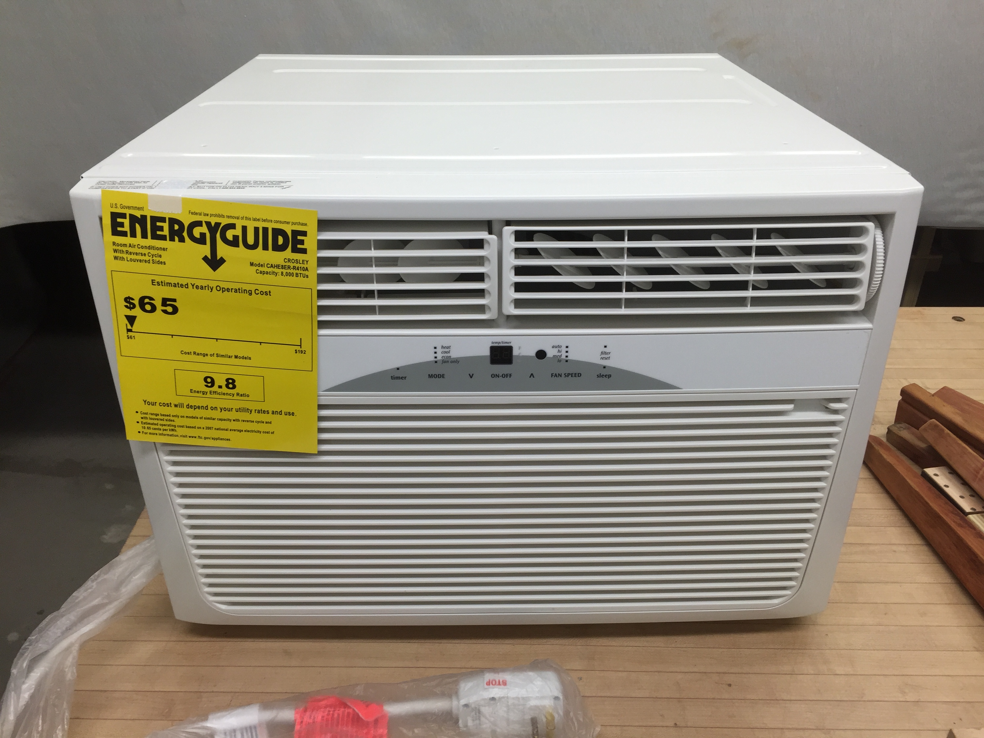

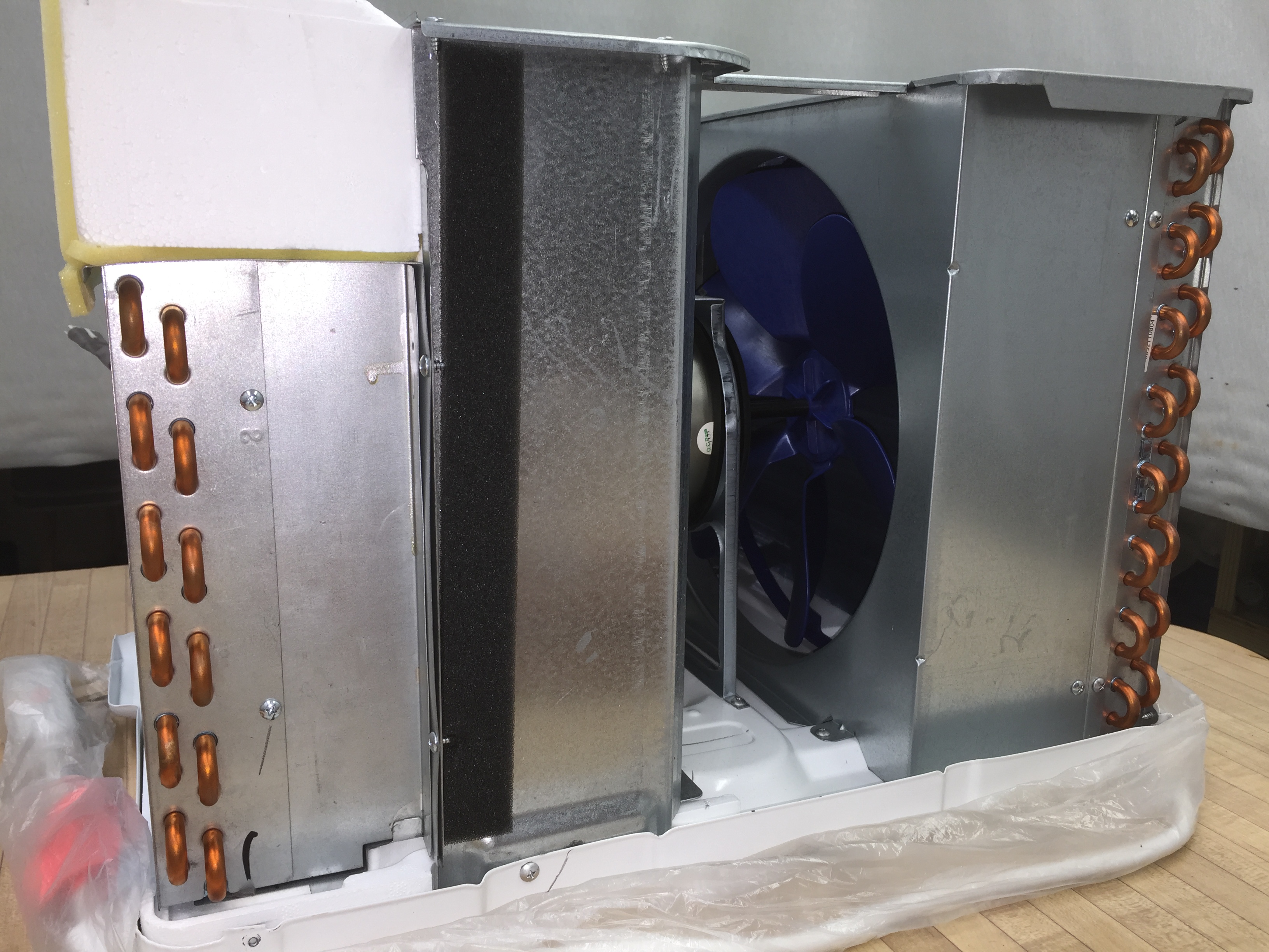

Small quiz, for those who might want to participate in figuring out what I needed to do to be able to install a home heater & A/C in my girl. I know that there are some of you that have the answers, it would be neat to see how many.
Just something to help pass the winter for those that have to wait for the ice to melt.

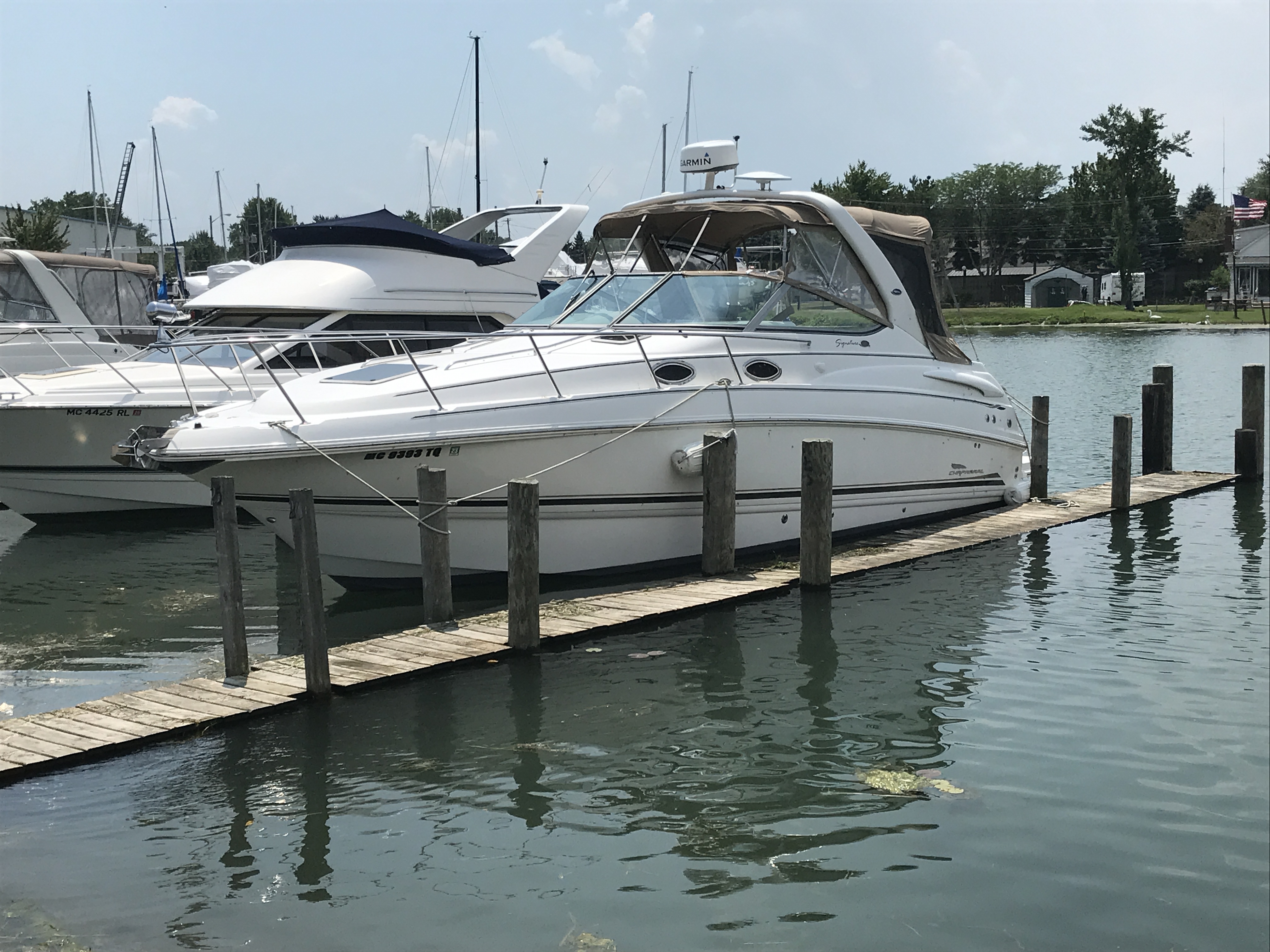

Seeing as how you don't have a slip, I therefore assume you'll be inserting this into the boat somewhere. The biggest challenge I see is getting the heated air out of the boat.
Modify your boat cover so that the unit can be place through it. Construct a portable stand [anchorable to the deck] and place the a/c unit on the stand such that the unit fits through the cover's modification [Velcro flap]. This will allow the hot air to be vented overboard and the cold air stays inside. I see this as the least way of modifying the boat or the a/c unit [Drilling holes, running wires and hoses]. But looking at various pictures of your boat, you like to be creative!

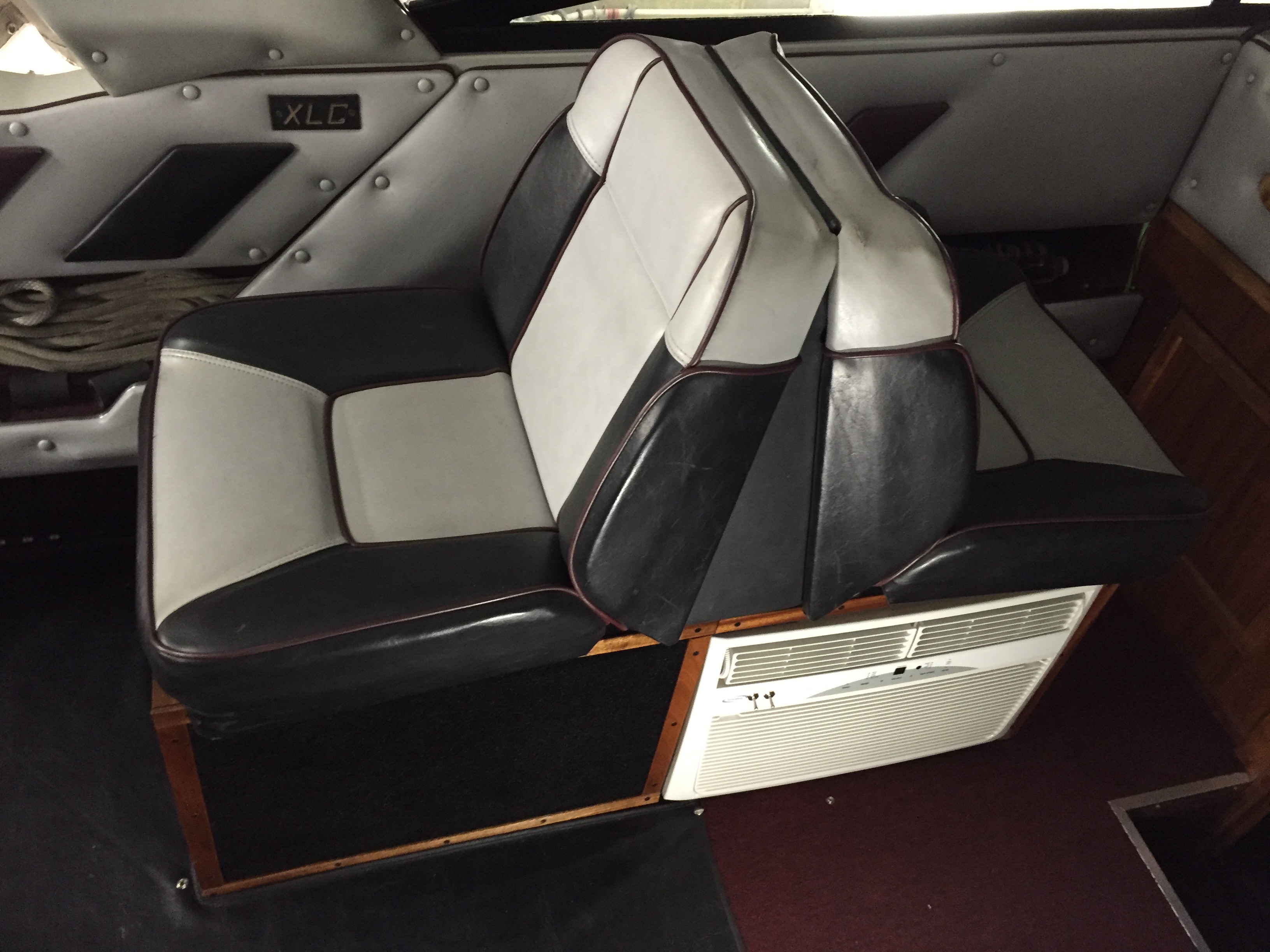

Her e is another part to the puzzle. I can operate the unit while out on the hook with my Honda 2000 generator.

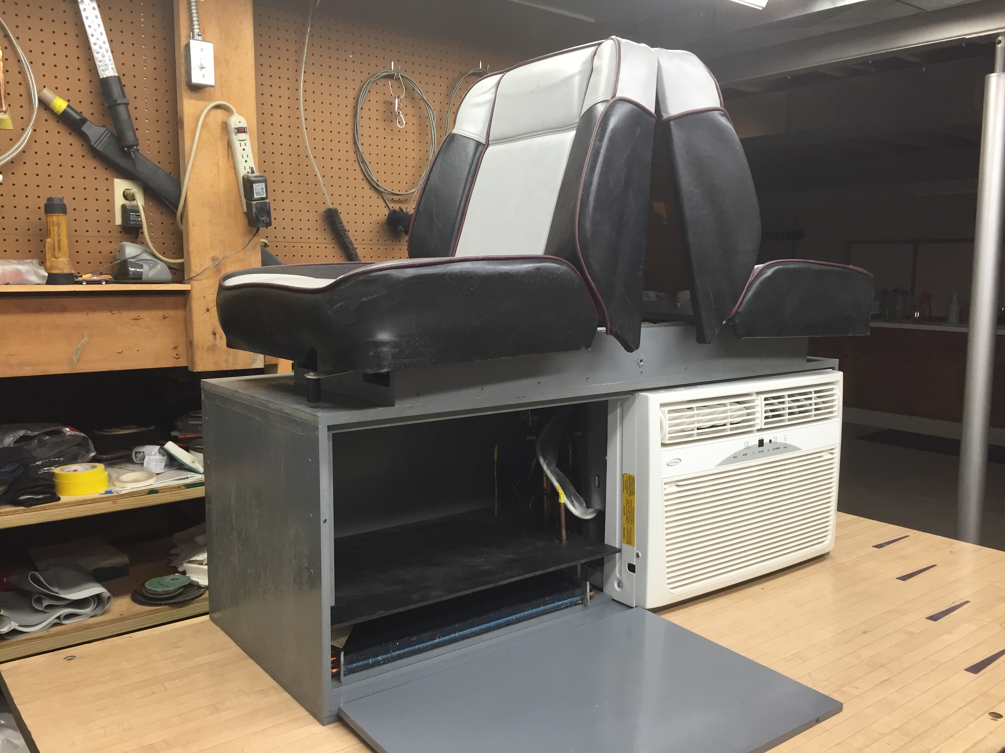

Here is where it is mounted.

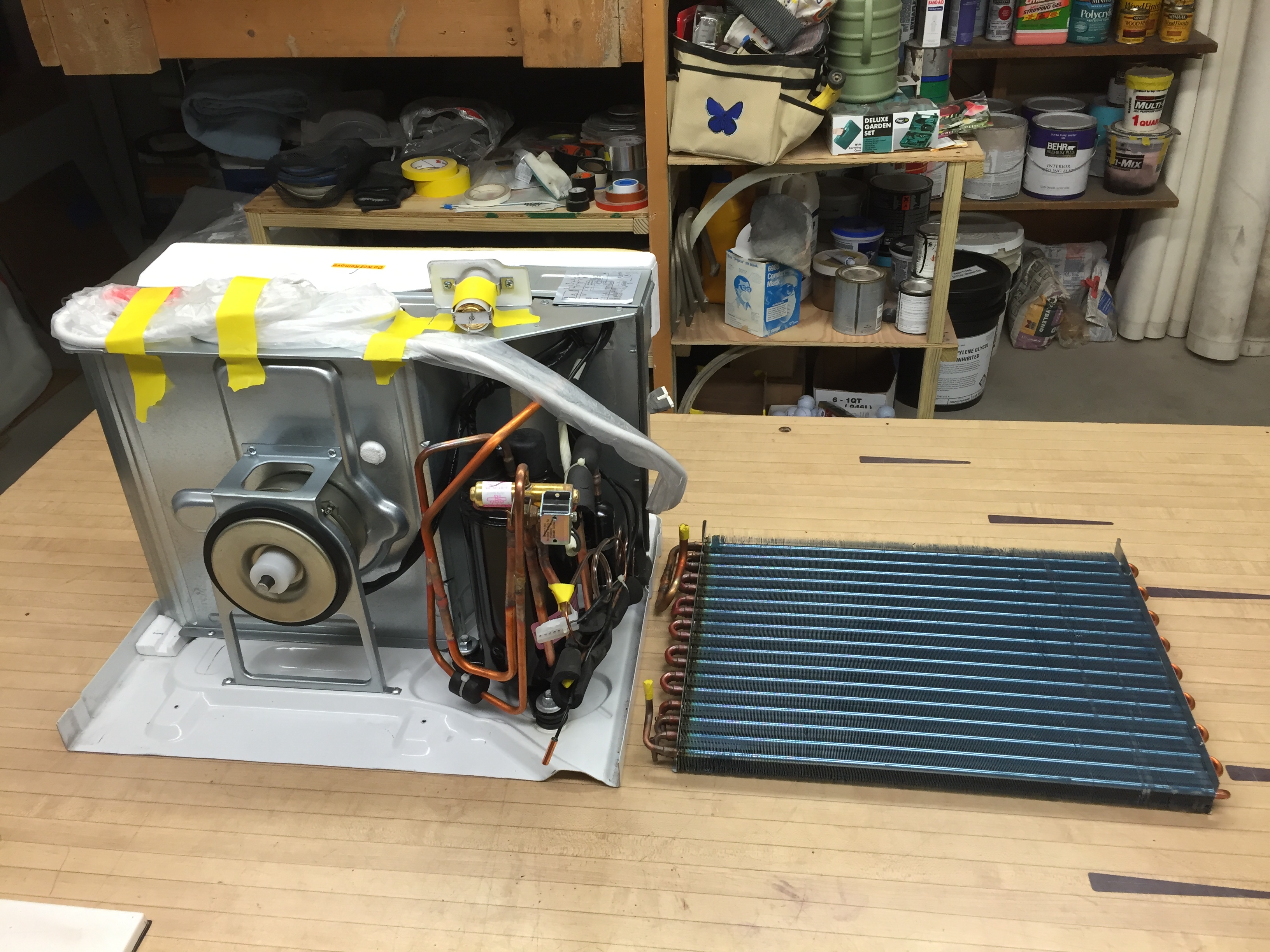

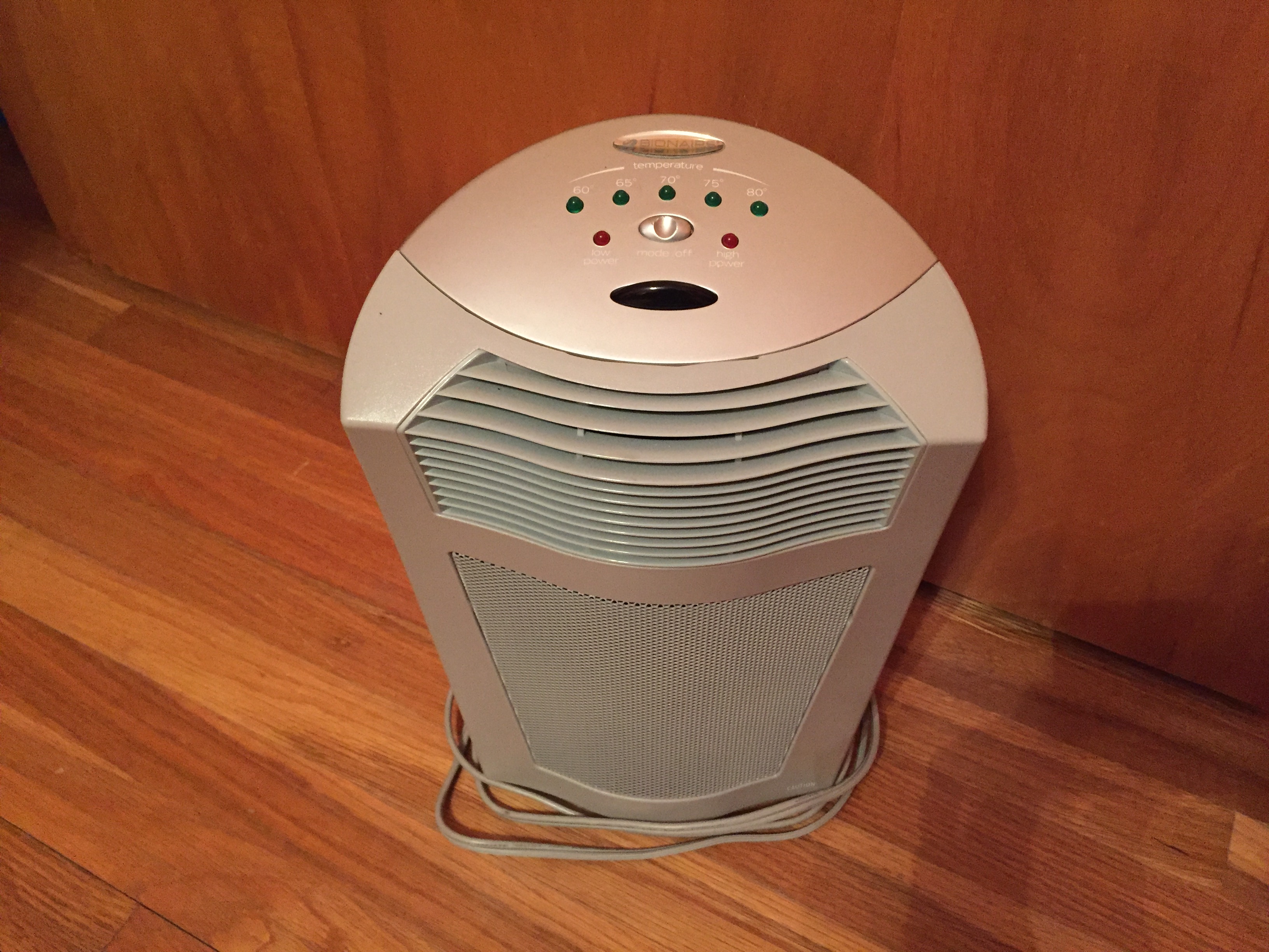

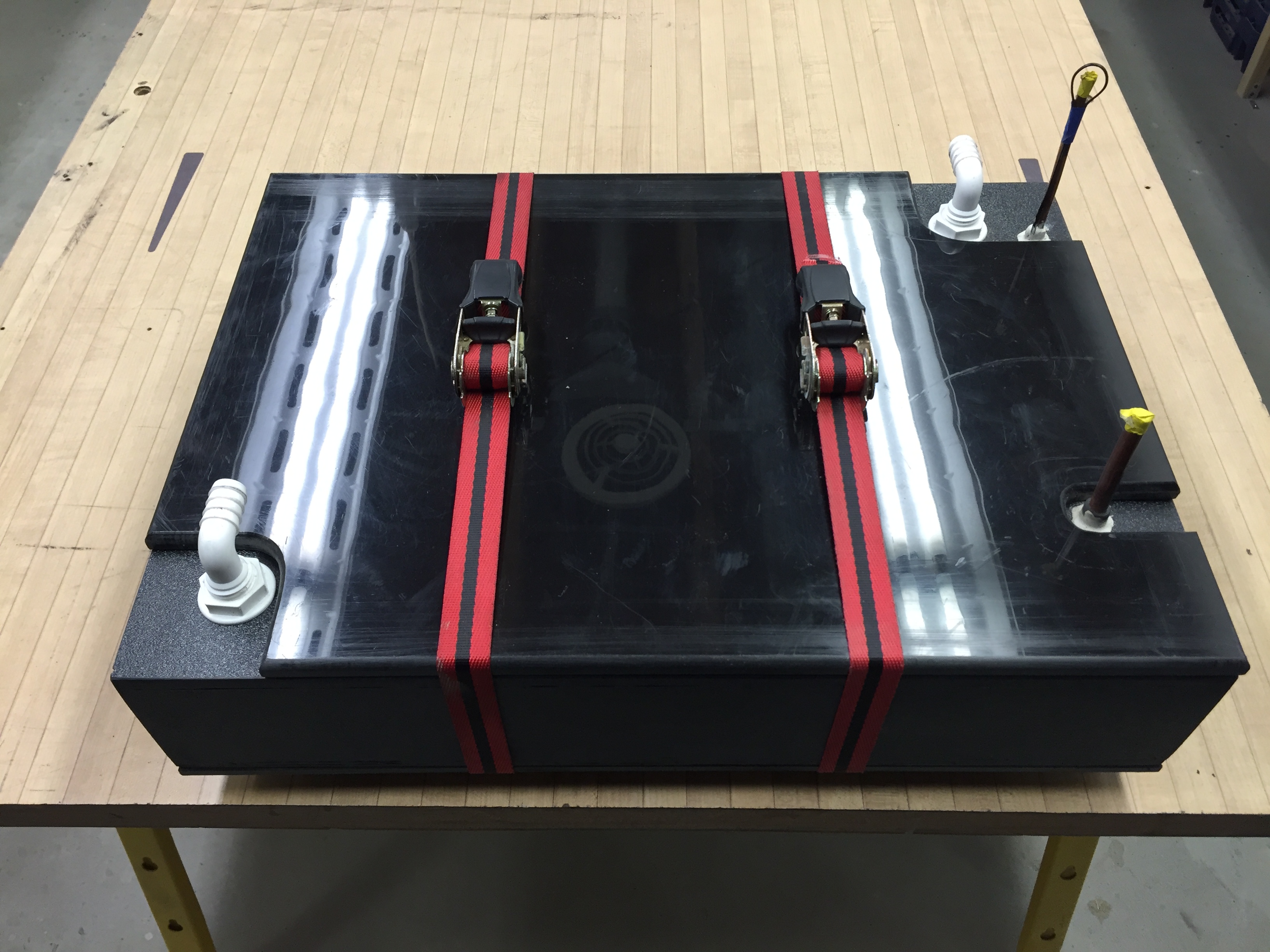

For most of the years I had this portable heater. I then got the idea of having one that was permanent. I was not looking to put in A/C, but it was a dual purpose unit. So with a winter of experimentation, advice, and help I was able to put it together. The whole thing in a nut shell was to, remove the rear condenser, build a new box to put the back to back seats on, build a box to put the rear condenser in, seal it, and pump sea water through the box, to either cool it down or warm it up. With my 2 heater arrangements, I have added 2 more months to my boating season. At 45 degrees out and using this top configuration for fishing, we are very comfortable at 70 degrees inside.

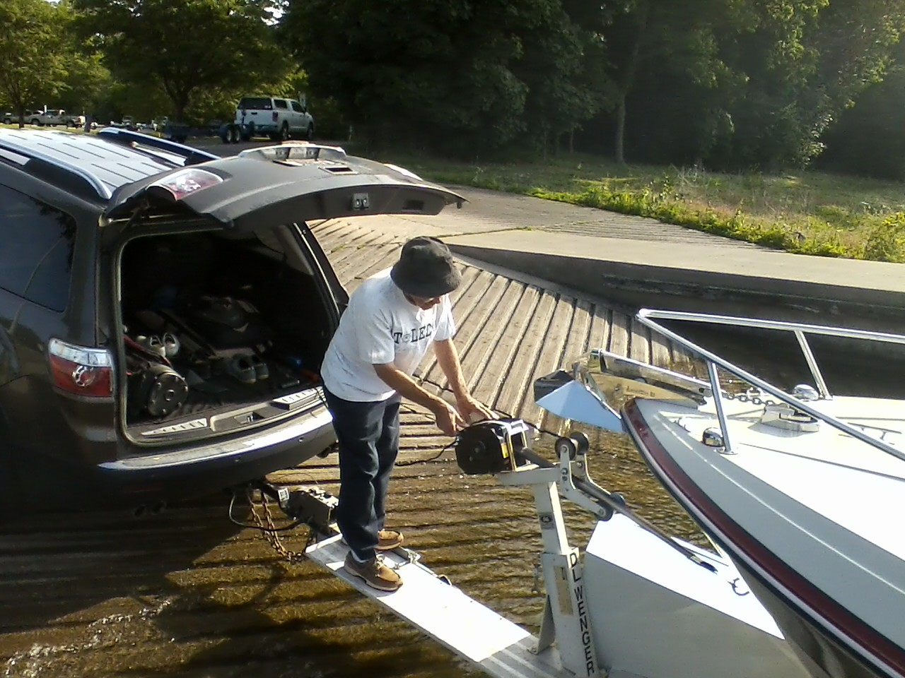

Back in my early days I could walk the tongue of my trailer with ease, but as I got older I was not so sure footed. So I added a platform. I have never had to walk in the water to launch or retrieve any of my boats.
Also as years went on it was becoming harder and harder for me to turn the winch handle, so I added an electric winch.
Being that I haven't achieved the ability to walk on water [Happy Easter to all] I still have to walk in it. If I'm on my own, I walk in the water to launch and retrieve. If somebody is with me, I can unhook the winch before backing down the ramp [bunks, not rollers] and float the boat while somebody else holds the lines. So far, I don't mind getting my feet wet and I still have the ability to winch. Although, this year, I need to get back to the gym to be prepped to handle the boat.

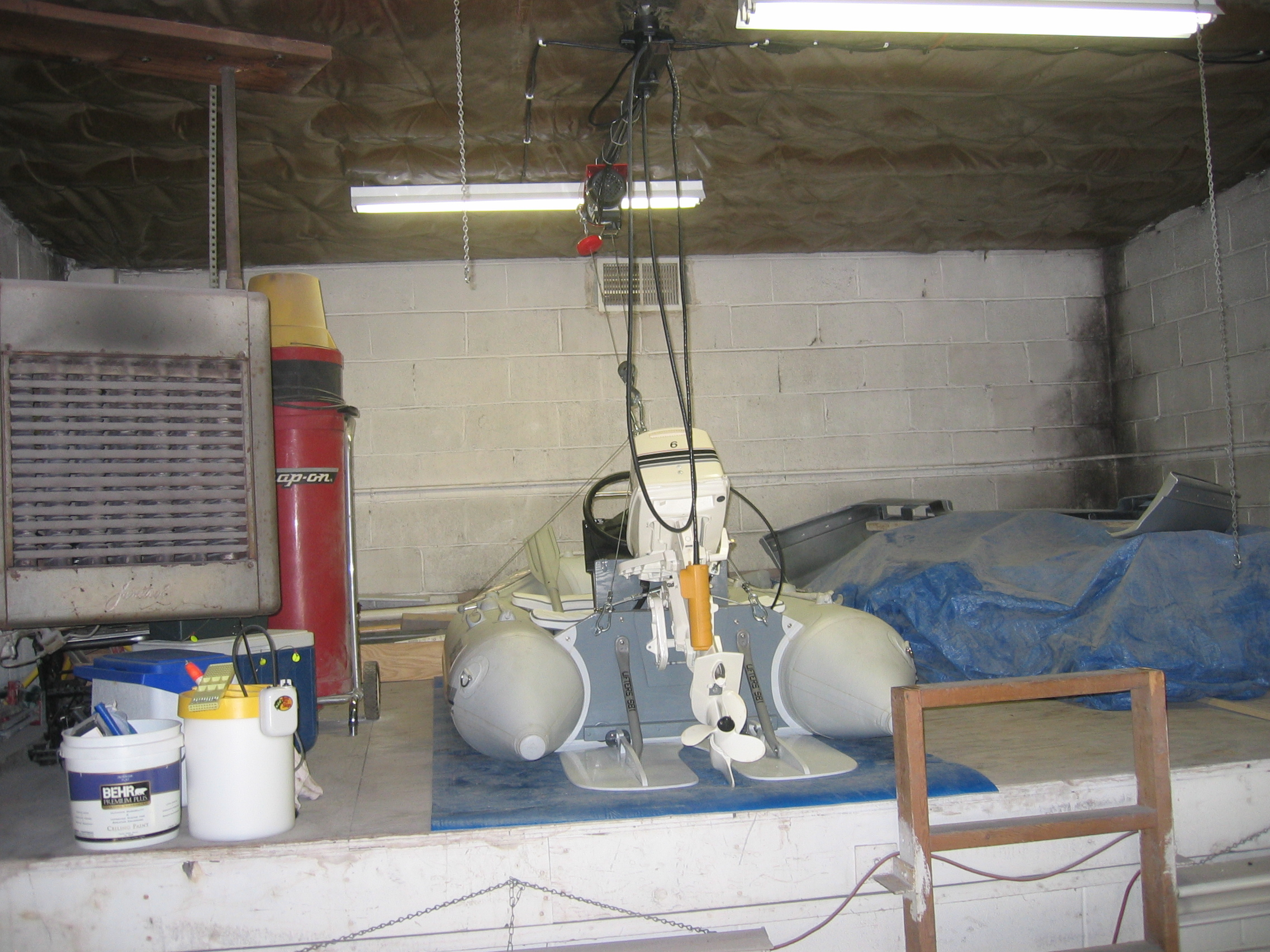

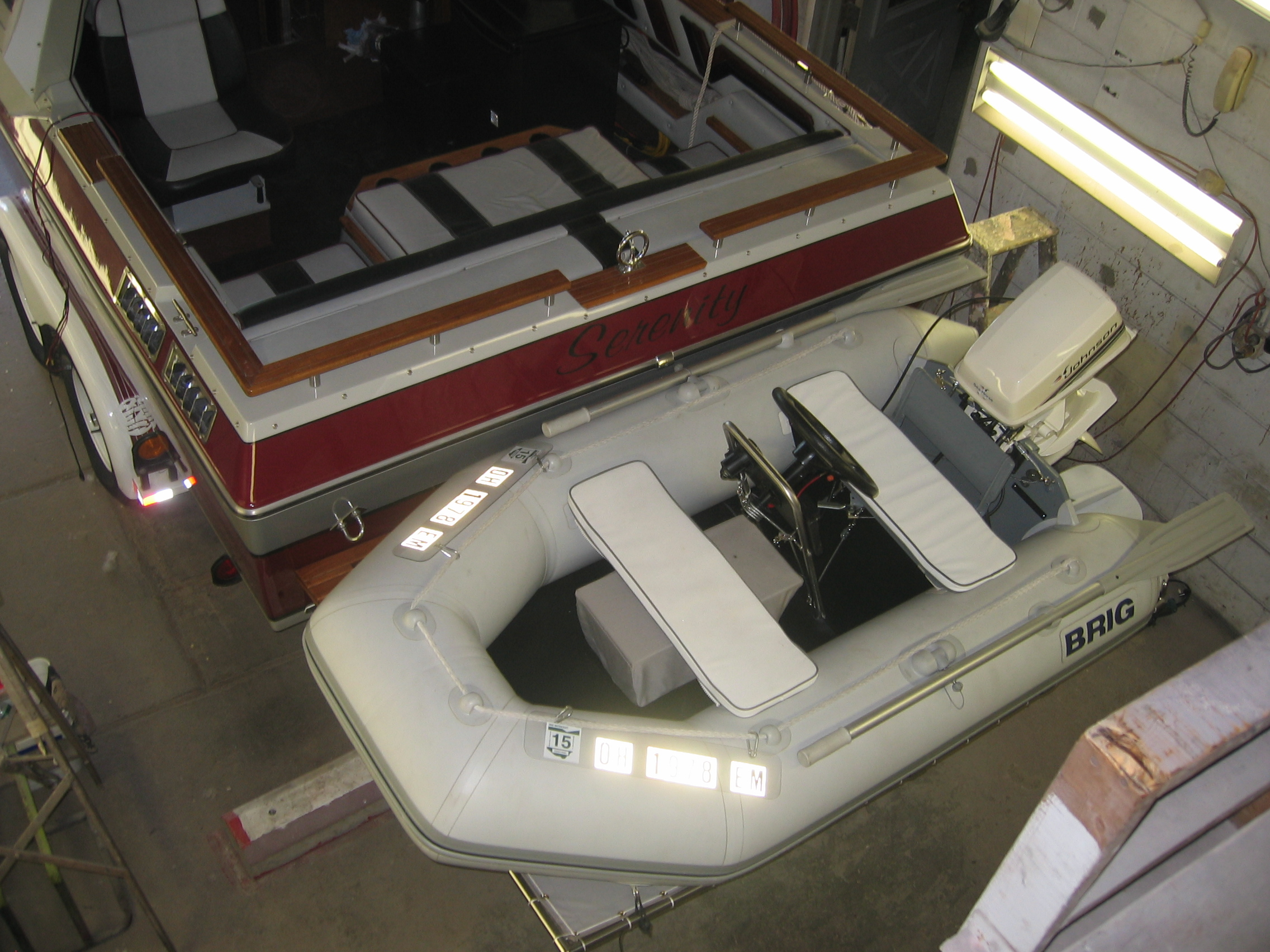

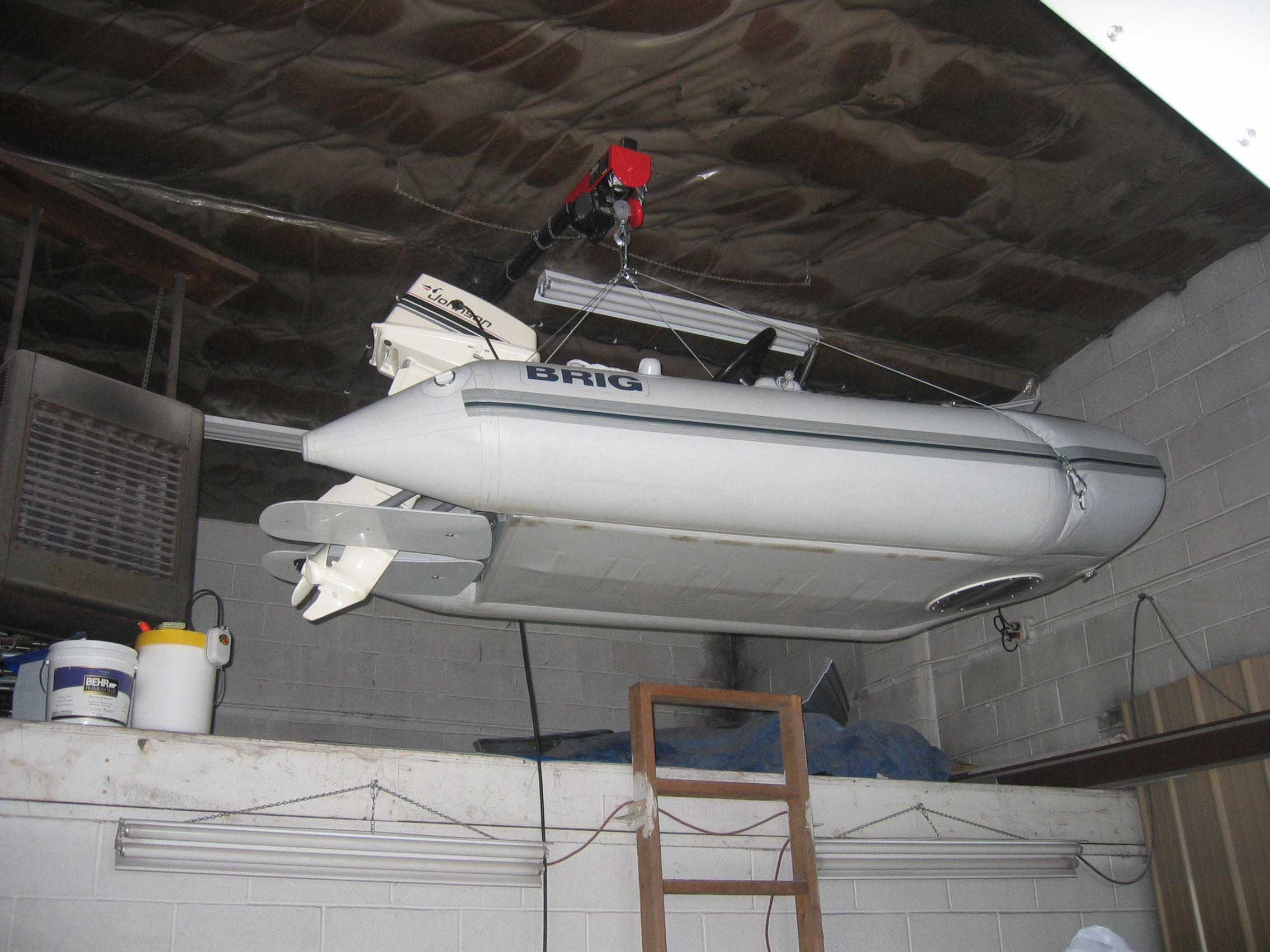

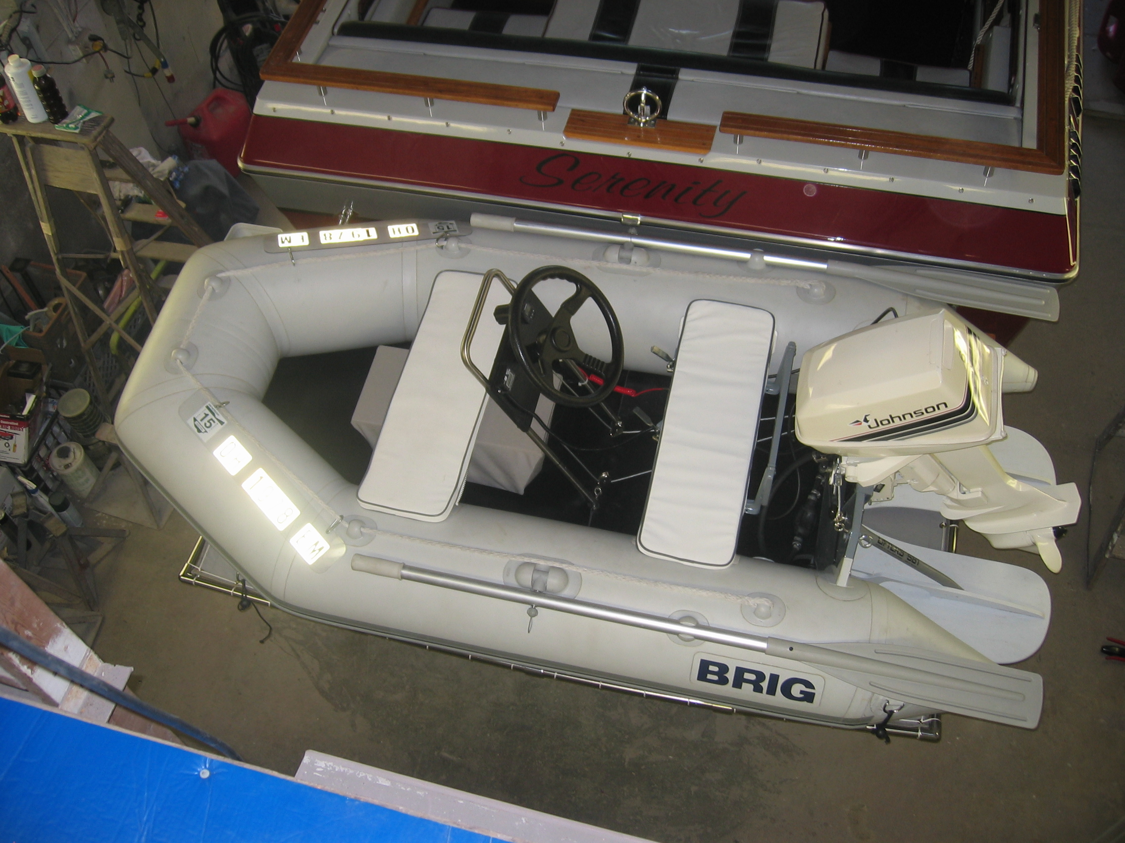

This is what my little 7'-11" inflatable originally looked like when I first got it.
It has it's own home, and this is how I get it down on to my girl.
